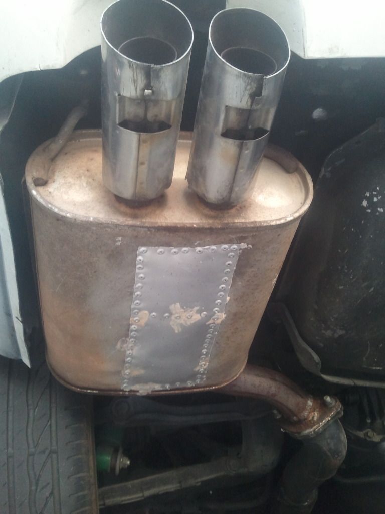

I took the silvia today. Failed on tint being too dark on the LHR quarter glass and headlights aimed too high. I went around the corner and stripped the tint off then went to find someone to re-aim my headlights. Tried a good dozen places in dickson, braddon and Mitchell and the only place that wasnt too busy to help out was jap spec garage, and they were the only ones not equipped to do it lol They helped me out though and told me how to do it in my garage so I went home and aimed them.
Took the car straight back to dickson (didn't have to rebook) and those two items were ticked off, but some time during the day a tennis-ball sized hole blew in the bottom of my muffler :( so I got failed again.
Round 3 tomorrow.
