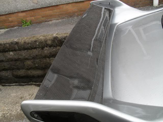

Next I got the
spoiler back from the body shop at 8.30am yesterday so after a hour or so I got
bored and started to take off the standard rear spoiler now running bareback
Plugged up the
holes left in the boot and hopefully when it stops raining I can fit the new
spoiler
the veilside
spoiler its was in bad shape when I tried to take it apart the screws were all
rounded off and seized solid so I had no option to weld on a nut carefully not
to damage to much of the fiber glass that didn’t work in the end my trusty dremel
was to save the day as I grounded the heads off the screws once it was all
apart the damage the screws caused ripped holes in to the spoiler blade I
managed to cheat for the bolt holes I used a fiber filler first drilled a 10mm
hole and took a trip to wickes and found a drywall bolt thingy witch opens up
as the bolt tightens like a rawl plug to make a very strong anchor for the
bolts this is how she stands now not to worried about it now its strong as hell
that fiber filler and the bolts work wonders again just got to flat her down
for its next stage
Side 1
Side 2
Down the blade
just finished the
rubbing down to get rid of the runs the house is now a tip lol but all the
white marks are where the runs were must of been painted by a blind person
lol

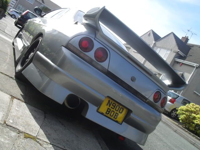

made the most of
these past few days of heat and I managed to bond and bolt the spoiler on all
that’s left is a few more days to fit the spoiler blade once its all ready
https://www.sau.com.au/forums/topic/420647-my-project/#findComment-6766202
well good news
the spoiler blade is now complete and ready to go on thanks to my mate Paul its
to fiddly for my ogre size hands lol
my original idea
of mounting this spoiler didn’t work so in the end I ended up using spring
toggle bolts but had to modify them to get it them to work my trusty bench
grinder done the trick
Here I am
drilling the holes and line every thing up
This is what she
will look like
One side all done
now for the other
Job complete

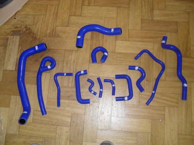

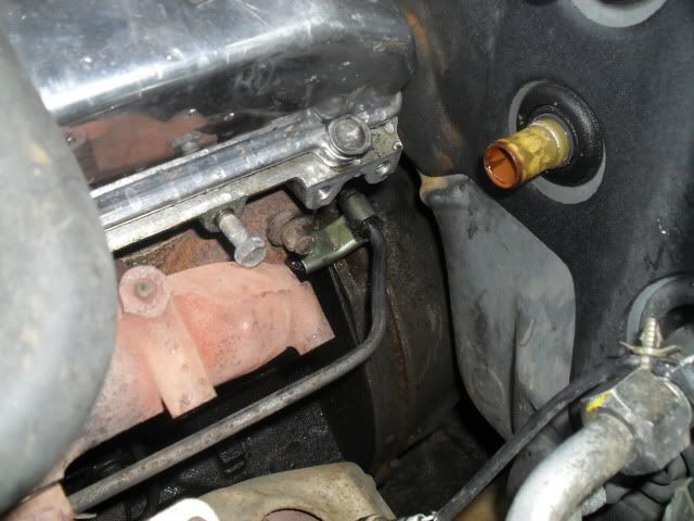

you may of seen
in another post I had a water leak found the biggest problem being the turbo
water feed pipe was split in half also I had a pin hole on one of the pipes but
stripping her down the plastic connecters cracked and were in hell of a state
really brown and yucky lol just waiting for the hoses to come from Japan had a
amazing deal for the kit over half price than a uk kit here’s a pic of the
water feed pipe there’s a hose that attaches to the end of this it cant be any
more than 4 inches long that’s all the trouble was
Got these finally
in the post nice samco hoses
Hoses fitted

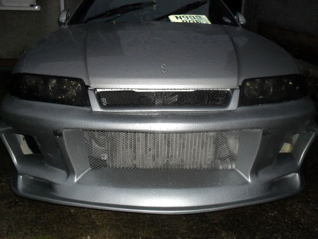

Got convinced to take a chance with it and well after a few hours looks like
its going to fit ok! All the fitment issue was the standard bumper brace bar
which I thought I would have to cut anyway. Pics as follows
All marked out
where I had to cut with my angle grinder, I was pooping myself at this point.
Also with front bumper off I noticed I have a trust greddy intercooler.
Most of it cut
out just a little tidy up
Cut out done now
weighs slightly less :)
Lost daylight but
this is what I have ended up with. All I got to do is drill holes to mount to
the wings and underneath the grill. I'm not looking forward to that :(
Best of all it
cost me £85 plus £15 postage :)
ordered a grill
from knight racer but wasn’t happy with it so got a refund with it and will

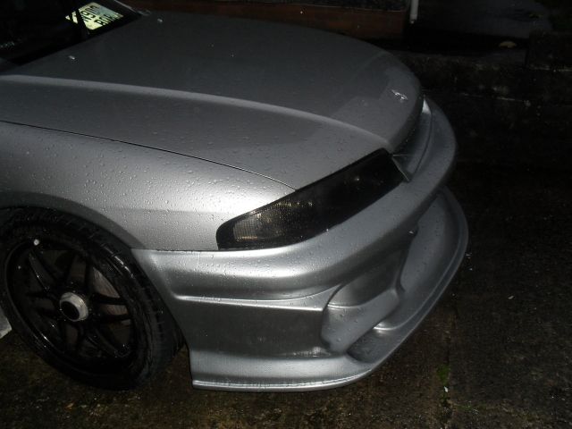

sling it in the bin never mind any how this is the bumper fitted as it stands
at the moment bare in mind it said fitment issues it does need slight
adjustment nothing major tho I couldn’t stomach drill a new bumper so custom
finishes got it on for me :) also front indicators installed smoked rover 25
wing ones :) al that’s left to do is a little bit of filler work and away for
painting :)
back from the
paint shop and omg what a difference all I got to do now grill needs adjusting
to fit also indicators are working now with a little help from a resister on
each one I think the bumper matches the style of the side skirts well what do
you all think ?

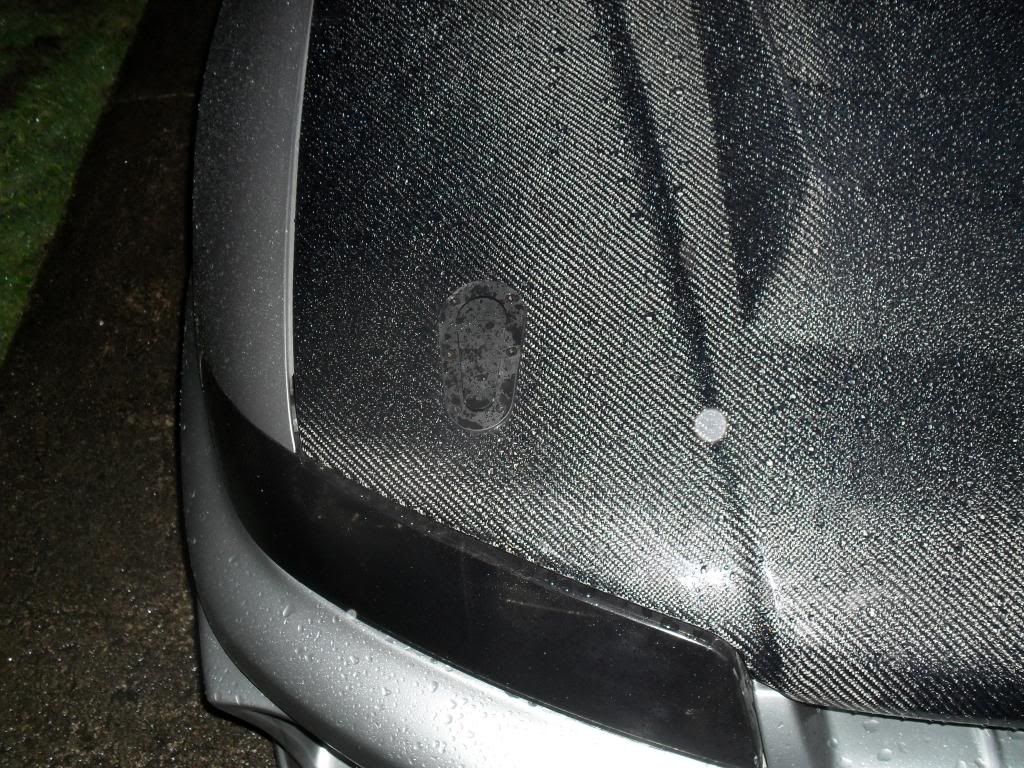

decided to treat the car for its years birthday of being with me and ordered a
carbon fiber bonnet thanks to auto extreme cant fault these guys will be
fitting in the next couple of days thanks again Wayne from auto extreme you
know how to make a man happy :)
Here are the pics
Whets in the box?
Side open
Bubble wrap off
Out she comes
Close up
Am I happy?
took 2 of us 20
mins to get old bonnet off and new bonnet on and fitting nicely was going to do
the catches but started raining again so I decided to leave it for another day
pics as follows slandered bonnet is

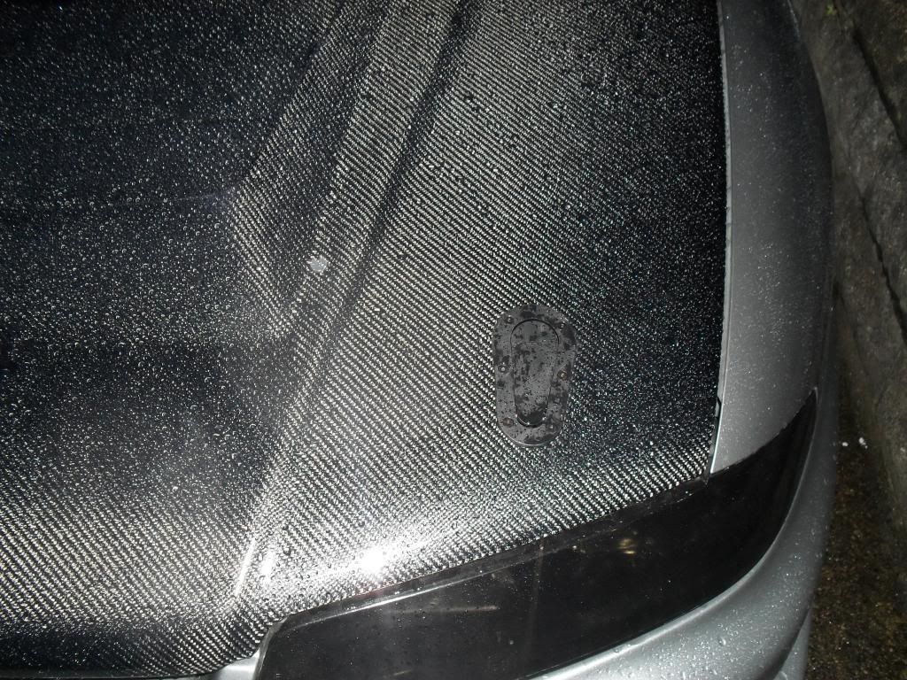

really heavy new one is so light its unreal so all that’s lest to do is fit
aerocatches and fit washer jets job done then fitted no problem at all and
better still makes the grill look perfect so its staying :)
Decided today
that I had enough balls to start fitting the aerocatches god I hated cutting a
carbon bonnet
I must of aged 20
years doing this lol
Nothing major
really first side cut out now lost light so tomorrow will do the other side and
bolt the catches up :)
other side done
and all fitted I ended up reinforcing catches using a high strength bold sealer
same stuff that’s holding my spoiler base to the boot so mega strong :) sorry for the crappy night pics :) will get
