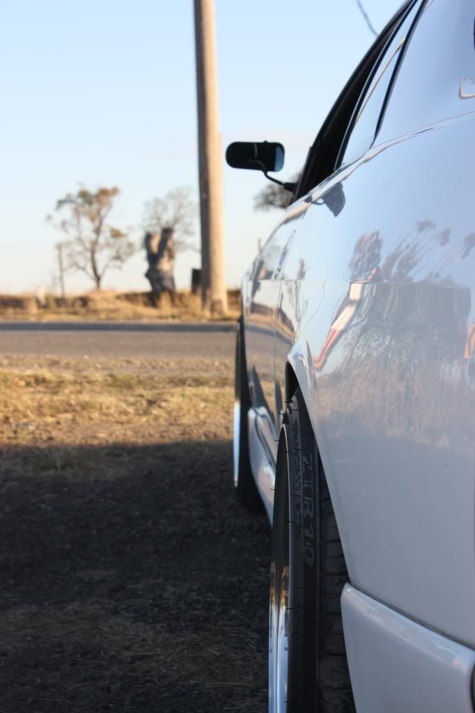

10"-12 is a lot of poke :/ GTST below
17 x 8 + 5 front 205 tyre
17 x 10 + 5 rear 235 tyre
That has pumped and flared rear guards it would stick out a lot more on regular guards
