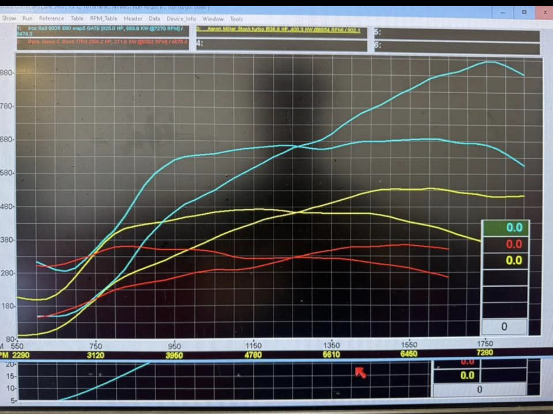

22 minutes ago, Lithium said:
Interesting (but I suppose not massively surprising) the dyno plot doesn't put this car across as THAT much better down low than it was with the -5s, the old "transient response" beast back with a vengeance.  I guess you'll have to take my (and every other person who has been in or driven it) word that the car is a completely different beast now, feels WAY more alive basically everywhere.   Holds power better, "wakes up" faster under foot.  It's generally a significantly faster and better car to drive, beyond what the plot shows.
This is what I was getting to with regards to the whole N/A V8 thing. A dyno shows the result as much worse, but in terms of how 'alive' the car feels afterwards, it's night and day, better in every way, there's no copium, I prefer my 280kw setup over my 430kw setup.
This was me doing predictions before I did the swap, I make about ~10kw more everywhere than the blue line, but chalk and cheese in terms of liveliness. I understand what Lithium is trying to say with his dyno graphs that look mostly the same in his case, but one is vastly superior in the real world. The blue line looks laughably bad on the dyno graph in my case, which really highlights the point.
People absolutely, absolutely, completely underrate how important transient response is to how much fun a car is, how it feels, and how much you can trust a car, which means you can drive the thing faster, and if you are going faster and using 70% of the throttle, and trusting, and pushing, it's a far more fun, complete, and faster experience than feeling like you can't go beyond 50% of your throttle use but damn your dyno plot looks great.
  • Like 5

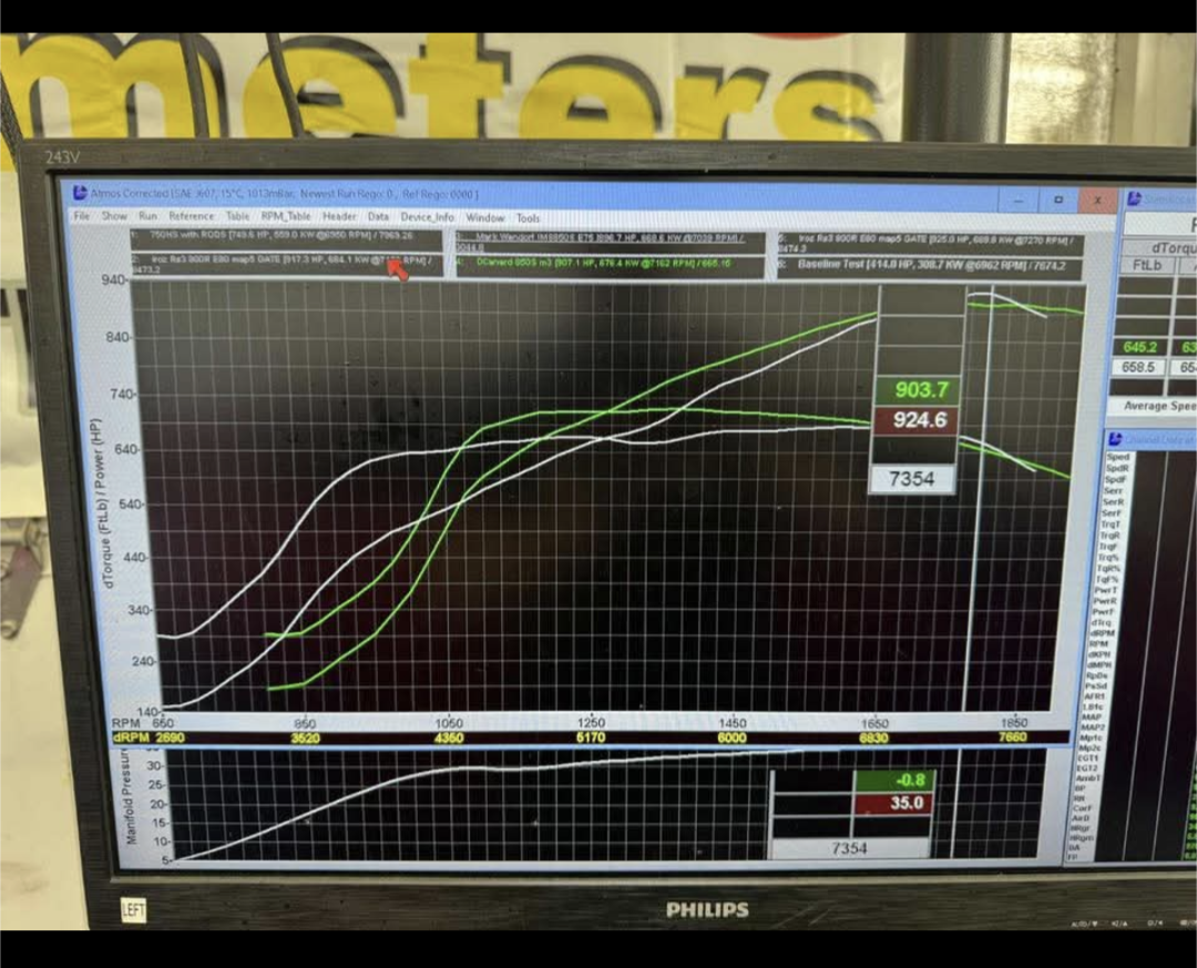

On 4/3/2021 at 1:22 PM, LaurelPWR said:
I would say I’m sorry for reviving an old thread, but I’m not, so I won’t.

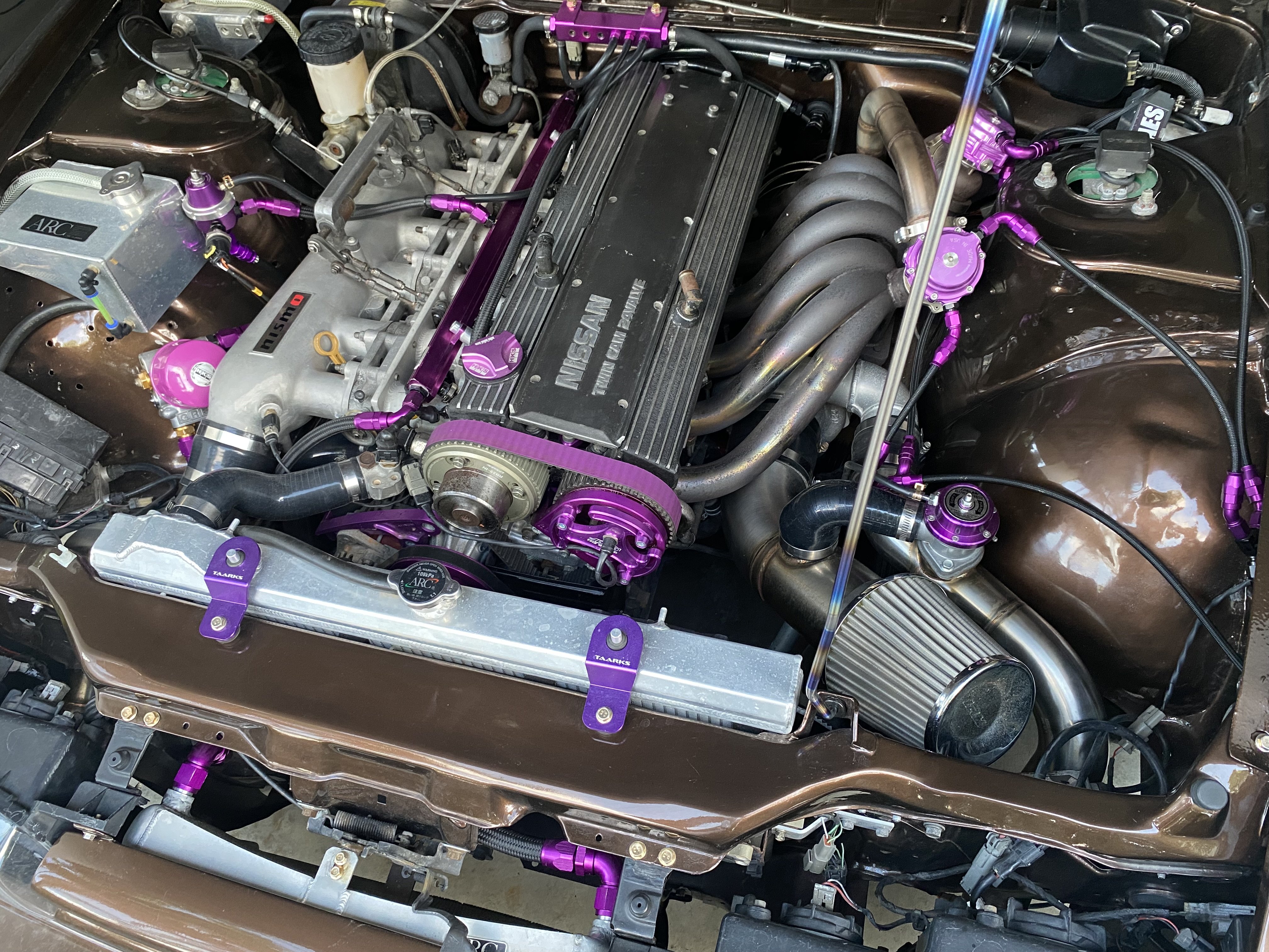

......soooooo.......after literally 5 years of planning and slowly gathering parts, I finally got my HTA3076 1.01ar twin scroll setup on the rollers for the first time.
S13, rb25 s1, forged Ross pistons, acl bearings, Oem crank and rods, Oem oil pump, Cometic 1.1 head gasket, standard head with hks 256 8.8 in / 264 9.1 ex cams and performance springs kit, RB26 itbs oversized to 49mm and a cnc port matched Rb26 nismo plenum all mounted using a RIPS RB25 neo cut&shut adapter also port matched, Bosch 1650cc injectors on a custom mounted genuine HKS fuel rail, genuine R31house version 2 twin scroll manifold with individual egt’s on each runner, hta3076 genuine garrett 1.01ar twin scroll rear housing, 4” stainless exhaust from turbo back with 4” AES butterfly valve off the dump and AES 4” muffler, all stainless piping and intake with true 4” HPI stainless mesh pod, HKS TypeR 103mm thick S13 intercooler, genuine ARC r32 gtr grille oil cooler/washer-oil catch/rad swirl pot/reservoir,  blitz radiator & 2x 14” ultra slim maradyne puller fans, ross balencer, PRP trigger kit, PRP r35 coil kit + splitfire r35 coils, ARD alternator and PRP bracket, hks ex cam gear, Greddy intake rb25 VCT cam gear, greddy type R bov custom anodised PRP purple, hks timing belt, link Fury G4+ ecu and 12volt performance custom wiring, AIM link colour dash, 4 bar map sensor, Turbosmart fpr, 1x walbro 255 lift/2x walbro 460 in tank, Taarks v3 surge tank, all lines replaced and upgraded for everything, tial 38mm MVS external gates both with screamers etc. etc.
Graph is only on gate pressure with 20spi springs, the exhaust 4” butterfly is closed and there is zero boost control turned on.
It will be returned to the Dyno once wideband is sorted properly in the dump, then it will get 30psi and an open 4” butterfly. It’s already quite responsive with 300whp & 20psi at 3500rpm. This Dyno is a renowned heart breaker so I’m pretty happy so far with the resultant response.
Dredgggggeeee time;

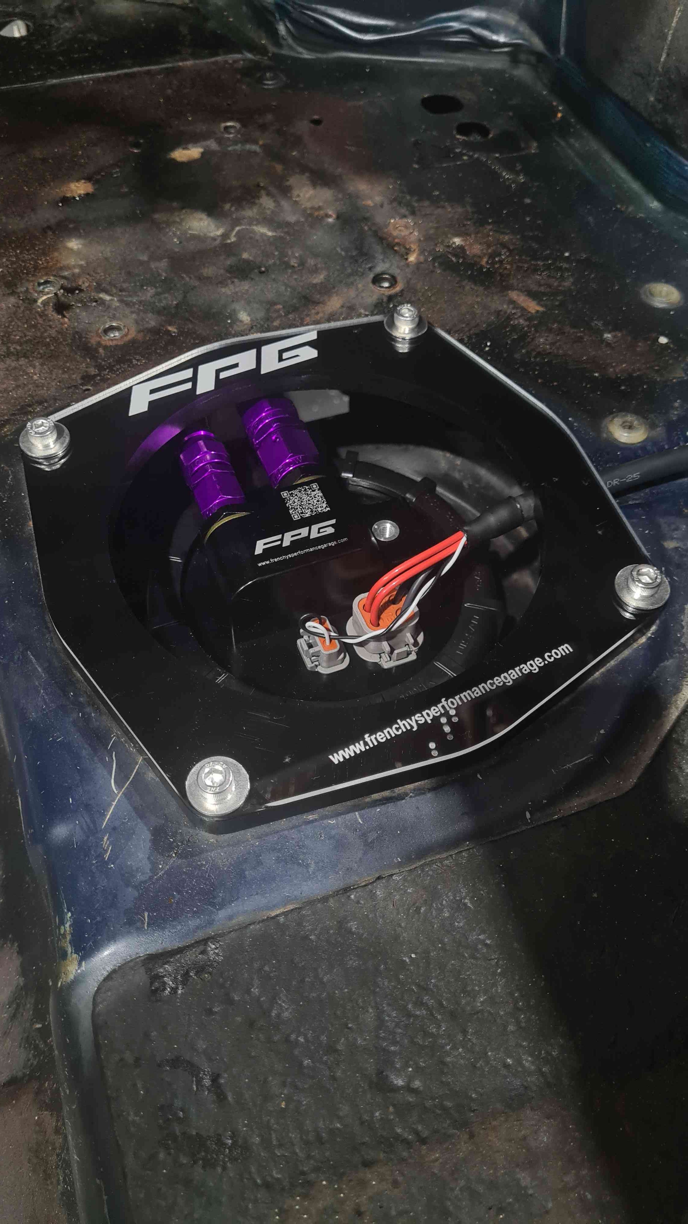

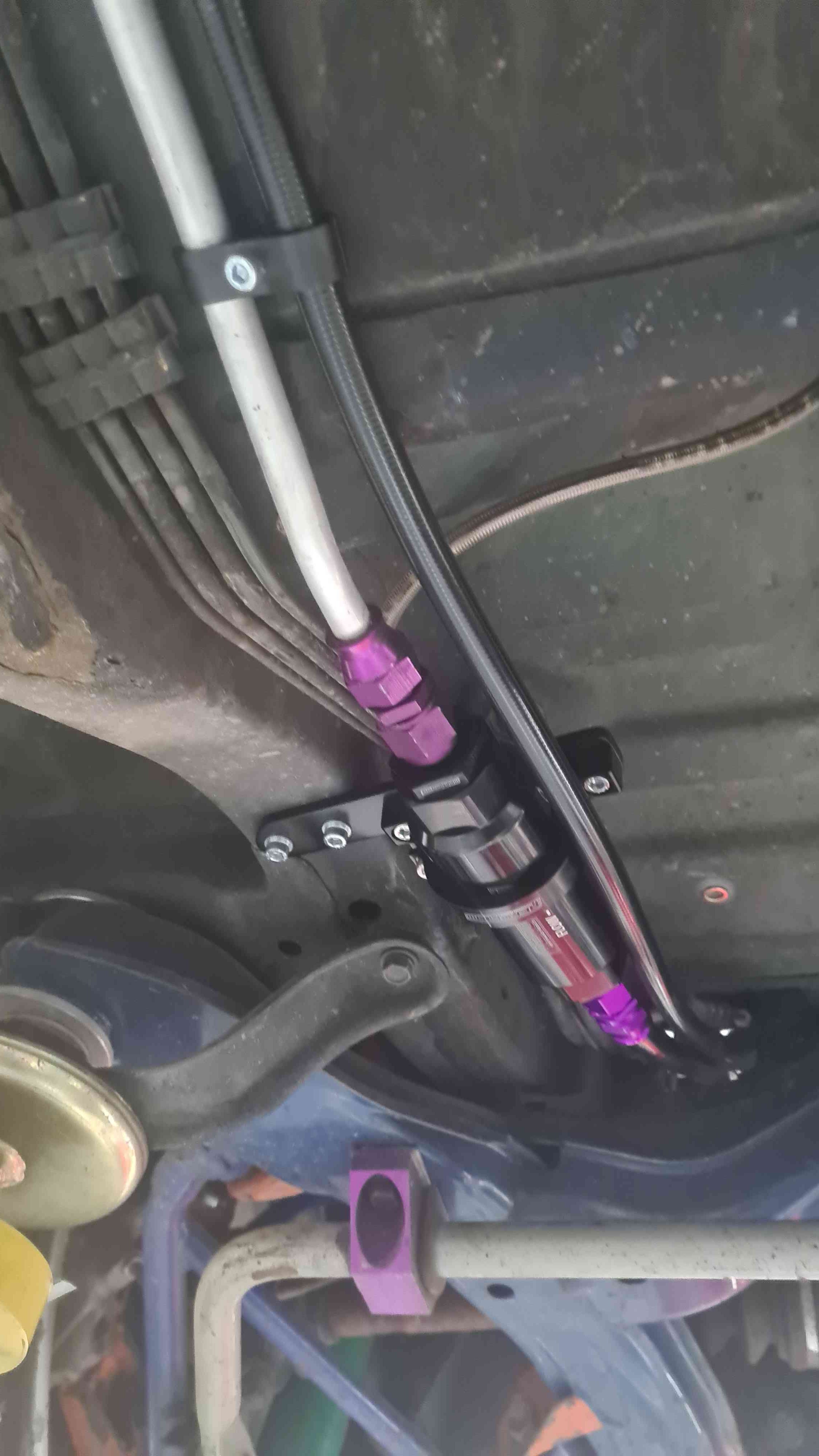

I have recently finally started driving the car. It sat for so long that the fuel tank gave birth to rust sludge and blocked my lift pump sock and one of my walbro 460's and left grime, rust chunks and muck all through the surge tank and system.
I decided to commit and pull the trigger on an oem r32 gtr fuel tank and Frenchys twin 460 / sender / surge tank hanger combo and all new larger lines and fittings etc, also boost doc heater hose kit / new heater core and a heap of other bits and shits like wideband sensor installed in the dump and Syltech iacv + lines and all wired and added to current tune.
now having lightly driven it a couple times without issue, I can happily report on the hta3076 in its current tune.
still no boost control switched on, 20psi gate springs, car makes 22psi at 3200rpm in 6th gear with 30-50% TPS from cruise at 100kmh. Going by the old graph, this means it should be making 300-325whp at the same numbers above. Very very responsive setup under true road driving loads.
all that's left for the build is body loom + PDM, finish the remote aircon setup, install carbon fibre parts and go for full tune and 30psi.
the 315 rear tyres are now performing like they're 195's, wheel spin in any gear at almost any rpm, whereas my previous setup hooked up in 3rd no issue, albeit Nt01's back then / RB25 5spd vs (new) old date r888r's Z34 6spd now, + obviously all the support upgrades I listed in the quoted post above.
car sits at 1-3psi on cruise at 100kmh, expectations totally exceeded and I'm beyond stoked with all this so far.
Edited by LaurelPWR
  • Like 2

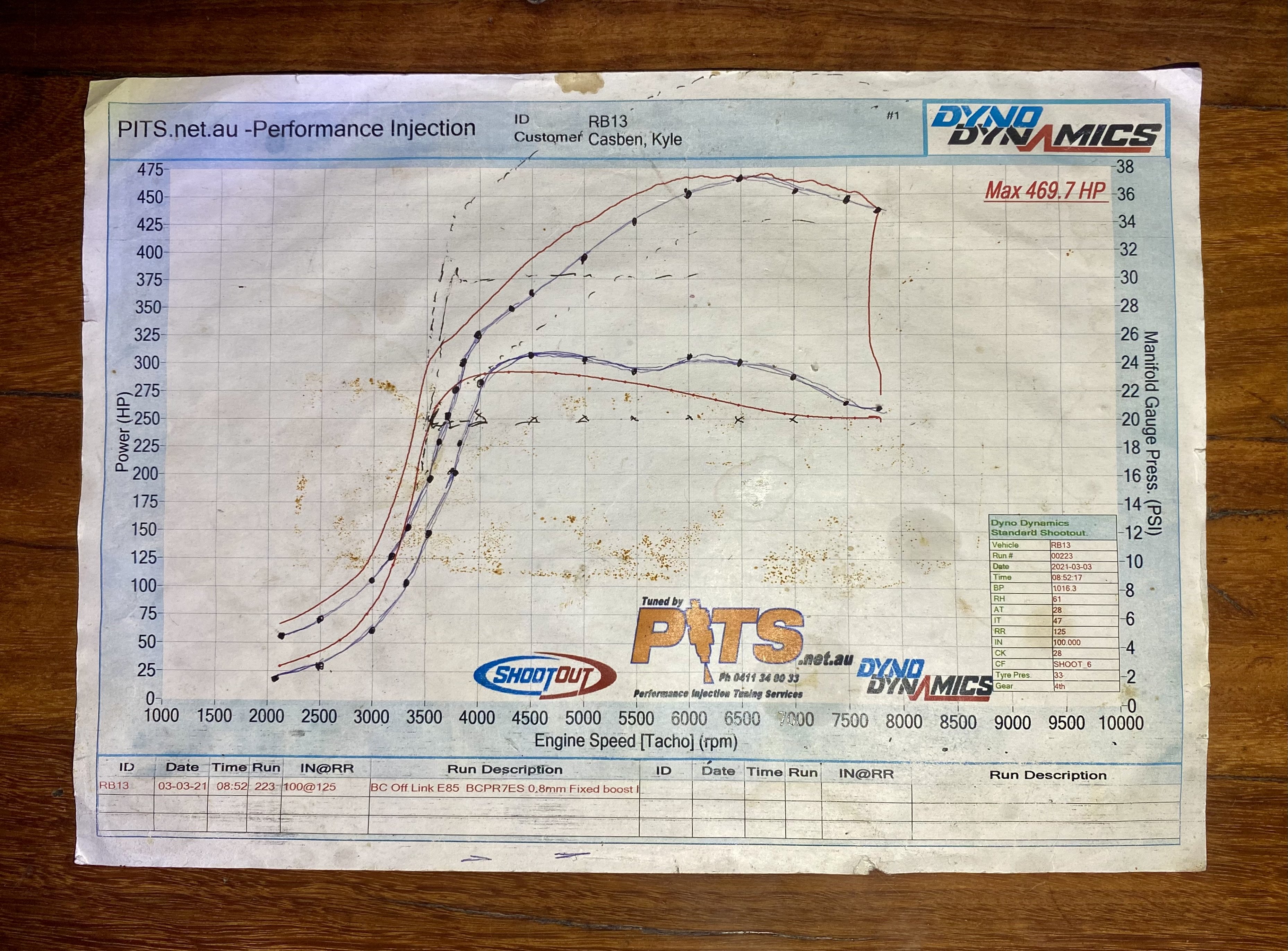

For anyone interested, this is my old graph from 2021, but I've plotted the previous setup curve onto it with a black pen.
old setup was:
pon cams, oem itbs and plenum, HPI manifold, hks 2835 pro S .87ar rear, Turbosmart actuator, 3" turbo back no res. or cat., greddy spec M fmic, nismo 740cc inj, walbro in tank 460, splitfires, 4" intake pipe, Apexi pod, e85, eboost2, power Fc.
I love that the new setup has much larger turbo spec with the HTA3076 1.01ar Ts rear, and literally everything is bigger, but far higher quality and result is it's FAR more responsive in paper.
  • Like 2
