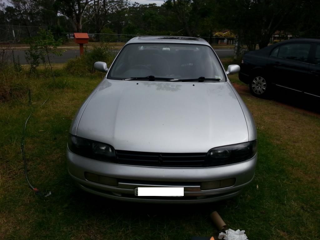

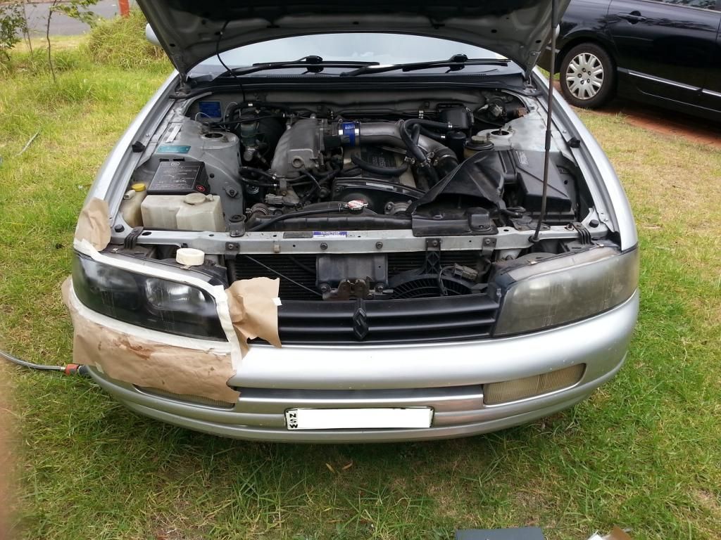

I used this one. Took me about an hour to do two cars in total and still plenty in the UV Protectant tin for another application to both.
