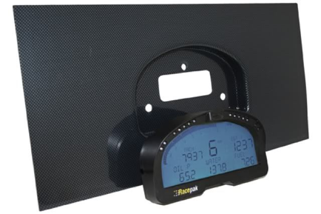

Who made that dash? It's awesome!
Cheers, mostly me.
you buy the plate like this,
And then trim it to suit, cover in 3M Dycon, and mount some lights with computer cut labels.....sorted!
