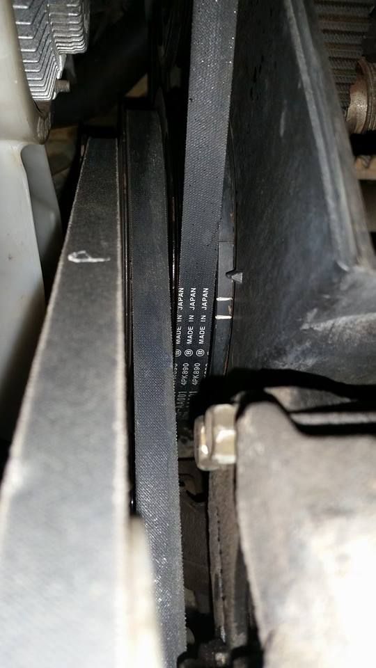

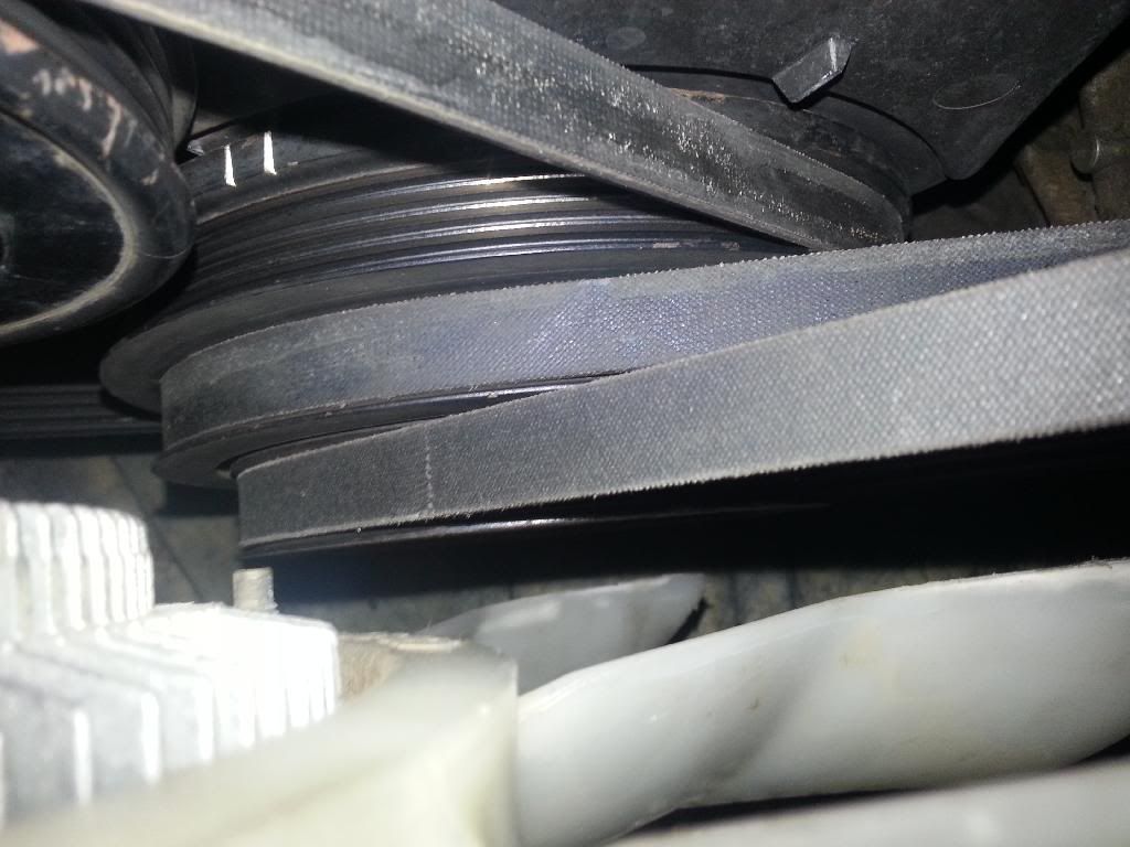

Ok, after leaving it like this for awhile I decided to recheck it getting the car ready for a tune. I've set the motor at TDC according to the markings on the cam gears and this is the result.
Can anyone give me an answer as to what these marks are? My guess is 10 and 20 deg, it would be helpful if someone knew the diametre of the pulley.
10531326_10204465063769649_1844157181_n_
Edited by owen1r
There is another mark on the pulley, just above the pointer on the timing case. I'm guessing that that should be TDC. If that's the case, then the engine is slightly out of wack between the crank and the cams.
In any case, the 2 white marks would probably be 15 and 20 BTDC - you really only need 15.
  • Like 1
I'll get a piston stopper and try and find TDC more accurately, the screwdriver down the hole method just isn't accurate enough. For now I have set it to the first white mark, just to be cautious.
Edited by owen1r
