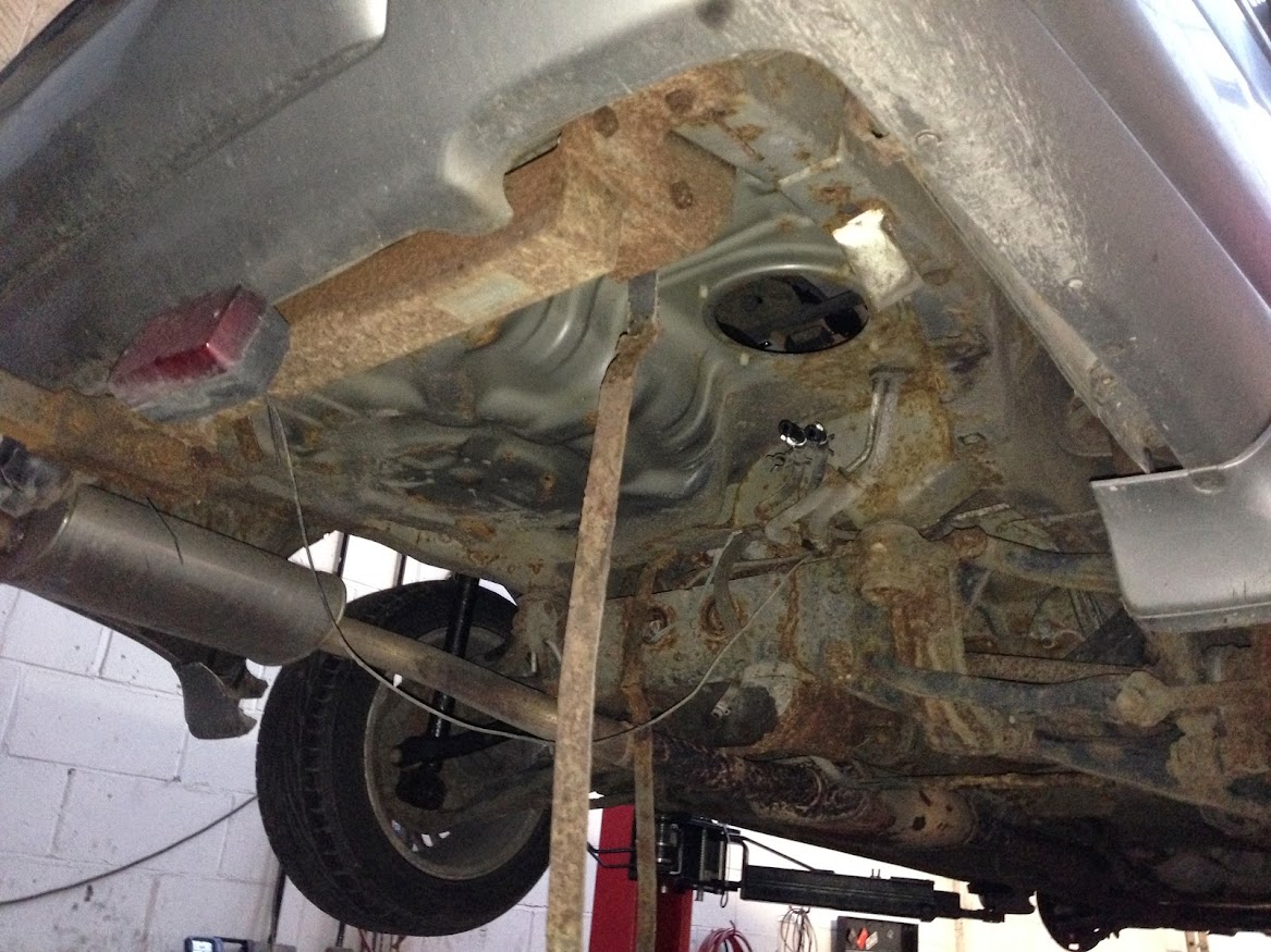

Underside with fuel tank removed. A fair bit of surface rust.

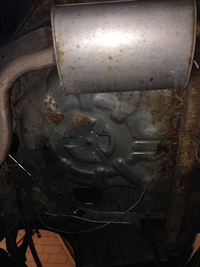

Centre silencer outer casing falling apart. No leaks though.
Rear box looks like it was changed at some point with a better quality metal.
Puny exhaust!
Underside again

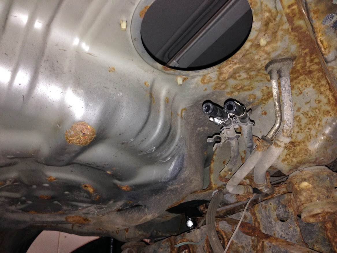

You can just about see the corroded fuel lines

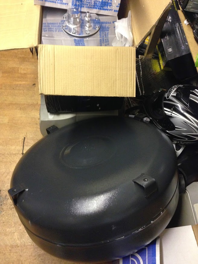

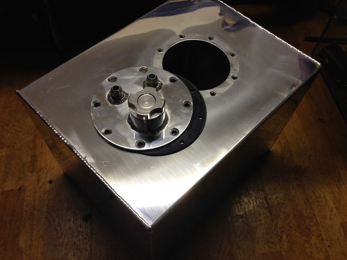

The top will be plumbed with flex hose to the original filling point. A replacement external fuel pump (rated at 300 lph) will be fitted to pull fuel from the line at the bottom. The two lines at the top will be for the return and the breather. I'll be drilling out a 40mm hole to mount a standalone fuel level sender. The issue I have there is, I understand the Stagea runs on 0-90 ohms resistance on the fuel level sender. I've not been able to locate a replacement which runs the same resistances so the one I have is now 3-150 ohms. Basically I think I will end up showing 'F' on the gauge until I am halfway through the fuel tank (32 litres capacity) and then drop to near enough empty when the fuel warning light comes on. I can live with that as I aim to be running LPG for 99% of the time. The petrol will only be for start-up and emergency use in case I cant fill up LPG in time.
Fuel tank in the box and LPG tank (85 litre capacity)
