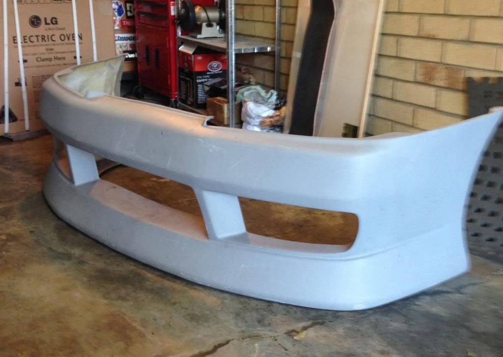

Also trying to fix up the front bar I also bought from Gumtree.
It was in good condition but just had a couple of holes and damage on the drivers side mounting point. I bought a fibreglass repair kit from bunnings and am attempting to fix it all myself. Will get it resprayed with my rear bar hopefully next week.
I think this front bar will match the rest of the kit so much better that what is on it now. The current one has way to many vents and looks a little too boy racer for me. This one reminds me of the A-BO-MOON R32s which I love!!

Was in the garage a whole lot longer than I expected, front bar just never fitted up properly so needed a bit of modification. All fitted up now and I am a little unsure of what I think?
Still needs paint I guess? Once it matches the rest of the car I might like it?? Who knows..
