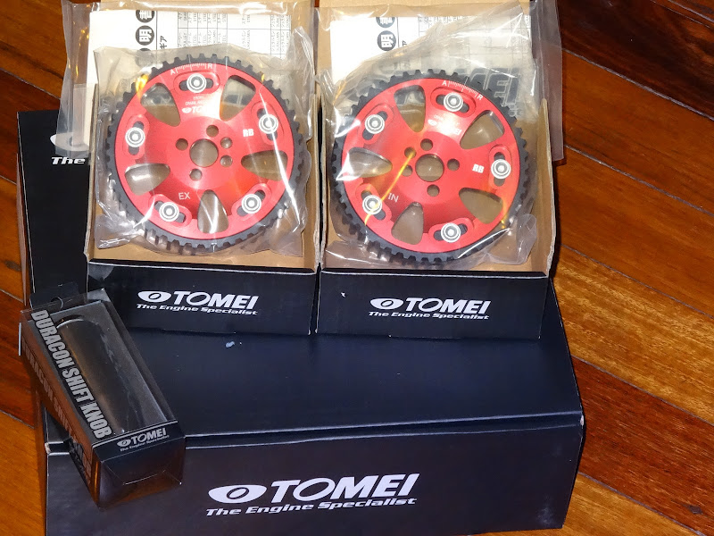

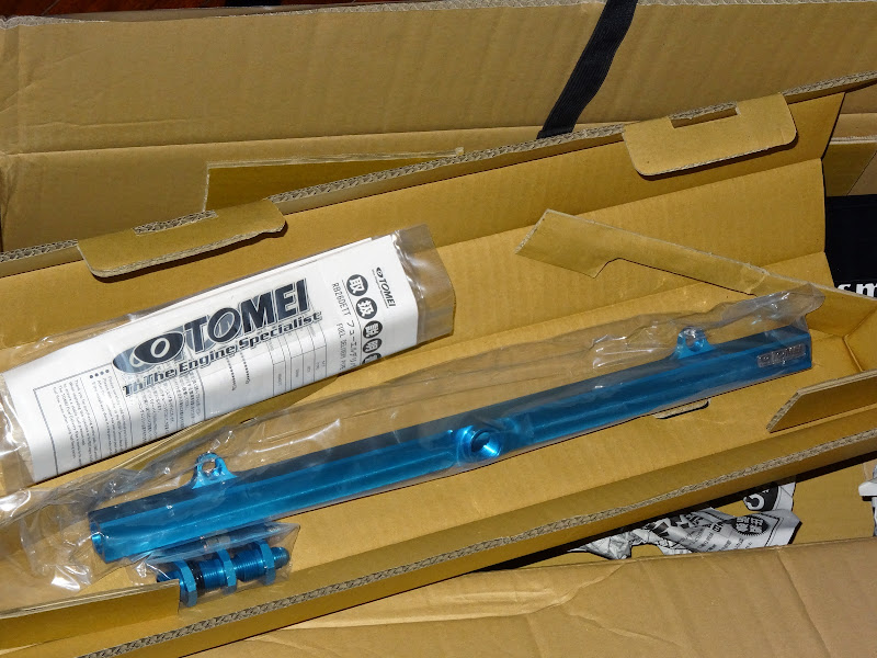

Few Tomei bits n pieces now in the house :yes:

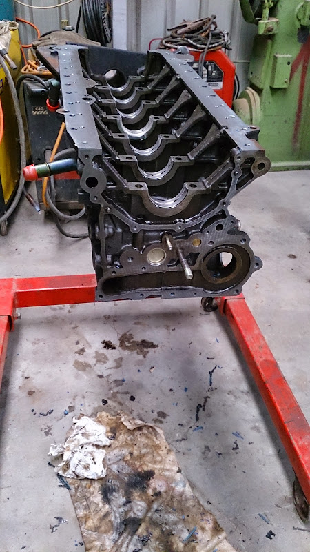

N1 block

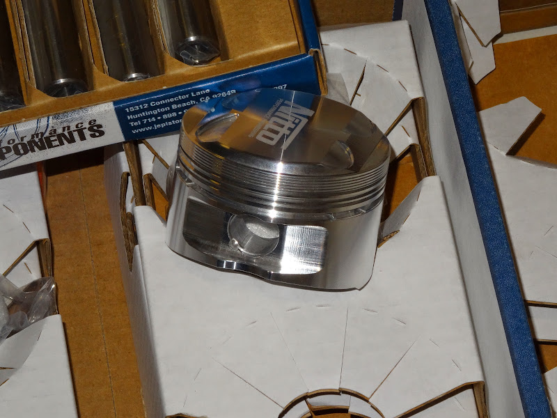

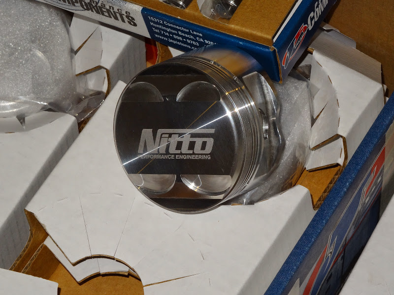

Nitto pistons

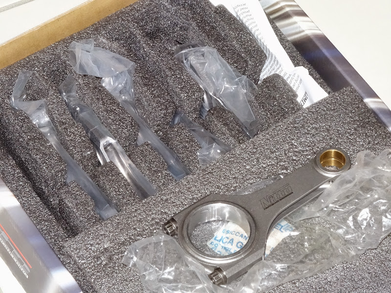

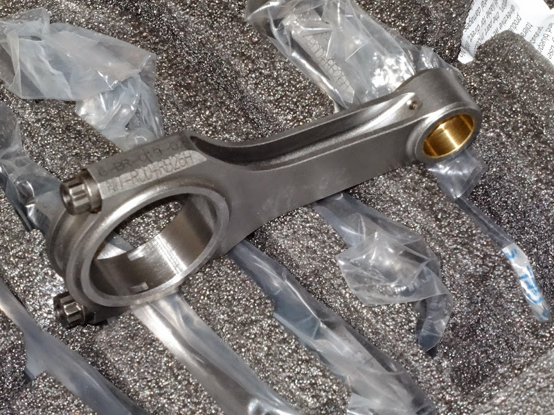

Nitto H beam rods

Looks like we will be going to a new N1 block...hopefully get that ordered tomorrow but will be a 3 week wait from you know where

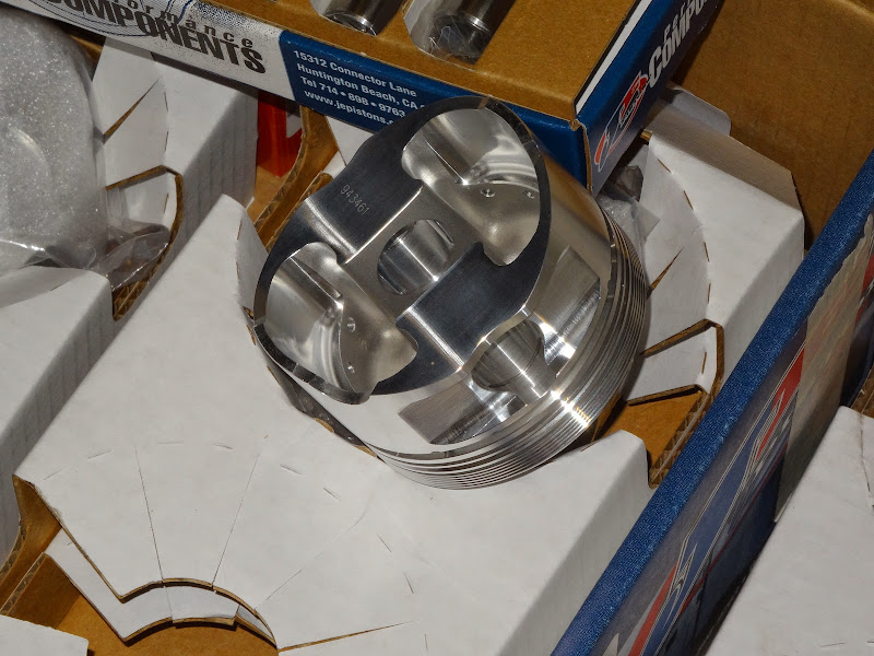

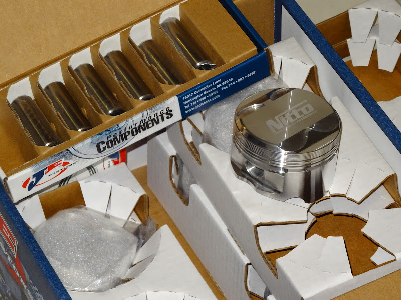

Looking good mate keep it flowing. Id be sticking with 86mm pistons so you have meat in the block left to go upto a 86.5 and then 87mm piston if the motor is damaged. The benfit will be the block will have been heat cycled many times by then and alot stronger than boring a new n1 block straight up. Really shouldnt have too many issues either way. Also you wont have any maching headaches and expenses if you can find 86mm forged pistons, i havent really looked into it. I think the standard oem pistons arent probably a bad thing with the cooling channel.

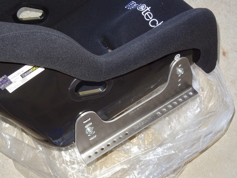

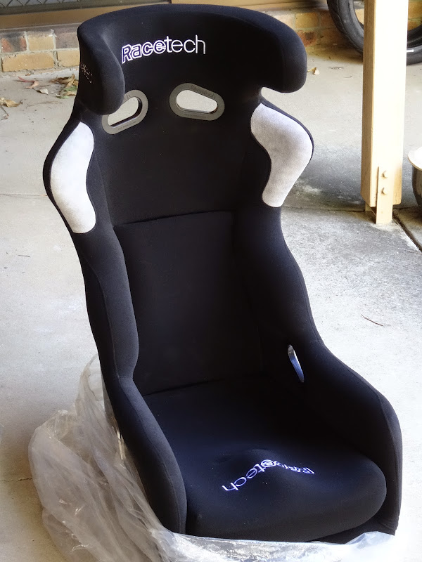

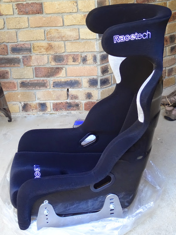

How much was the seat and rails and who did you order it through, a very nice bit of kit there! The willans harness will go nicely with it
Also nice looking tomei baffle, although i prefer the nismo one the tomei will obviously do the job. Who is doing the rest of the work on the sump for you and and what cost. Are you planning to run the drain/vent to the head or just running one vent from the sump straight to a catch can?

Cheers Mick. Yeh mate spot on. It's looking like Arias 86mm pistons will be the go and going to run them with Nitto H beam rods
I purchased the seat and harness off here! Cost me $900 including the harness. It was a local purchase as well so no cost for freight! I believe Rocket Industries carry them but...
Yeah I can't justify the Nismo price tag for the baffle...we modify the Tomei one to suit the new winged/extended sump as well and it's easier to do so with a Tomei one

Ok it's done
Nitto H beam rods
Nitto 86.5 pistons
Nissan N1 block
ALL BRAND NEW!! :D:D:D

So I now have a used N1 block for sale ready for sleeving if anyone is interested
  • Like 1
how much for the N1 block? out of curiosity lol
$2,440 inc GST

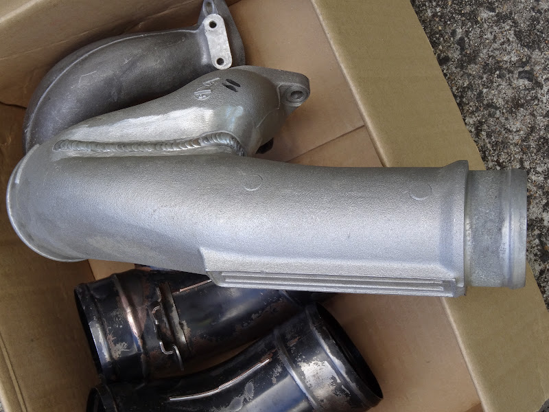

who welded your intake pipe?
Hey mate, just a local guy here in Bris...think he does a few of them
Forge Performance in Mount Baker, SA are doing them for $100 pretty sure
yeah im onto Josh for mine.

Looking good robbie, was the block from justjap?
Cheers Mick, no mate just direct through Nissan as it was cheapest (trade price). Just have to wait a couple weeks for it as ex Japan

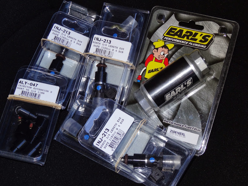

couple more random bits
