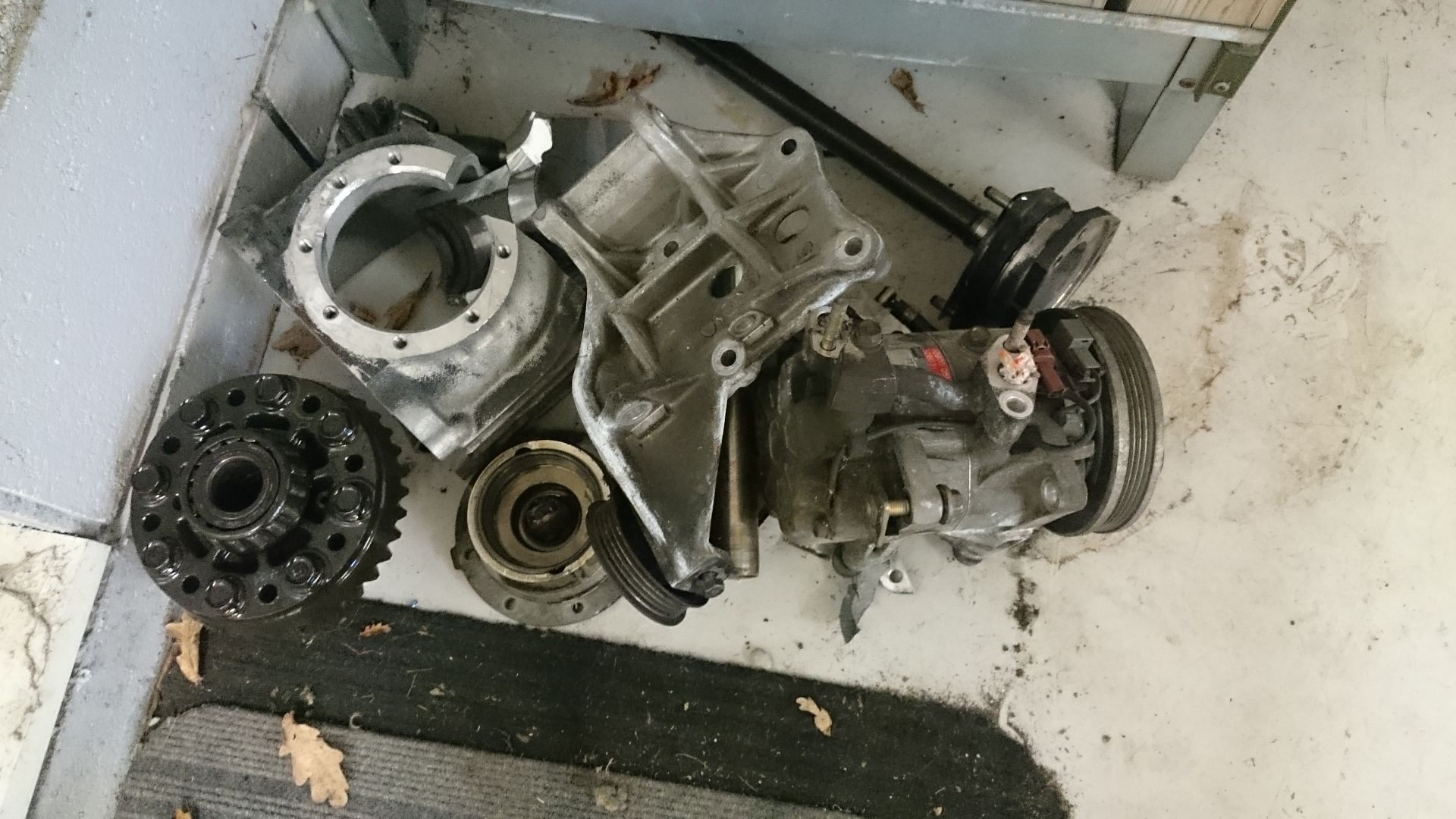

Removed the diff and the AC pump

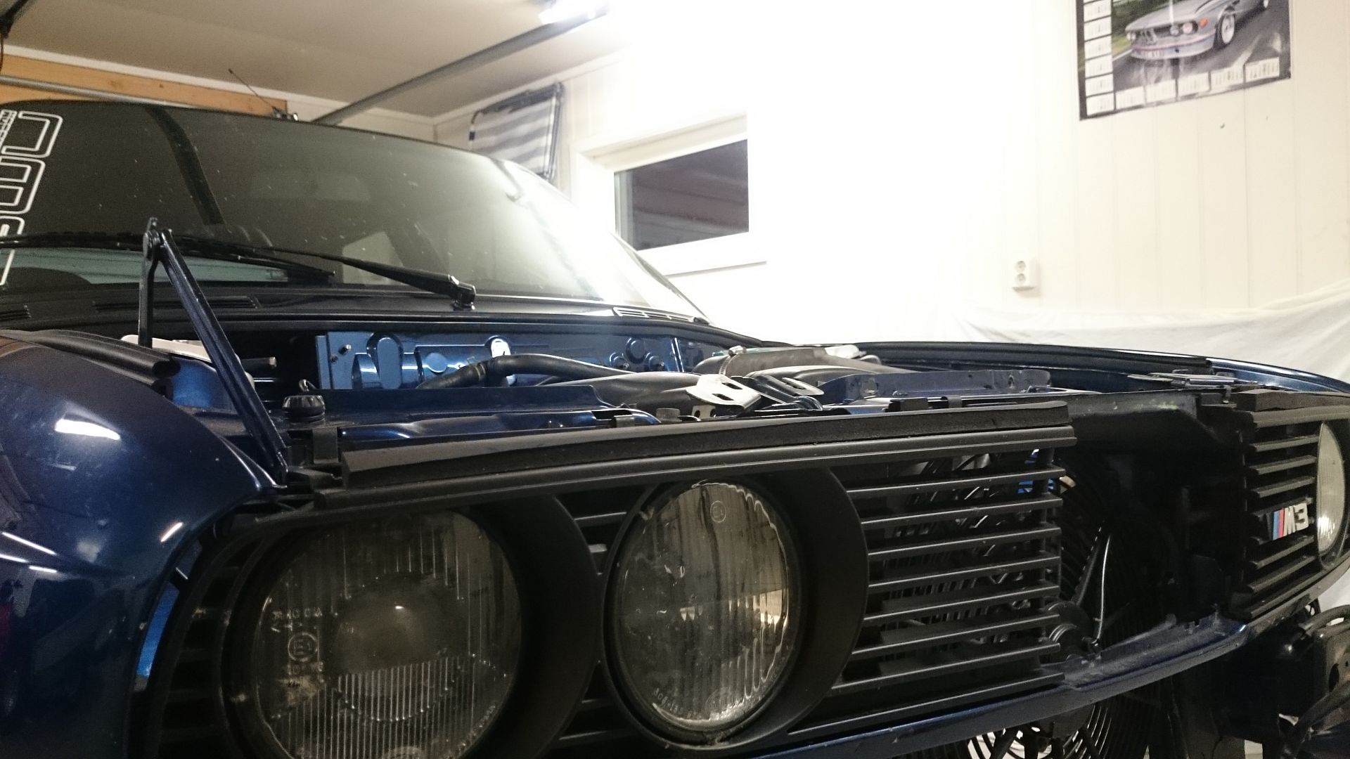

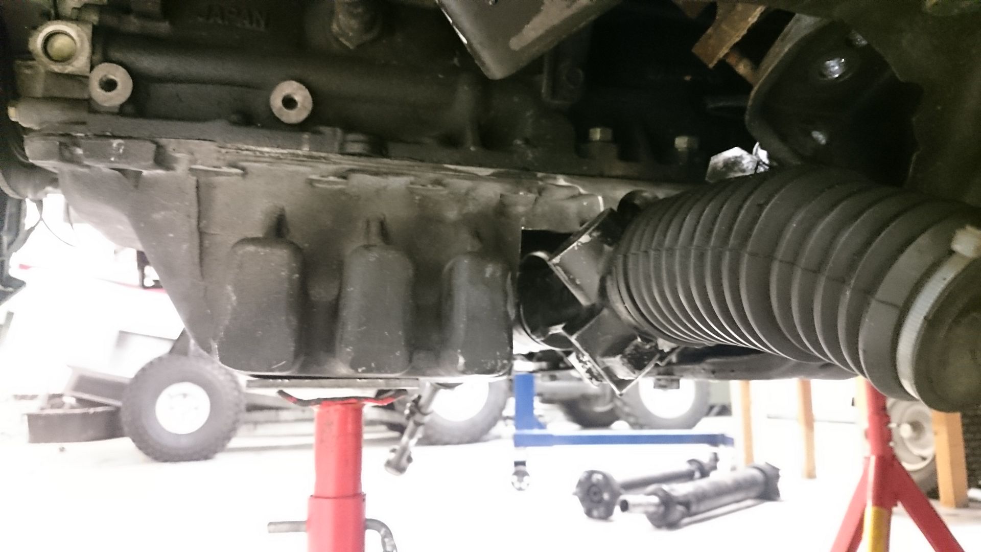

This is pretty much how the engine will sit
In order to get the engine as far back as possible, I had to cut some of the oilpan.

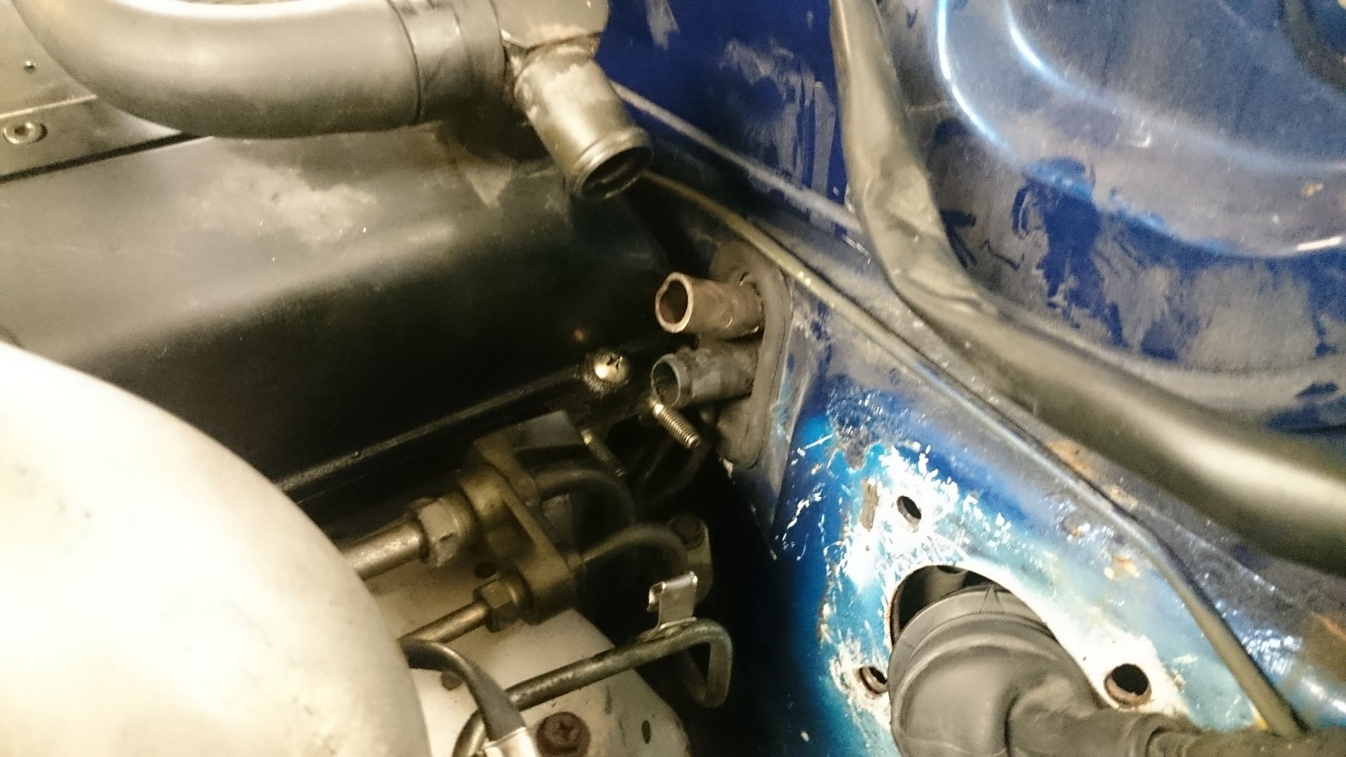

Need to modify a bit here around the heater pipes. Hope I can cut some out of the rockercover to make more room.

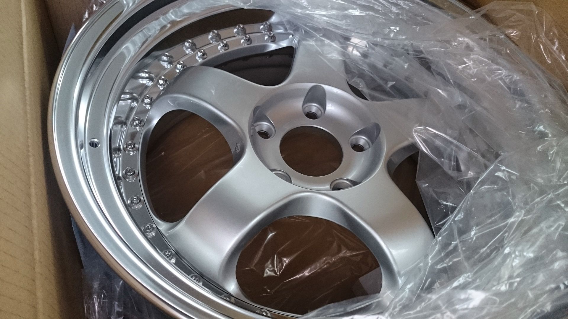

I have ordered a set of these wheels, they are ETA in Norway in the start of December. Should make a nice chrismas present for myself, even though I payed them in July!
