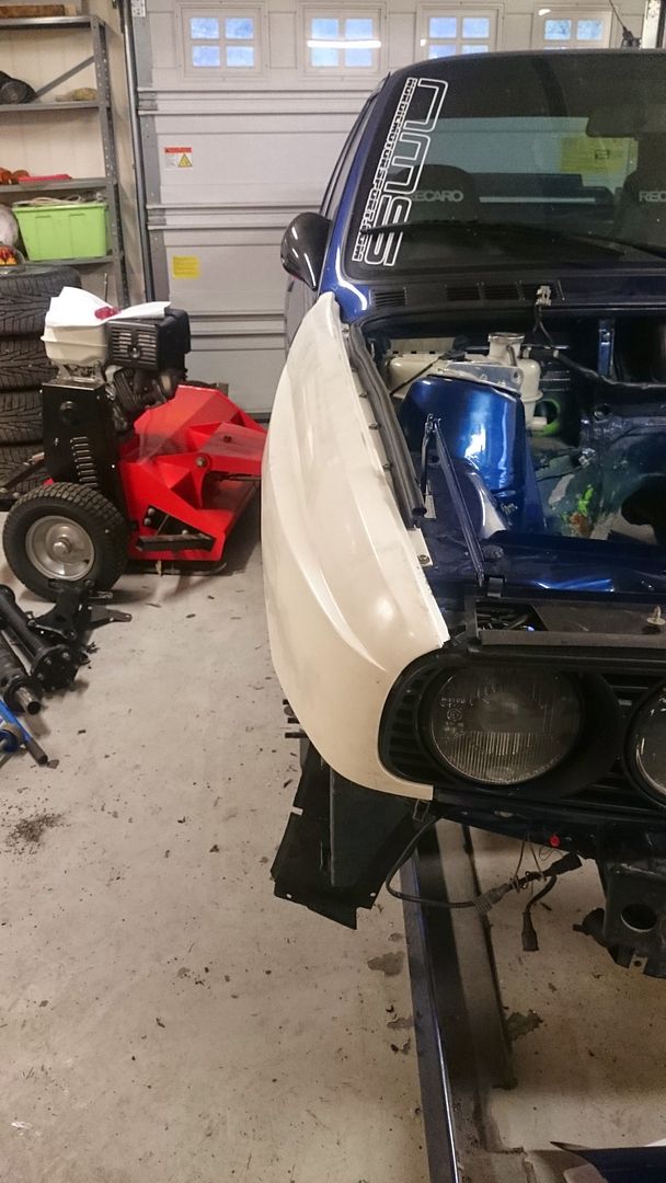

Had an incident last year. The trackday tire did hook itself on the front fender and bent it. So I bought a set of fiberglass Sport Evolution fenders that I have had laying around since. I started fitting them this week, and they fitted very well. Just need to lay some new fiberglass on the left one to get it fixed onto the point that is under the low beam light. Also saving 2.4kg pr front fender.
While I was on the loft finding the front fenders I stumbled over my old stock E30M3 S14 gearbox crossmember. And that looks like it would fit the RB25 gearbox mount. The rubber mount will fit right on, so lets hope it might be the right hight for the gearbox as well.

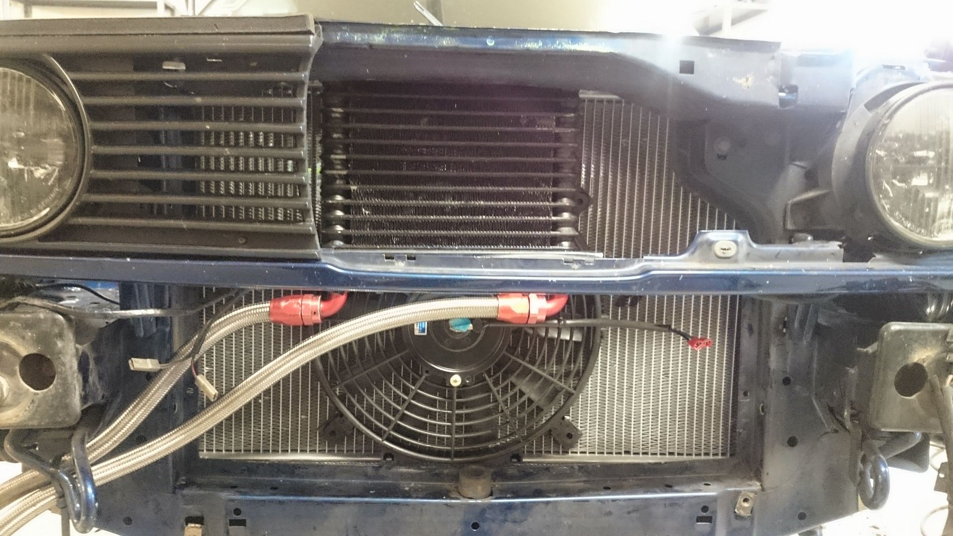

Also received my R32 GTR Mishimoto radiator the other day. Was lucky to get one used from a guy in Norway with two dual fans and a expansion tank. It sits very well in the chassis. Just need to make some good fixing points for it.
Searching Ebay I found this HKS Type R oil cooler and filter relocation kit for RB26. This is the best HKS kit they sell with thermostat in the filter housing. So I can now remove the stock water oil cooler under the intake for good. This kit cost a shit load of money new from HKS, so I was not slow on making the decision for buying this second hand. Gave it a good clean when it arrived. Probably need to make my own hoses, doubt this will bolt right up.
Just trying some different positions for the cooler and the fan. Having the fittings in the bottom of the cooler is suboptimal, but as I said I was just playing with it. Probably will fix it onto the top of the intercooler when I buy that.

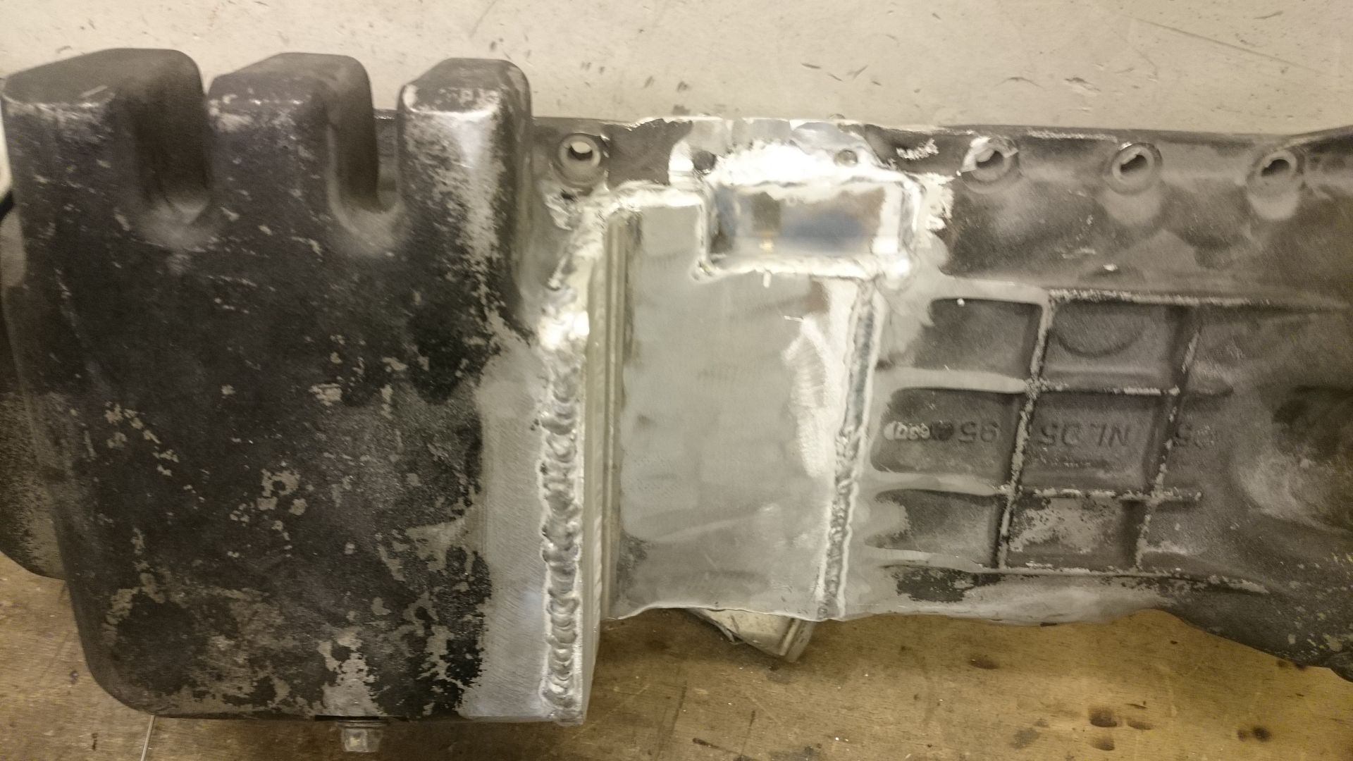

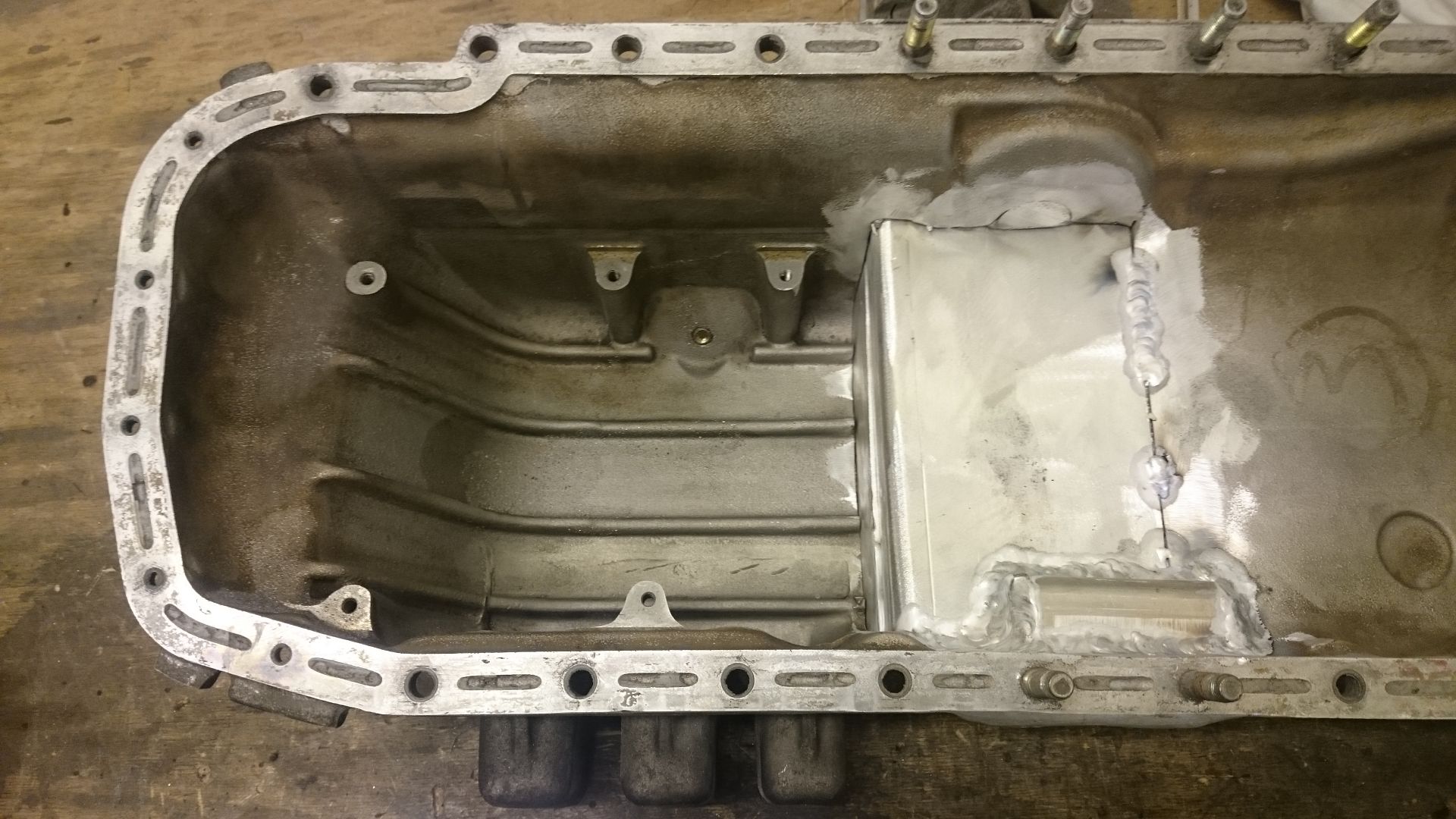

So. Have been working more on the oil pan. I have never ever tried to TIG weld aluminium before, so I had to give it a shot this time and try to learn it. I thought I got it going pretty well. It takes a lot of time compared to welding steel, that's for sure.

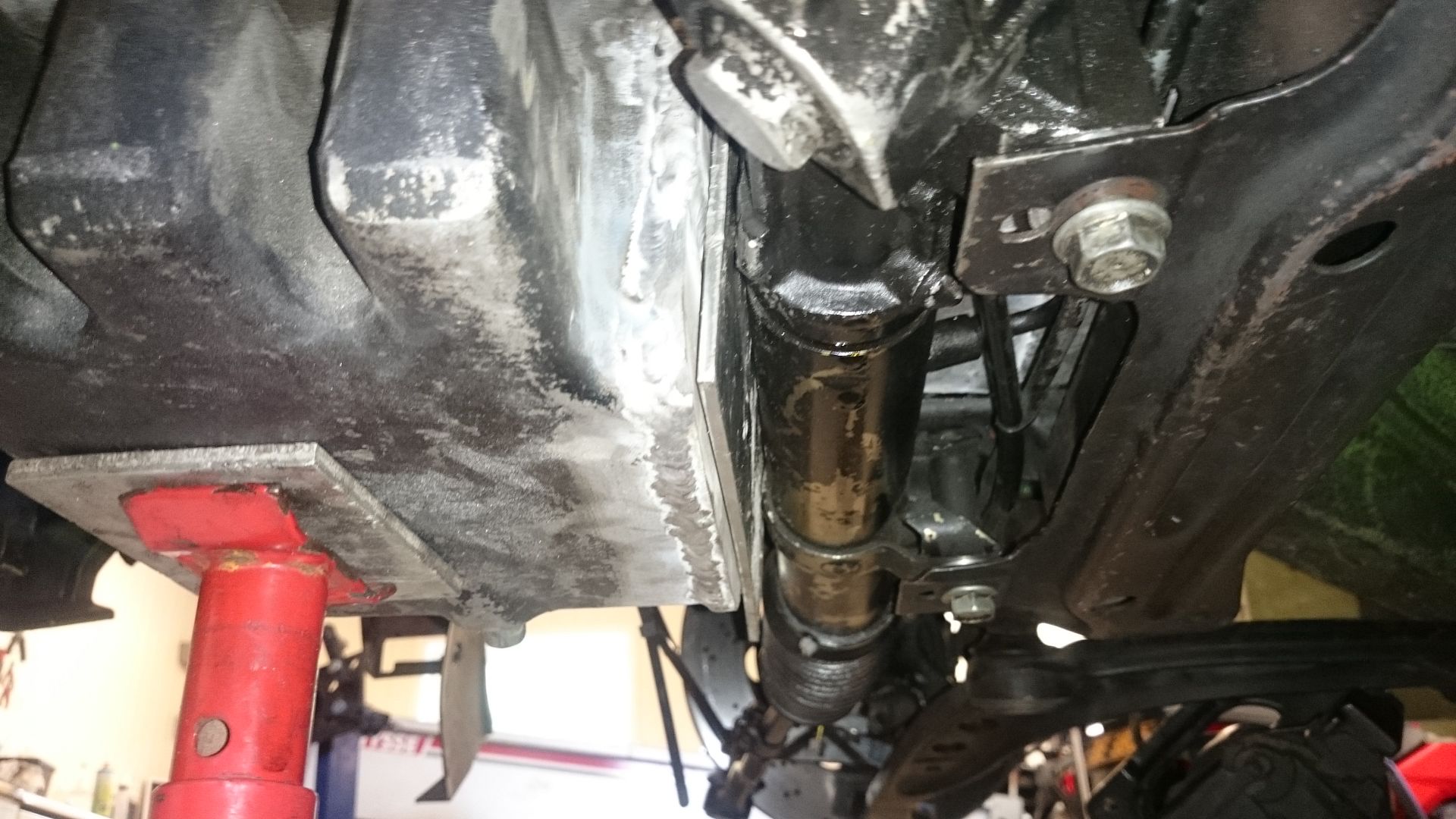

To start with I just cut out the oilpan to see if the engine would fit the car in the first place. Then I made some plates of 6mm aluminium and some half moons to close the holes for the driveshafts. After welding that on, The engine was crashing with the bracket for the steering rack.
In and out about 25-30 times I finally got it right with clearance and the engine placed in the middle of the car. Next step now is to start making the brackets for the engine mounts.
I also had to do some custom work on the JUN baffle plate. The sump became a bit smaller when I was finished, so the baffle plate would not fit as it was. So just some small mods and it was good to go.
The sump will be extended to both sides in order to swallow more oil.
I know the welds are not the art kind you usually see, but I like to do as much as I can myself and learn along the way.
Also got some more parts in the post. First to show up was the NISMO lightweight flywheel and the Cometic MLS gasket kit. Hopefully the rest will show up later this week, as well as the Mishimoto intercooler. Looking forward to place the coolers and everything.
Made some threaded aluminium bungs, and using the fixing ears that was already on the baffle plate.
Welded and is now fitting properly.
How it turned out. The dent you see is for the steering rack bracket.

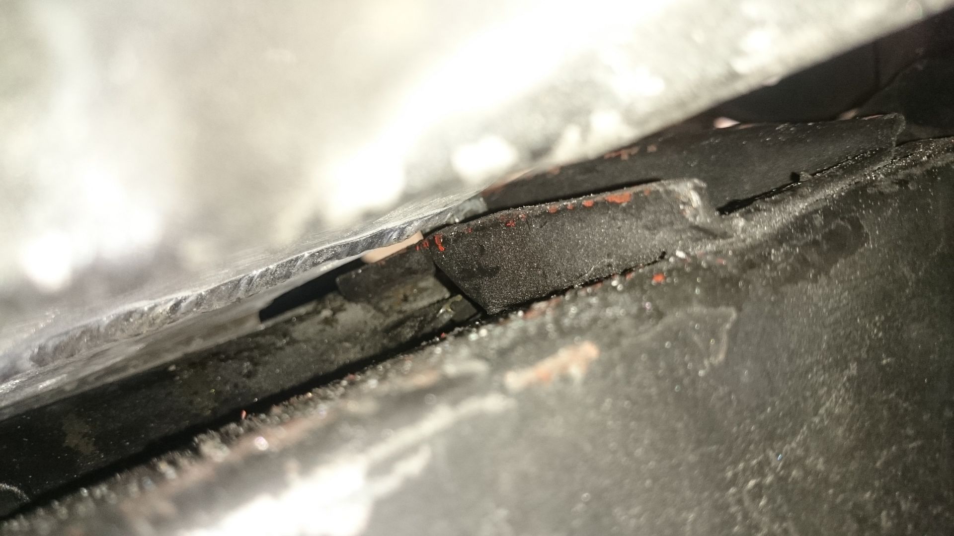

Fitted in the car. Had to cut off a small bit off the bracket after this photo in order to get more clearance. When it was in the centre of the car, it was touching the bracket.
Don't mind the loose aluminium plate. It is just to have some millimeters of clearance to the steering rack.

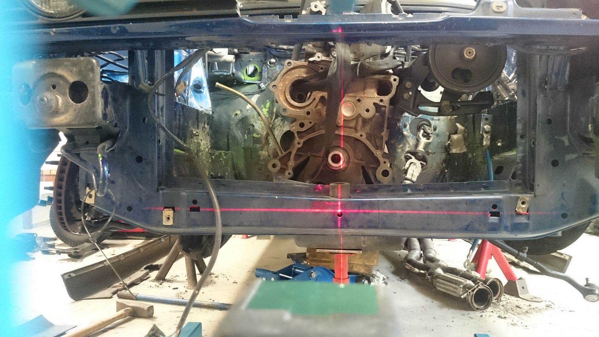

Mocking up with a laser tool. My car have been crashed on the left side at some point, so I don't think I can use a cross measurement to place the engine. Best I have is the small hole in the front box there.

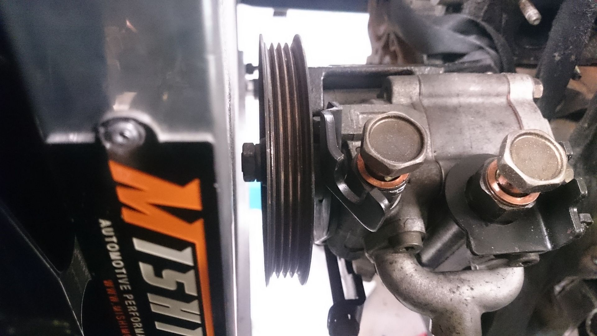

Probably need to convert to electric powersteeringp pump. I see VW Lupo/Polo and some other small cars have a very descent one.

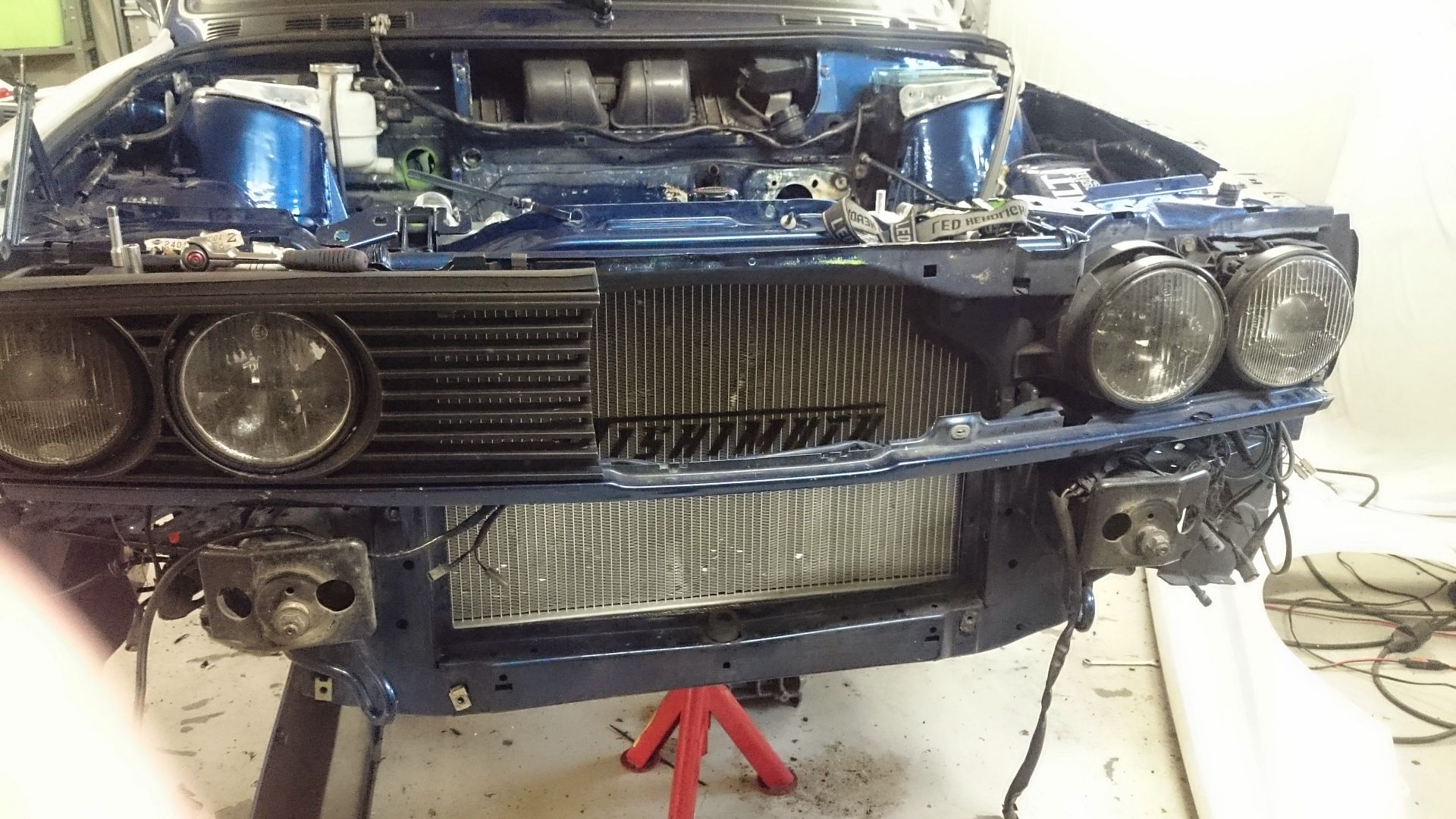

Have been working a bit on the car the last days.
Did get the intercooler mounted, and did mock up some other bits and figured out how to do things.
Made some room for the cooler in the front bumper here. Just used the grinder to shave off some plastic.
Had to shave off one of the points that holds the tow hook cover in place, when the tow hook is used.
Made some brackets for the intercooler, and a new lower mount for the radiator. The intercooler brackets is not finished on this picture.
And that leaves us with this. Always wanted a intercooler behind this front.

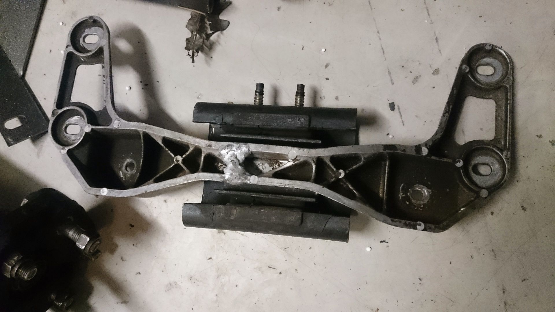

Gearbox mount is also bought from the same shop. That one is for the R33 GTS gearbox, and have not arrived yet.

The new gearbox mount:
Opel Zafira powersteering pump:

Also bolted up the oil cooler. Did not have more left of the clear bolts, so I had to use an anodized one. This bothers me, so I have to buy some more bolts so they can all be the same.
