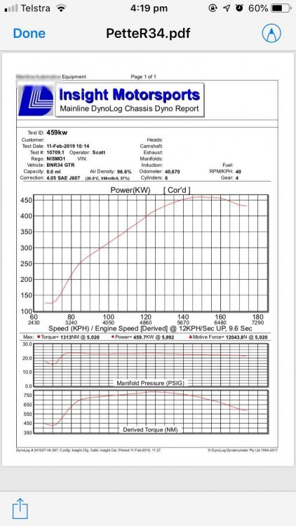

Here is the run-in tune , going down later this month to finish it. thought I would post it and see if there will be much of a difference after the next tune . Do not expect much of a change , just a bit more .
  The results were emailed to me and I was not too happy when I compared the both Dyno runs , but  the scaling was different for this tune. But the car runs better everywhere than the Dyno suggests. Need your bum in the seat to appreciate it.
Paul was up last week and took it for a drive , well more like a 120Klm romp, blew 3/4 of a tank and he was reasonably impressed with the way the car runs now

This is what the tuner said "I reckon you could do your lakesway run test not even revving hard under 4500rpm and it will be a beast.  It really is the opposite of nearly every other GTR in the world where they are normally barely waking up then."
Come a long way mate , expensive learning curve but all done at last ?
I drove this peach a couple weeks ago while up holidaying in Pete's home town.
Pete has mentioned that the old and new graphs don't show much difference. Throw the sheet in the bin is all I can say. It was stonking before this round but its halarious now.
Doing the 120 km belt through "The Lakes Way" which is Pete's little playground was interesting. There is not a corner in the whole joint that you need 1st, 2nd or 3rd gear. There was a sign posted corner that was 35 kph that I did in 4th gear. just as I straightened the wheel it was turning tyres. You honestly couldn't fall off song in this thing if you tried. A choice of 3 gears in every corner. Use odd gears or even gears.
Anything from 3000 RPM and its ON. Not just 'coming on"... full noise, MFD blinking red shit. Being in such a tall gear all the time you need to recalibrate. 3000 RPM in 4th and feed it on, you think you're ready to change gear, look down and you're at 5500 RPM. In 6th, it has 24 psi by 2700 RPM. It’s a joke. As a street GTR, it would be bloody hard to beat this thing. Can turn tyres in the first 4 gears without much effort at all. Tyres are not motorway spec junk either. 275 RS4's with a Quaife front diff and the transfer case mod done.
If you're not happy with it Pete, time to sell it because it does its thing so bloody well!
You could quite easily get away with a 9180 on it and still be sweet. I know we have both spoken about it a zillion times, it aint for you.
It does need brakes though. The thing doesn't stop AT ALL! Perhaps a set of decent pads (Endless CC-RG's) would go a long way here.
The torque steer might need to be addressed too. It's quite scary.
Here is to the tadpole. The black tractor of the Mid North Coast!

The car drives as I always wanted it too , just took a while to get it there.
No 9180 for me , 460 AWKW and lots of torque is more than plenty for a streetcar , well for me, not you, hahaha.
