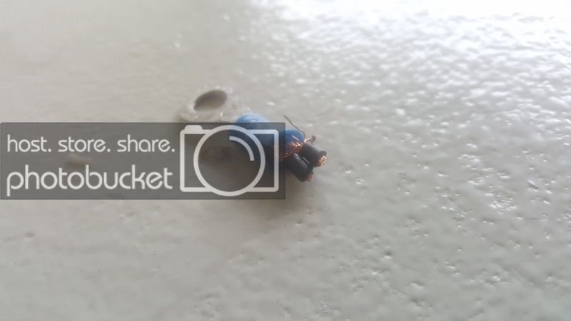

So I had a bit of a look at the wiring for the alarm. Found the earth looking a bit dodgy (it was connected, I cut it and re terminated it properly):
I think it was just installed poorly. Those 2 wires are supposed to go to seperate earth points. I might have a look at the power source tomorrow
