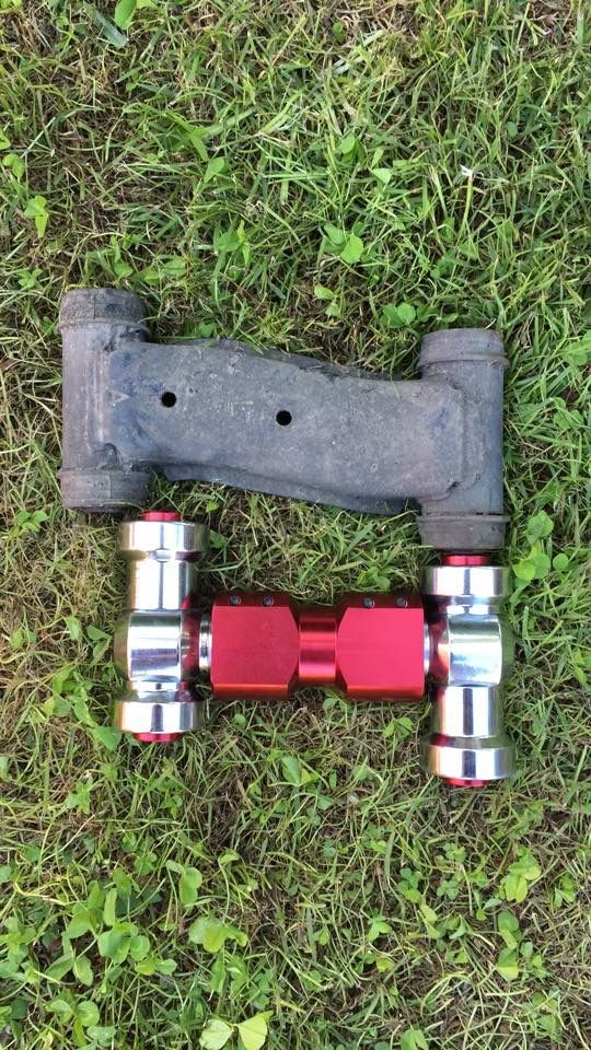

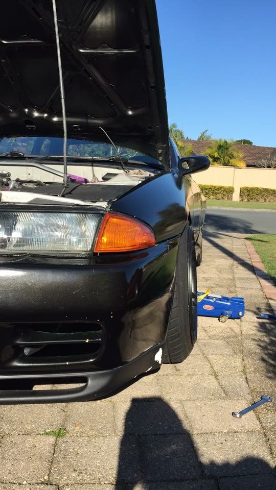

So I've searched the forums for similar issues and haven't been able to find much information. I'm currently trying to fit a set of 18x11 +20 Concave Concepts to my Gts-t and have purchased and installed a set of Front Upper Camber Arms to try and pull them in a little as they poke on my Gts-t guards quite a bit as pictured. Although since doing so have run into a few problems.
1. After adjusting the camber it looks as though the wheel sits further back inside the arch towards the back of the car and is now rubbing quite heavily against the guard/sideskirt mount when turning. (I'm thinking caster arms will fix this as I assume the caster is all out of whack)
2. After adjusting the camber the inside of the wheel looks like its sitting over the coilover (above the lock collar for the base and below the lock collar for the spring) and over hard bumps the coilover compresses and hits against the inside of the rim.
3. At full lock, or close to, the inside of the rim rubs up against the upper wishbone and makes a horrid grinding noise (I have since notched out the wishbone but apparently not enough because it still does it)

Thanks for the response, I have a pair of Gtr guards along with the indicators to go on, I think I might do that before touching anything else. Inner guard lining was removed long ago and loom has been tucked up higher out of the way. Then hopefully with the extra outside clearance I wont have to run such aggressive camber, I also need to run more caster rather than less as the wheel has heaps of room at the front but very minimal at the rear.
As far as the ADR's go I was unaware it was the whole wheel, I've always gone off the assumption that the top of the rim had to sit underneath the guard.
