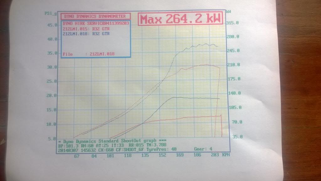

sneakey pete Posted May 20, 2016 Share Posted May 20, 2016 Here's the dyno sheet for them on 98. Link to comment https://www.sau.com.au/forums/topic/464897-tomie-neo-turbo/page/2/#findComment-7730477 Share on other sites More sharing options...
Count Grantleyish Posted May 20, 2016 Share Posted May 20, 2016 Hahahahahahahahahahaha Holy shit. Link to comment https://www.sau.com.au/forums/topic/464897-tomie-neo-turbo/page/2/#findComment-7730482 Share on other sites More sharing options...
r32-25t Posted May 20, 2016 Share Posted May 20, 2016 I will never complain about lag ever again Link to comment https://www.sau.com.au/forums/topic/464897-tomie-neo-turbo/page/2/#findComment-7730484 Share on other sites More sharing options...
NISR32.5 Posted May 20, 2016 Share Posted May 20, 2016 (edited) Hahahaha that's awesome. Makes -5's look magical Edited May 20, 2016 by NISR32.5 Link to comment https://www.sau.com.au/forums/topic/464897-tomie-neo-turbo/page/2/#findComment-7730486 Share on other sites More sharing options...
Jordy32 Posted May 20, 2016 Share Posted May 20, 2016 Hooooly shit... Hahahaha Link to comment https://www.sau.com.au/forums/topic/464897-tomie-neo-turbo/page/2/#findComment-7730498 Share on other sites More sharing options...
sneakey pete Posted May 21, 2016 Share Posted May 21, 2016 Least my new turbos will be nicer Link to comment https://www.sau.com.au/forums/topic/464897-tomie-neo-turbo/page/2/#findComment-7730652 Share on other sites More sharing options...
r32-25t Posted May 21, 2016 Share Posted May 21, 2016 Agree cause nothing will ever be worse then that I really do feel bad putting shit on your sheet but that's literally the worst I've ever seen and I had s typhoon with a gt42 on it Link to comment https://www.sau.com.au/forums/topic/464897-tomie-neo-turbo/page/2/#findComment-7730660 Share on other sites More sharing options...
XGTRX Posted May 21, 2016 Share Posted May 21, 2016 Gee Impressive. Funny impressive, but impressive none the less. Link to comment https://www.sau.com.au/forums/topic/464897-tomie-neo-turbo/page/2/#findComment-7730665 Share on other sites More sharing options...

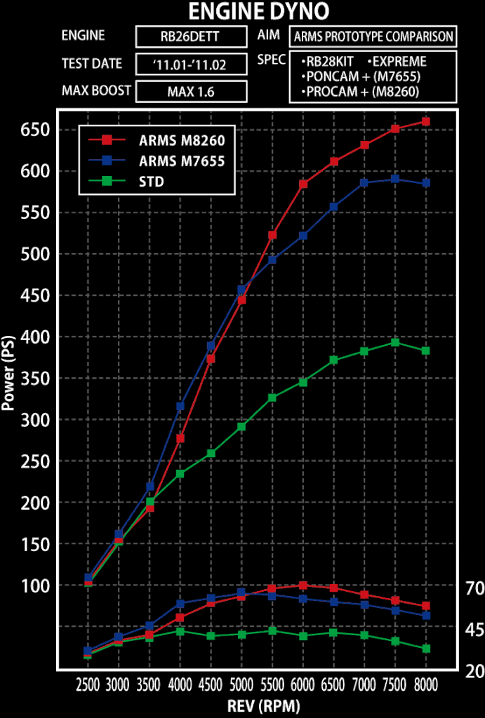

niZmO_Man Posted May 23, 2016 Share Posted May 23, 2016 Funnily enough, on the Tomei site one of the "supporting mods" is a 2.8 litre. LolHahaha fine print. Link to comment https://www.sau.com.au/forums/topic/464897-tomie-neo-turbo/page/2/#findComment-7731302 Share on other sites More sharing options...
Trex Posted May 23, 2016 Share Posted May 23, 2016 What's the correction for speed to rpm on that dyno sheet? Link to comment https://www.sau.com.au/forums/topic/464897-tomie-neo-turbo/page/2/#findComment-7731351 Share on other sites More sharing options...
Piggaz Posted May 23, 2016 Share Posted May 23, 2016 Hahaha fine print. Lol. Link to comment https://www.sau.com.au/forums/topic/464897-tomie-neo-turbo/page/2/#findComment-7731358 Share on other sites More sharing options...
Piggaz Posted May 23, 2016 Share Posted May 23, 2016 What's the correction for speed to rpm on that dyno sheet? Assuming a 265 35 18 tyre and stock diff ratios, it's 29.25 km/h per 1000 RPM. Link to comment https://www.sau.com.au/forums/topic/464897-tomie-neo-turbo/page/2/#findComment-7731369 Share on other sites More sharing options...
sneakey pete Posted May 23, 2016 Share Posted May 23, 2016 Pfft, 18s. 17s 245/40/17 from memory. Pretty much the same size though so above would be correct. Link to comment https://www.sau.com.au/forums/topic/464897-tomie-neo-turbo/page/2/#findComment-7731371 Share on other sites More sharing options...
Trex Posted May 23, 2016 Share Posted May 23, 2016 Assuming a 265 35 18 tyre and stock diff ratios, it's 29.25 km/h per 1000 RPM. Hmm 80kw by 3k isn't too bad. I'll do an overlay this arvo against a 21u highflow and 43g3. Link to comment https://www.sau.com.au/forums/topic/464897-tomie-neo-turbo/page/2/#findComment-7731381 Share on other sites More sharing options...
r32-25t Posted May 23, 2016 Share Posted May 23, 2016 80kw at 3k is horrible Link to comment https://www.sau.com.au/forums/topic/464897-tomie-neo-turbo/page/2/#findComment-7731407 Share on other sites More sharing options...
Trex Posted May 23, 2016 Share Posted May 23, 2016 80kw at 3k is horrible From all the dyno sheets I've seen and have been overlaying. 80kw by 3k is what the stabdard 21u and highflow is doing. Not sure what you've been looking at. Link to comment https://www.sau.com.au/forums/topic/464897-tomie-neo-turbo/page/2/#findComment-7731409 Share on other sites More sharing options...
r32-25t Posted May 23, 2016 Share Posted May 23, 2016 The fact that my Gtr makes 115-120kw at 3000rpm and has "old school twins" on it Link to comment https://www.sau.com.au/forums/topic/464897-tomie-neo-turbo/page/2/#findComment-7731465 Share on other sites More sharing options...
sneakey pete Posted May 23, 2016 Share Posted May 23, 2016 Don't know where the 80 at 3k is coming from, it's closer to 60 on my graph. If I had better connection ID dig up the last graph I had done, when it was on e85 Link to comment https://www.sau.com.au/forums/topic/464897-tomie-neo-turbo/page/2/#findComment-7731548 Share on other sites More sharing options...
XGTRX Posted May 23, 2016 Share Posted May 23, 2016 Ha ha that's funny. I think mine makes 70kws at 3000, which is at the bottom of the cliff. He he he. Link to comment https://www.sau.com.au/forums/topic/464897-tomie-neo-turbo/page/2/#findComment-7731549 Share on other sites More sharing options...
