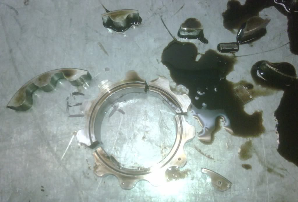

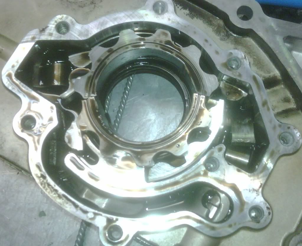

Just pulled engine out. Pictures of oil pump gear follow: Note that the inner drive ring was broken into three pieces and the ohter gear was smashed into lots of pieces!
This was the drive gear - broken in three places.
This was the pump as we opened it up. The outer gear was in lots of pieces!
Boo hoo!
And please don't tell me that revving an N1 motor to the redline will cause this. You may be right - but any motor should be designed so that there is a safety margin beyond the red line, so that you can rev to the limit and even slightly beyond, without catastrophic failure. I have seen so much cr#p on forums around the world recently claiming that failures have happened because the unfortunate owner "did not know how to drive an RB26"!!! What a load of bolleaux. If the N1 oil pump cannot be taken safely to the end of the factory defined rev range, then it is a piece of cr#p and totally unsuited for the job it is supposed to do. Note that I had an ATI harmonic balancer on there too, so there should have been no problems with harmonics. There is clearly an inherent problem with the design and/or materials of these pumps, otherwise we would not be getting so many failures.
And before some keyboard warrior dismisses this as another cheap oil pump from ebay, this was a genuine Nissan N1 oil pump that came as part of a factory N1 crate engine!!
