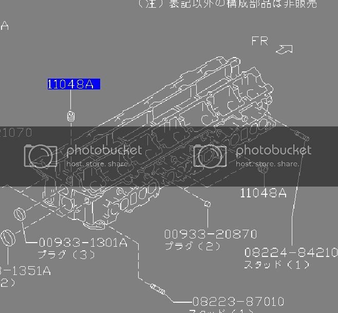

On 13/01/2017 at 5:32 PM, 89CAL said:
Its been a while but arent there some plugs up around that area? I assumed they were for coolant but could be wrong. Worth pulling the whole coil pack assembly off i would think if you havent already done so.
Also, its easier to undo the 5 bolts that hold the coil pack brackets in place to do plugs than to pull each individual coil pack off. If it helps :)
That was the plug I was talking about. I think there are a few along the top of the head. Wouldnt hurt to pull all the coilpacks out and check. They may be for oil though. I'm not 100% sure
