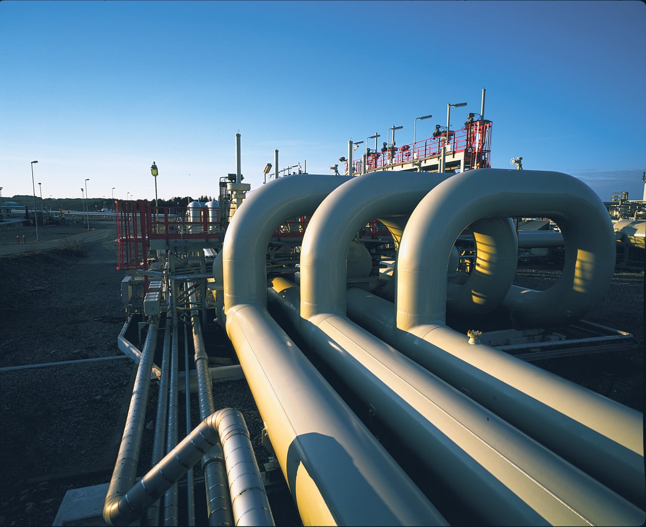

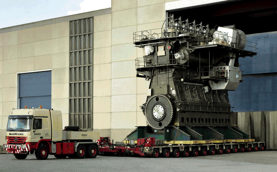

Count Grantleyish Posted February 23, 2017 Share Posted February 23, 2017 I like where you guys are heading with this. Also considering: Will it dose? Link to comment https://www.sau.com.au/forums/topic/468826-blown-neo-bottom-end-next-steps/page/3/#findComment-7813037 Share on other sites More sharing options...
Dose Pipe Sutututu Posted February 23, 2017 Share Posted February 23, 2017 33 minutes ago, Count Grantleyish said: Will it dose? will need fill custom dose pipe, going to be hard to find a 10" pipe and bends lol Link to comment https://www.sau.com.au/forums/topic/468826-blown-neo-bottom-end-next-steps/page/3/#findComment-7813045 Share on other sites More sharing options...
GTSBoy Posted February 23, 2017 Share Posted February 23, 2017 5 minutes ago, Dose Pipe Sutututu said: will need fill custom dose pipe, going to be hard to find a 10" pipe and bends lol 10"? Keep going. We're talking 3' at least! 1 Link to comment https://www.sau.com.au/forums/topic/468826-blown-neo-bottom-end-next-steps/page/3/#findComment-7813048 Share on other sites More sharing options...
V28VX37 Posted February 23, 2017 Author Share Posted February 23, 2017 I've got this guys, going full custom steampipe manifold too Not sure if Turbosmart have anything off-the-shelf for this though 3 Link to comment https://www.sau.com.au/forums/topic/468826-blown-neo-bottom-end-next-steps/page/3/#findComment-7813050 Share on other sites More sharing options...
