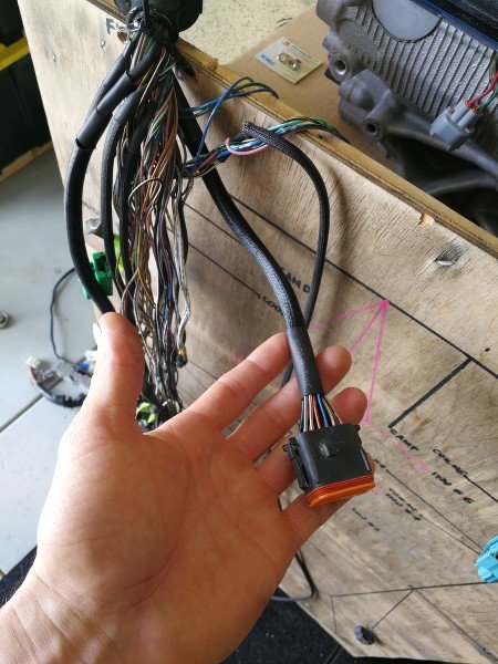

Started work on the harness to relocate some things and re sleeve it all.
All marked out on a board so I know how long each connector sub harness needs to be and when to tee off. The he bits in red are what is getting relocated.

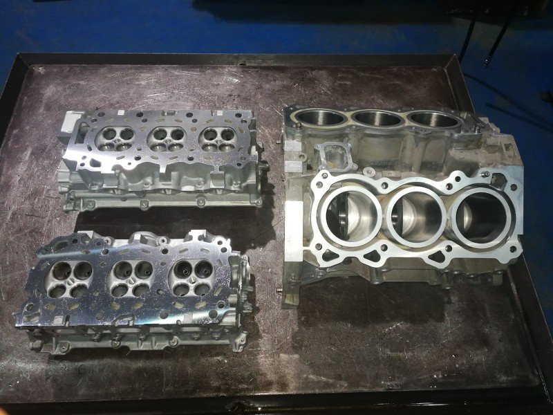

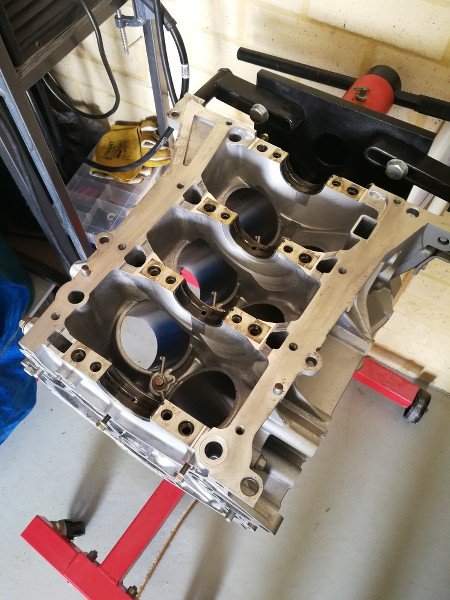

Sent the block and heads out to get skimmed by Danny at Performance Modifications, who do stellar work as always. The only thing I found with the motor I tore down was a possible blown head gasket, no damage to the bores, crank, rods and normal wear on the bearings. What a score!

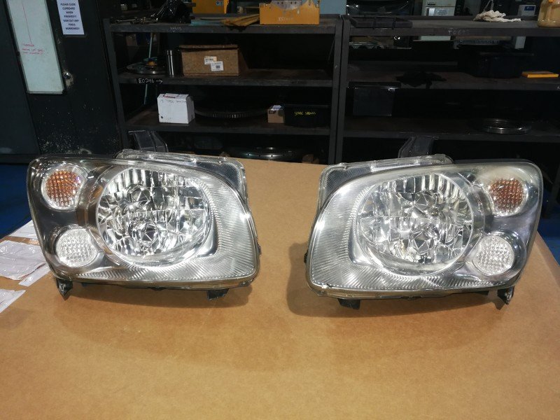

Whilst waiting for the machining to be done I did a headlight restore as they had the classic JDM yellow to them. (Restored on the left and old on the right)

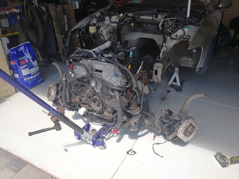

I removed the whole front end then dropped the front subframe, engine and gearbox down as a whole. First time I've done it like this and makes it's so much easier to access everything on install.

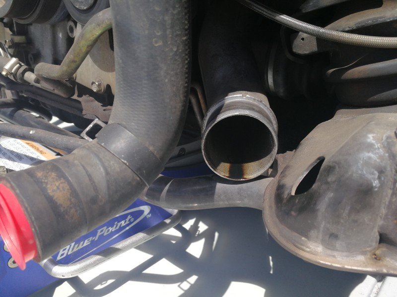

Ripped a whole bunch of shit off and confirmed the worst. So much blowby that the plumb back BOV is filling the turbo outlet pipe and the turbo also has blown the turbine seal as it has oil residue in there.

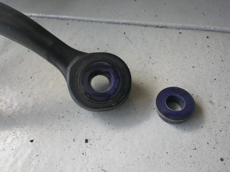

But on a side note I had a score with the subframe bushes being Superpro items!

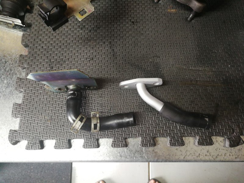

I'll be fitting an inline oil filter and have also made up a new turbo drain to help the oil flow after drilling out the banjo bolt.

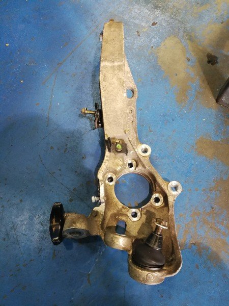

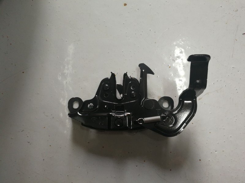

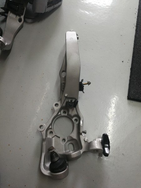

Did some restoring over the weekend. While the parts are off I thought I may as well make them look factory new again.
200,000km old
Like new and sealed in clear.
Passenger side assembled with new wheel bearing

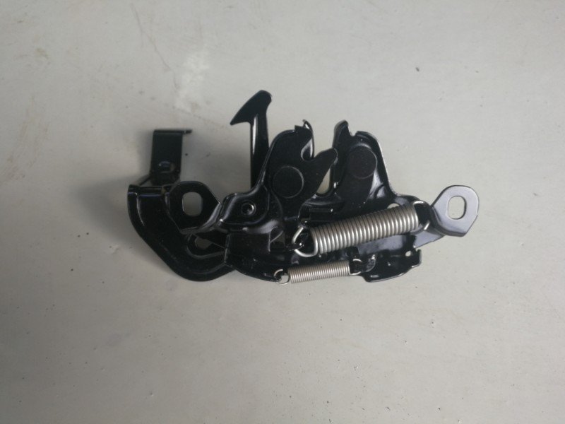

Even did the bonnet latch too!
Also whipped up a new oil drain to help it to not back up with having more oil supply to the high flow turbo.

ACL Race Series mains ready for crank install. Still waiting on rod bearings as I ordered the wrong ones. Rings and rod bolts still in transit from Nissan.
ARP head studs awaiting install once I buy some Supertech valve stem seals to build the heads.

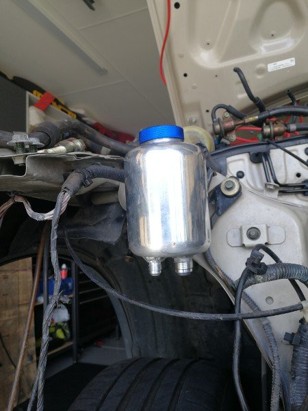

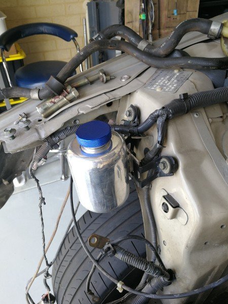

Modified a China special power steering reservoir as the OEM rubber hoses keep leaking. This mounts up to the factory bracket and will use braided line with JIC fittings so no more leaks

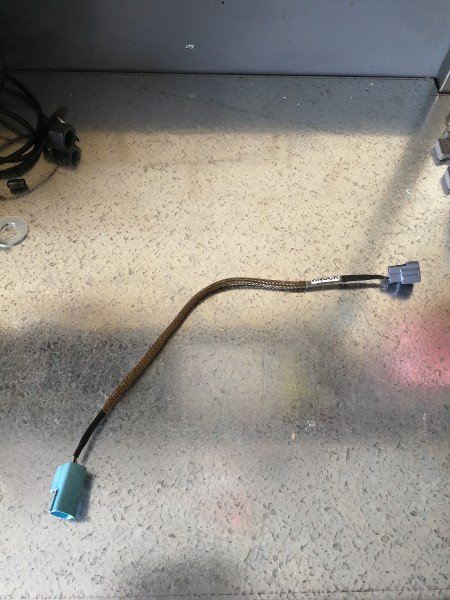

Re wired the knock sensor sub harness and slipped some basalt heat sleeve over it.

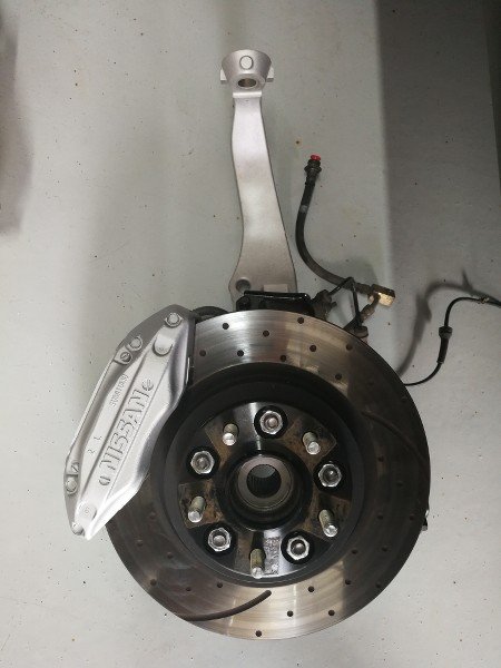

Cleaned up the front subframe and resprayed. So much oil and CV grease covering it.
Fitted new inner LCA Whiteline bushes after I cleaned the LCAs up.
Bolted it all up including coilovers so that I can drop the motor on later and roll it around easily to get it back underthe car.
