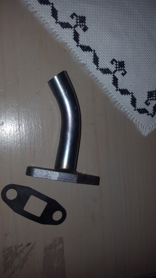

The kink is actually a lot worse than it looks from that angle. It blocks about 90% of the hose diamtre, leaving only a few mm of free space inside instead say 20mm.
My plan next time i go work on the car is to take the metal oil drain pipe of the turbo somehow while its still on the car and bend it to the right shape with some vice grips and persuasion. I hope this goes ok for me.

The oil drain is also badly kinked so wont be able to drain quick enough and it will blow smoke badly
7 hours ago, hy_rpm said:
Why dont you just cut the oil drain metal pipe shorter so it the hose wont have to bend so sharp
Yea i was gonna try do that tommorow hopefully. I was thinking of bending it. You recomend cutting it and bending it or just bending it/cutting it?
Edited by sonicz
Nevermind ill just shorten the pipe by about 7cm that way it wont even matter which way its facing.  F it probably never using the stock silver oil drain hose again anyway.

On a update, I managed to fit the missing bolt to the turbo and cut the oil drain hose and file it off to fit over the bolt as can be seen in bottom right of pic. Hopefully goes on ok next time i go to see the car and try fit it back on.
keep in mind i am doing all this with the turbo attached to the car and all bolts +piping. Not easy. In fact incredible infuriating Gotta find a way to supersglue the gasket to the oil drain hose so it doesn't move around when fitting it. I hate gaskets without a insert for them.
Oh and taking the metal pipe of the blue oil drain hose was ridiculous. That hose even though it says 19mm feels WAYYYYY to snug for this application I hardly got it on but after days of sitting there I could have suspected my body-weight on the 2cm it was holding onto the metal oil with no clamp. FARKKKKK.

Ive already fixed the oil drain hose kink by cutting the pipe.
