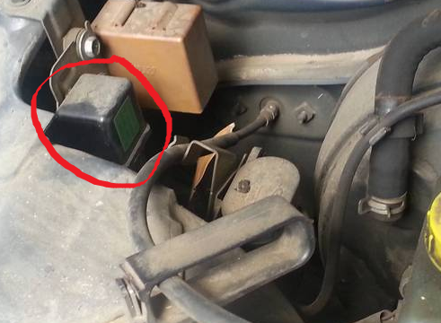

Ok, coils fixed, but the relay (well, it sounds like one) is still clicking every 16 seconds.
It was in the engine compartment, lhs next to the steering, black case in front of the brown box. Can anyone tell me what it is??
ie
Edited by ian
ok, pulled the relay out, and the 4wd warning light goes on..
So something in the 4wd system is getting this relay to pulse on every 16 seconds...

Anybody with suggestions?
