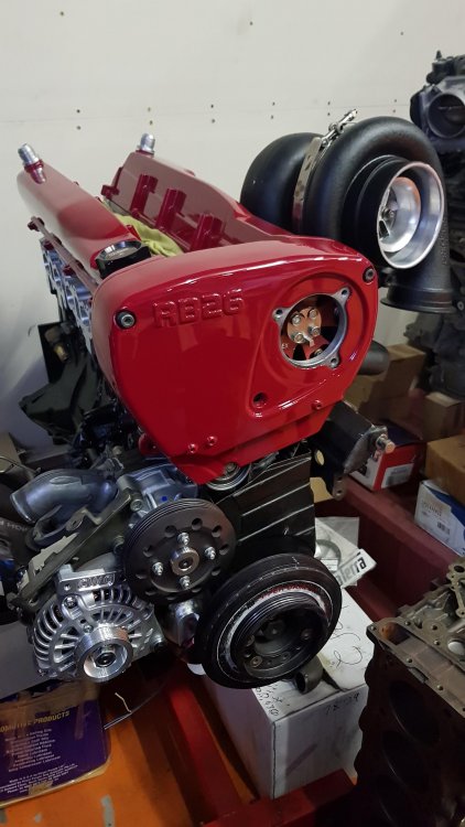

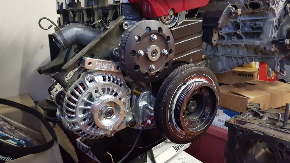

Would it be possible to see a pic of an RB spec Mitsubishi Alternator next to the LS Mitsy one please .
I'm very interested in this kit but just curious to see if the LS one is larger in diameter compared to the Nissan supplied one .
Mine would be for an R33 spec RB25DET .
Thanks in advance , cheers Adrian .
