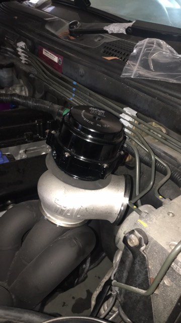

ROM10 Posted April 5, 2018 Author Share Posted April 5, 2018 more pics 1 Link to comment https://www.sau.com.au/forums/topic/473697-r34-gtt-build-both-street-and-track/#findComment-7871791 Share on other sites More sharing options...
ROM10 Posted April 5, 2018 Author Share Posted April 5, 2018 forgot to add 90mm throttle body, and 60mm waste gate Link to comment https://www.sau.com.au/forums/topic/473697-r34-gtt-build-both-street-and-track/#findComment-7871857 Share on other sites More sharing options...
