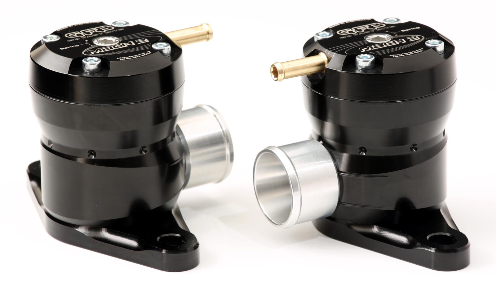

GFB do BOVs called mach2 that fit the stock location. model number is T9105 for the pair. they do make outlet adaptors that are the right size for the GTR recirc pipe, so they're a direct replacement but you'd have to call and order them direct from GFB, not from a reseller. about $350 from memory.
I've got two installed in place of the stock ones that failed a boost leak test and they are working great. they were a direct fit, plug and play,.
Image?urlId=%2FSmgqYPc3qJirYaq8QDnPPu9iK
Real good to know ill look into it.
Thanks for that - that would work perfect and easy to fit.
