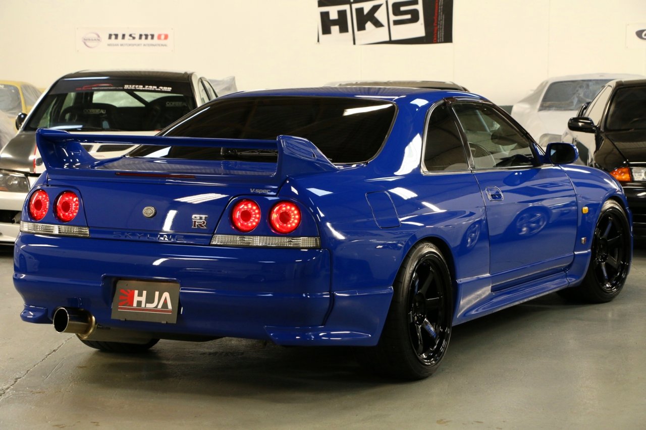

This is how my rear currently looks. Never really noticed the camber on the rear but R33 GTR's with larger wheels tend to have -2.2+ camber on the rear.
Anyone know how much camber this GTR is running?
Oh don’t get me started on front and fear camber on R33s !
I got very tired of seeing my tyres chewed out on the inside because of what wheel alignment places said I must run for my car when all I wanted was the car to run flat on the road and wear the tires evenly.
Eventually ( after going to two noteable alignment places who told me it couldn’t be done ) I found a place that adjusted the camber to run flat on the road.
I run 255 on the front and 265 on the rear so and get full use out of the tyres even with the rear squatting down under load.
Next one was trying to get the rear subframe alighted centrally to the body so the tyres don’t stick out of the guards by 10 or so millimeters on one side !
There's probably some sort of deep seated problem if you have a 10mm track misalignment...
