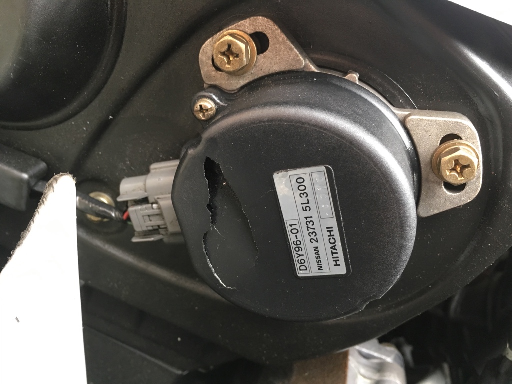

I bought a Skyline R34 Turbo for about $10,000 but without roadworthy, the dodgy owner said there shouldn’t be anything needed for RWC and I trusted his words! :s
But once I got the car and took it to mechanics and inspected it..
IMG_2016.thumb.JPG.b2dfb4e2f2b103700be48141e83ce875.JPGIMG_2029.thumb.JPG.32f06181a8eada19569e2d3f238c503a.JPGIMG_2139.thumb.JPG.393af07d5b8389d07052442bf1336f56.JPGIMG_2222.thumb.JPG.7dfc281626c8d450a4c9981475b1cb7c.JPGIMG_2345.thumb.JPG.9476f1e53d1495113dfd2377964ba342.JPGIMG_2224.thumb.JPG.13a0abfc71a789573d978c9d0a70a71e.JPGIMG_2326.thumb.JPG.af9c98ca47e0bf60f595a53b28810b11.JPGIMG_3359.thumb.JPG.f63f0fda26f3a31357203c53c0e8322a.JPG
Mechanic said the car had a accident in the front and it pushed in some mechanical parts.
Founding:
-Ignition Coils MisFiring & Spark plugs were on there way
-Rear Suspensions were busted
-Missing Parking light wires
-Water Pump leaking at weep hole
-Instrument Cluster is Faulty
-Missing 5 Wheel studs in Total
-Harmonic Balancer was bent and damaging the belts
-Radiator slowly leaking
-Tyres has about 30% tread left
-No coolant found in radiator so it rusted and corroded default_sad.png&key=60edf0cfeb1b5687d093da59e19dcb4bc4ca5078c255acb1c3a47ac6adc5cc5e

Coils are easy.  $500, but easy.
Rear dampers are easy.  A few hundred for cheapies, or much $$ for things worth having.  But easy.
Parking light wires are easy
Water pumps are easy, and I replace the pump on EVERY car/engine I buy, along with the timing belt and any seals etc in that area while it is accessible.
Instrument cluster might be harder.
Wheel studs are easy
Harmonic balancer is easy.  Not necessarily cheap, but easy enough.
Radiators are easy.  And cheap.  And easy.
30% tread on tyres could last 10000km.
Dirty cooling system will take you at least 5 flushes and uses of muck-out etc etc to clean it up.  Manual poking of bleeders on the inlet manifold will probably also be required.
$20 will not do it.  Time to go turn some tricks to pay for your new habit.
