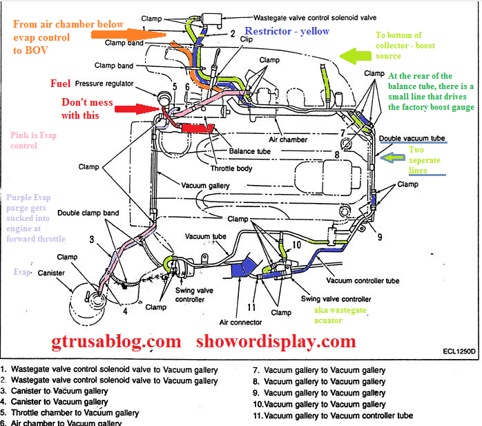

Silverhks Posted February 24, 2019 Author Share Posted February 24, 2019 (edited) Had some time to to work on the car today. Installed the starter, the oil takeoff block, and intake manifold. I had to stop installing things because I am waiting on the oil pressure extension so I can mount it in the block and my remote oil filter mount, fittings, and hose. I did start building up the IAC assembly and sorting out the other hoses I will be keeping. I would like to change to a stepper IAC at some point but that is going to need to wait until I can replace the ECU. There are 2 vacuum lines that come around the back of the head and tie into the water tube. Both are capped at the front side. If I understand this correctly. The green line should have pressure from the plenum, correct? My initial thought is to run a line off the plenum with a tee. 1 side going to the EBC and 1 connecting to the green hard line completely avoiding the water tube hard lines completely. I would then connect the EBC signal line to the blue hard line. Does that sound correct? Then the 2 steps forward 1 step backwards aspect of my time with this car rears it's head again. I removed the towel I had covering the head to see this... Yes that is rust on the cam lobes. I'm not sure what my options are at this point other than to pull the cams and have them polished. Which leads to "as long as I'm there" I need to get some cam gears. It will also allow me to measure the cams so I know what I actually have. Edited February 24, 2019 by Silverhks grammar Link to comment https://www.sau.com.au/forums/topic/476110-a-r32-buildmaintenance-thread/#findComment-7899114 Share on other sites More sharing options...
