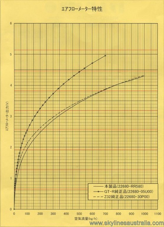

ok so I've done some more digging and have come accross this nismo plot of the AFM curve. I have interpolated several points that cross the grid neatly and it seems to line up with the nistune calibration curves.
will see how this goes first and build a manometer/oriface plate/pitot etc if needed. it appears that using a stock RB-26 AFM will be better for my needs as it gives much better flow resolution down low.
nismo graph of voltage vs flow:
nismo_afm_ed.jpg.19b31d80f9f19f8a2ec6e2b
Voltage (v) % Scale g/s
0.080 0.073 0.356
0.160 0.073 0.356
0.240 0.073 0.356
0.320 0.073 0.356
0.400 0.073 0.356
0.480 0.073 0.356
0.560 0.111 0.542
0.640 0.159 0.772
0.720 0.218 1.061
0.800 0.290 1.410
0.880 0.377 1.833
0.960 0.487 2.367
1.040 0.618 3.005
1.120 0.777 3.777
1.200 0.974 4.734
1.280 1.196 5.817
1.360 1.445 7.026
1.440 1.723 8.377
1.520 1.982 9.638
1.600 2.373 11.537
1.680 2.753 13.385
1.760 3.182 15.470
1.840 3.658 17.785
1.920 4.179 20.322
2.000 4.747 23.082
2.080 5.362 26.072
2.160 6.055 29.441
2.240 6.833 33.225
2.320 7.671 37.298
2.400 8.582 41.728
2.480 9.572 46.543
2.560 10.634 51.707
2.640 11.765 57.205
2.720 12.978 63.103
2.800 14.269 69.380
2.880 15.628 75.991
2.960 17.073 83.017
3.040 18.601 90.444
3.120 20.217 98.302
3.200 21.930 106.634
3.280 23.737 115.418
3.360 25.669 124.812
3.440 27.681 134.598
3.520 29.770 144.755
3.600 31.972 155.462
3.680 34.275 166.658
3.760 36.698 178.440
3.840 39.240 190.801
3.920 41.920 203.830
4.000 44.746 217.571
4.080 47.710 231.987
4.160 50.820 247.108
4.240 54.066 262.889
4.320 57.447 279.331
4.400 61.001 296.611
4.480 64.704 314.618
4.560 68.548 333.308
4.640 72.547 352.755
4.720 76.704 372.966
4.800 81.025 393.978
4.880 85.512 415.791
4.960 90.167 438.428
5.040 94.995 461.904
5.120 100.000 486.240
