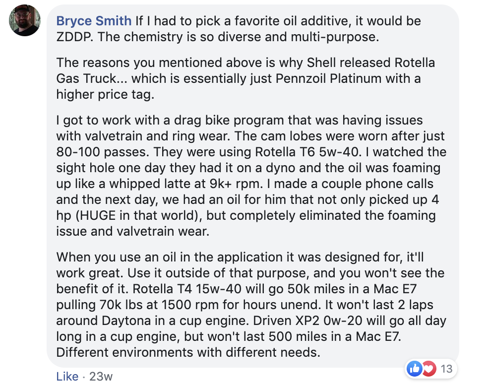

Foaming in gasoline engines occurs when you do something like hard cornering and oil sloshes up the sides of the crankcase and gets whipped up by the crankshaft. Or the piston squirters in the OEM and Tomei RB26 pistons that cause oil to fall onto the crank that gets whipped up. Do this at 8000+ RPM and you will create some foam. Or overfill and the crank will start whipping up oil as soon as you turn the starter.
I'm always super, super skeptical of oil discussions because it's pretty much cargo cult stuff or straight up pyramid schemes in the case of Amsoil. But there is this post: 1764461059_ScreenShot2020-03-30at9_42_36PM.png.05d6a9c6b8112cca12ff1e391b8ce0a0.png
Whether there's any truth to this post is hard to say, but the source is here:
Personally nothing I run is ever going to need more than whatever full synthetic is 5 USD/quart online or at a local store. I would probably be just fine with Rotella T6. But I would be very cautious of making that recommendation to all people for all things.
