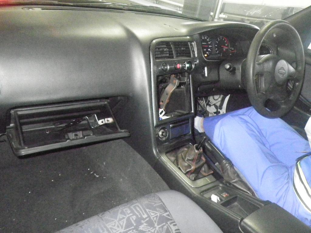

AC Relocated to the armrest
what is that clicking when put ignition on 2? might it be the AC? also the guy told me that when i turn the car off in gear without handbrake the turbotimes starts. but he doesn't know where it is.
i also figured out when i turn off ignition after having it on 2 while im in neutral the control lights stay on (even when i take out the key completely)

The clicking is your A/C blend motor that is fcked - need a new one. 96+ onwards is dash out job.
