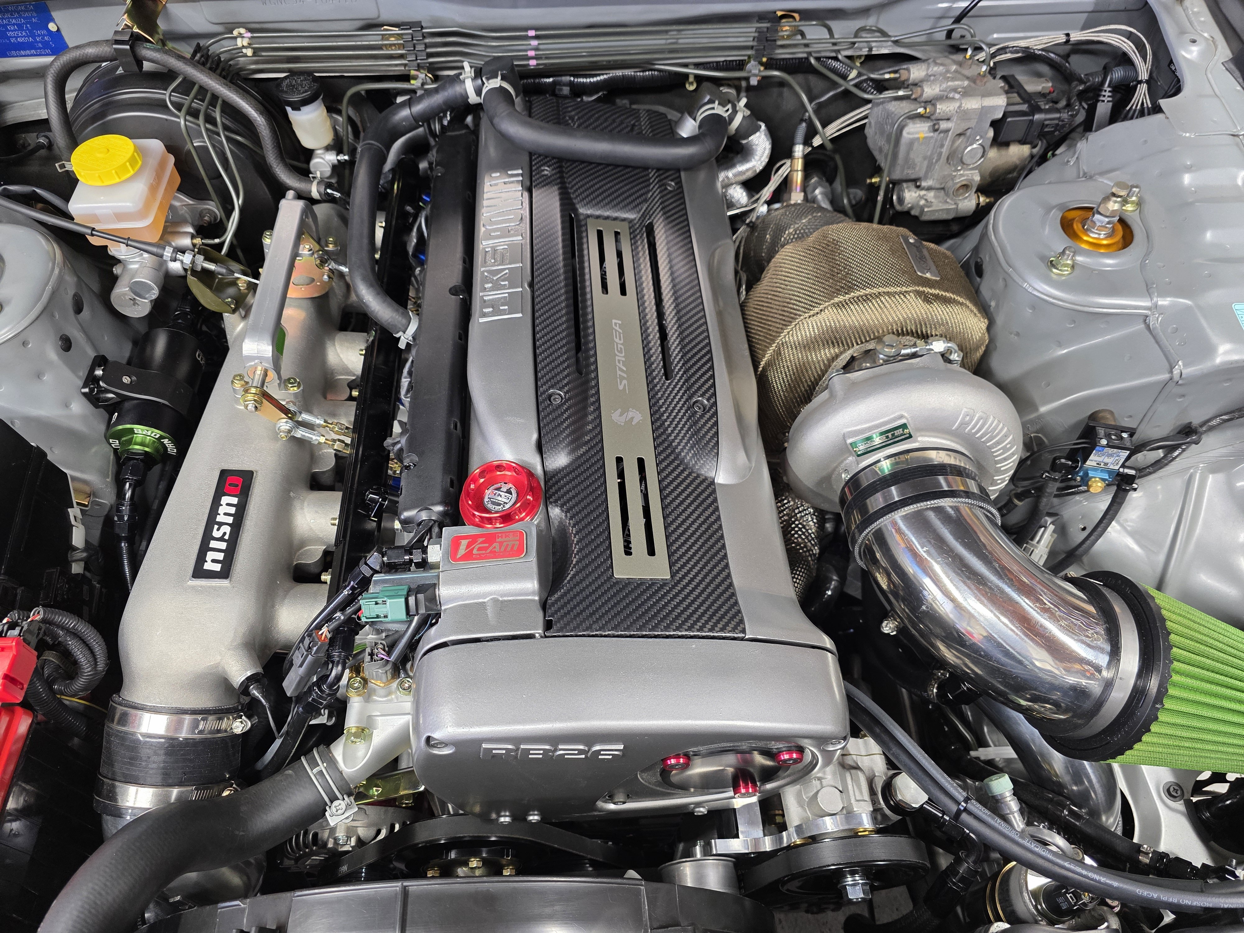

Full Nismo arm set, 2-way LSD set up soft, 322mm Brembo brakes, Ohlins Flag-R coil overs (need to drop the spring rate 1Kg)
-RB swap is under way.
HKS Step 2 High Response 2.8 BCD stroker kit / Step 2 V-Cam / GTIII 4R Kit
I may not use the 4R kit but not sure yet as I've seen some pretty decent dyno sheets on it and it doesn't spool as slow as people think when you have v-cam.
I have the wiring manual for the car and a spare 260RS harness so the wiring shouldn't be that bad but I just haven't had the time to invest in it. If anyone has a suggestion for someone who can handle it let me know!
I have a bunch of spare 5mt swap parts and some Nismo 580 turbos if anyone needs/wants them hit me up. Located in California but willing to ship.
