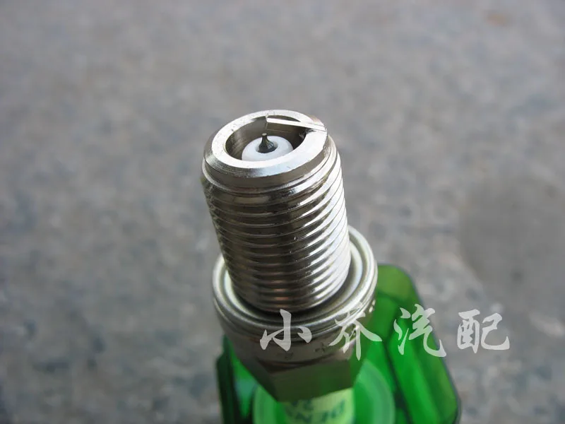

I use Denso IK01-24/NGK R7434-8 as I have R35 coils
RB26 coils use IQ01-24/NGK R7436-8
Sparkplugs/Coilpacks - 600kw - Forced Induction Performance - SAU Community
they are platinum iridium and make an excellent spark and last a long time as the ground strap is pure platinum
can be had for reasonable money from rhdjapan. they're VERY expensive in australia.

Only plug to use on a 500kw onwards RB mainly because of the Platinum ground electrode, as all other plugs can grenade the nickel ground electrode right off with any detonation quite easily.

The R7434 and R7436 are the same plug except the 36 is a 2.5mm longer overall plug as the insulator 2.5mm longer. The 34 is the BKR length and the 36 is BCPR length, which RB26s use as standard.
I'm still on the 36 because stock is BCPR. I will change to the 34 next time as the 36 tends to jam in hard to the coilpack stalk when used with the full height RB R35 coil pack kits, so the 34 just "fits" a little nicer by comparison.
Sounds good, thanks for the explanation. I'm not on stock height coils, so I doubt 34's would be an option but I'll measure to confirm. Reason I ask is the 36's have been discontinued since the beginning of 2023. NGK has no direct replacement. I just ordered another spare set.
