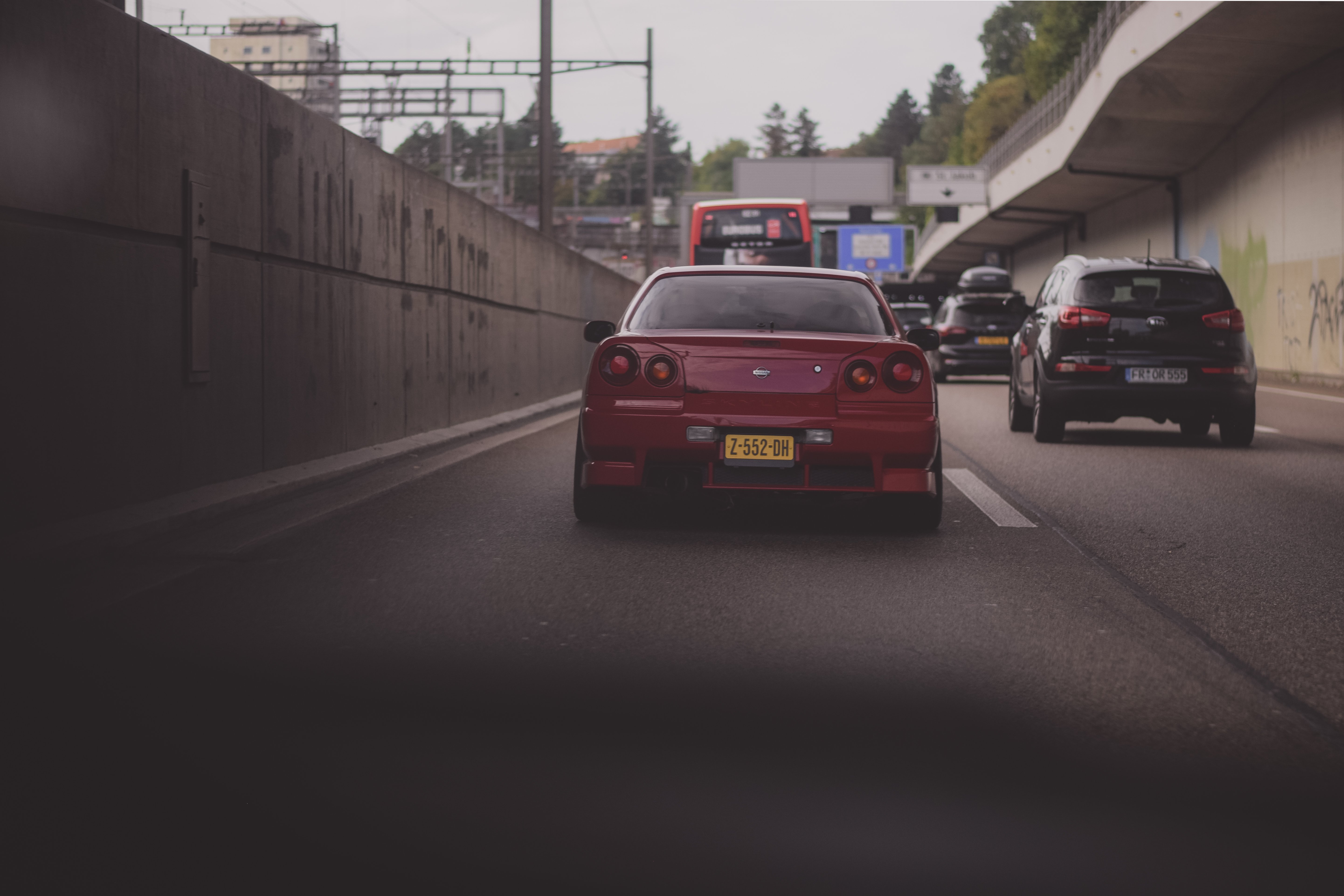

So I raised the car up a fair bit for shipping - see image - then lowered it again when it arrived. I then rushed to get an alignment in NL before the track and the shop just wasn’t anywhere near as precise as what I got in Japan. The guys that did the alignment this week said there was a fair amount of toe in the rear that could have contributed to the understeer. It was also the case that the rear camber went from about -2 to -3 at the shop in NL. However, since I’ve now got slightly wider tires in the rear - NS2Rs run wider than Accelera 651S - I could only get a minimum of -3 in the rear now due to clearance. Front is now -2.75 (-2.45 in minutes) due to being raised a bit (previously -3 in JP). So it’s likely a combination of the two factors, camber and toe. The issue now is I have more camber in the rear than the front and the next step on the front Cusco arms will put me at -3.5ish front which seems a bit excessive to me. The weird thing is I’ve never had any understeer at the track in Japan but they are very different circuits - Japanese circuits are much slower than the one I’ve been to here.

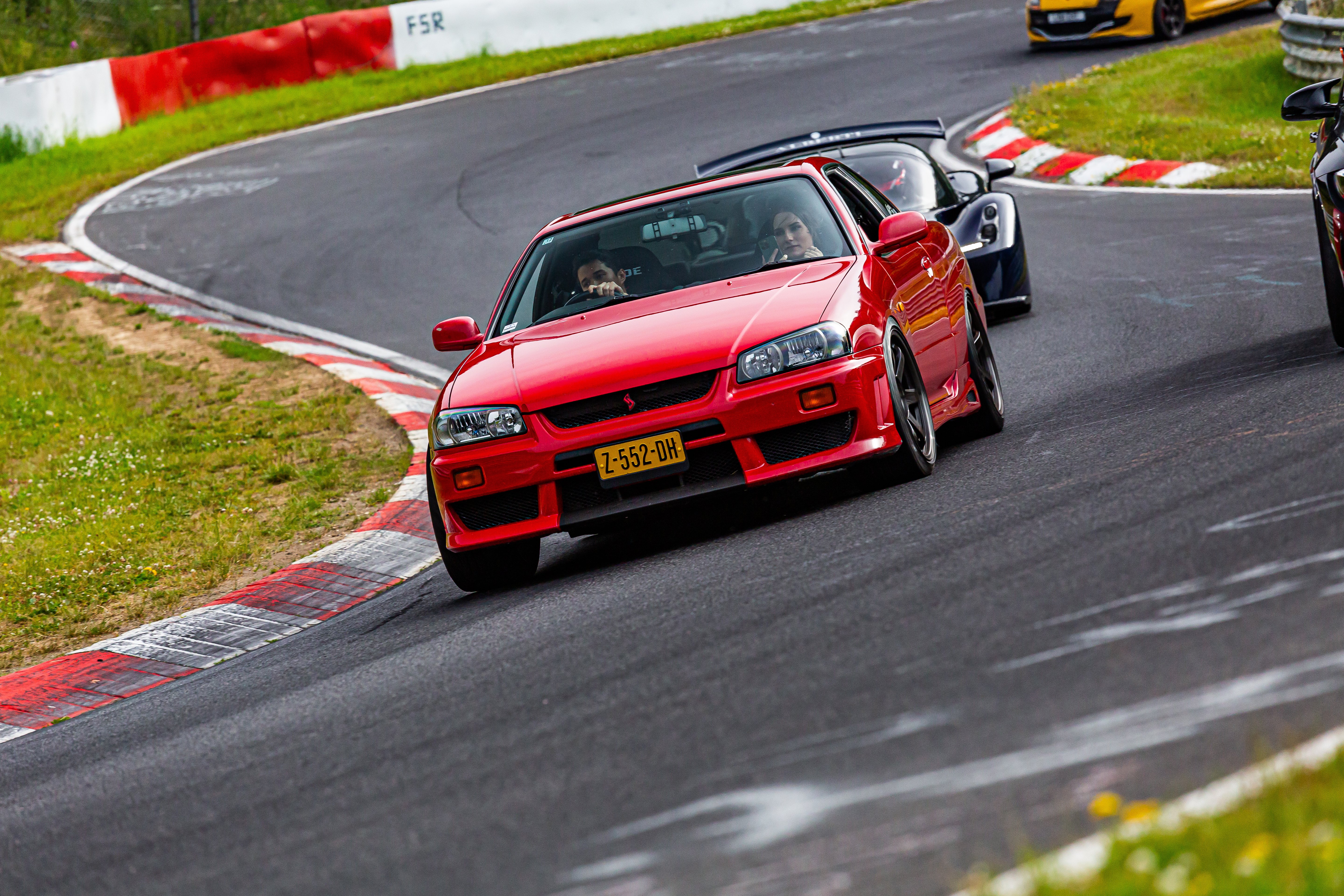

New alignment and matching tires is great and f*ck me are the German roads fast. Took another trip to the Nurburgring yesterday with my buddy and the car feels great in the dry - a lot of mechanical grip. In corners at 140-160kph I felt like I could keep going.
