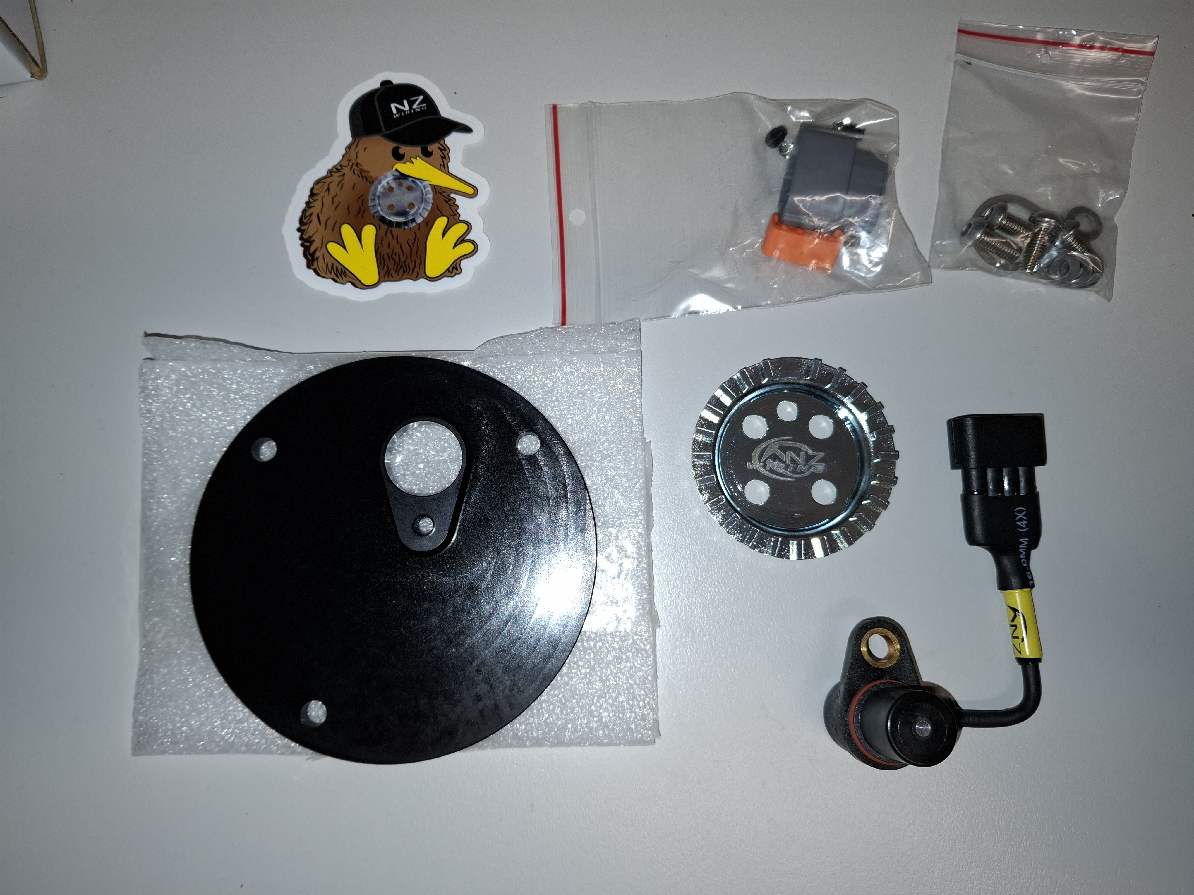

robbo_rb180 Posted March 7 Share Posted March 7 Add these Sensors -Wideband, Oil Pressure, Fuel pressure, Intake air temp Good inspection of ignition system of coils, plugs and loom (12v feed and good ground)- a r35 kit is best bang for buck upgrade. A decent tuner should be able to see any issues with the trigger system- a link has good filtering but a good simple upgrade is the nz wiring bolt in kit. Check and replace all the fuel filters- you would be surprised at intank filter after a few years. Also good to check for any leaks on vac hoses and pipe work as has been said. No need to go overboard and spend big $$$ to enjoy the car. A quality tuner is getting harder to find as anyone with a laptop thinks they are a tuner. A link has great features to check sensor voltages and frequency inputs and easy to see live by pressing f12. The link can do a TPS & RPM fuel/ignition mapping on ITB cars then add a 4D table with MAP and ability to add a 5D to it (can help with economy at cruise with wheel speed vs TPS) Where are you located as that will help narrow down a good tuner ? 1 Link to comment https://www.sau.com.au/forums/topic/486153-r32-update-from-1990s-spec/#findComment-7998295 Share on other sites More sharing options...

robbo_rb180 Posted March 8 Share Posted March 8 45 minutes ago, djr81 said: The plan is to get it out of the shed. The reality may fall some way short. But hope is as cheap as despair as they say. Will go a wide band I think. The coils are ok so maybe I’ll miss the $1500 on the R35 coils etc. Im still on the fence about a trigger kit. The HKS one looks nice ($1k) - not sure how it works with the Link or if Link prefer something else. Oil pressure is fine so I’m not that concerned there. Fuel pressure I’ll have a think about. The IAT got changed for the Link anyway as the old RB26 ones were really slow reacting and pretty poor. The Power FC just worked. Wasn’t terribly refined but it just worked. Probably made a mistake replacing it really. E85 isn’t available locally - it is 100+ kms away which puts it in the too hard basket. Lastly I understand Tunecorp in Perth are pretty good so was probably going there. As for turbos is there are new age -5 drop in replacement? Turbos have come a long way in 20 years, everyone is big single which is fair enough but I prefer the old school complication of twins. Wasn’t chasing more power (well, not much more) but more efficiency would be ok. The NZ wiring kit is a 1/3 the price and will be perfectly fine for your application, I've ran one for 6+ years and many others have. Comes as a full plug into factory connector and the settings for a Link. https://www.nzwiring.com/index.php/product/trigger-kit/ Always comes back to the tuners knowledge and experience with a tuning platform. It takes years to become proficient and learning all aspects and capabilities. I've been using Links for 16 years now (rb and sr paltforms) and always learning something new with adding tables, diagnostics and data logging. Stay 98 for the usability and keep it simple so you can enjoy the car more. With experience I'll give you a current example of the industry I am in. They use Motec m190 and only use VE tuning when they have a torque mapping available and would solve the "PARITY" issues that plagues the category all because the muppet doing the tuning doesn't understand the platform or want to learn it and the product seller have no idea on its full capabilities ( I had a good laugh as when firing up an older car that just got completed and they didn't understand the injector scaling or how to change it for different fuel being used) 1 Link to comment https://www.sau.com.au/forums/topic/486153-r32-update-from-1990s-spec/#findComment-7998307 Share on other sites More sharing options...
MBS206 Posted March 8 Share Posted March 8 6 minutes ago, robbo_rb180 said: The NZ wiring kit is a 1/3 the price and will be perfectly fine for your application, I've ran one for 6+ years and many others have. Comes as a full plug into factory connector and the settings for a Link. https://www.nzwiring.com/index.php/product/trigger-kit/ Always comes back to the tuners knowledge and experience with a tuning platform. It takes years to become proficient and learning all aspects and capabilities. I've been using Links for 16 years now (rb and sr paltforms) and always learning something new with adding tables, diagnostics and data logging. Stay 98 for the usability and keep it simple so you can enjoy the car more. With experience I'll give you a current example of the industry I am in. They use Motec m190 and only use VE tuning when they have a torque mapping available and would solve the "PARITY" issues that plagues the category all because the muppet doing the tuning doesn't understand the platform or want to learn it and the product seller have no idea on its full capabilities ( I had a good laugh as when firing up an older car that just got completed and they didn't understand the injector scaling or how to change it for different fuel being used) On a 400hp RB, what benefits other than "it's not 30+ years old" are you seeing from the NZ Wiring Kit trigger setup? If it were me going to change triggering, my belief would be to go for a crank trigger to remove the issues caused by what people claim is belt stretch etc, but that's from my understanding a much larger issue for super high power, rather than those in the 400hp and below club. Link to comment https://www.sau.com.au/forums/topic/486153-r32-update-from-1990s-spec/#findComment-7998308 Share on other sites More sharing options...
robbo_rb180 Posted March 8 Share Posted March 8 Cleaner signal so timing is more accurate at all rpm also found it to start more on first rotation but could also be I've nailed prime and crank fuel. For under $400 and 30mins of your time, its a good solution especially once the optical sensor does start to play up you won't notice it until in higher rpm and it heat soaks. Link to comment https://www.sau.com.au/forums/topic/486153-r32-update-from-1990s-spec/#findComment-7998309 Share on other sites More sharing options...
Dose Pipe Sutututu Posted March 8 Share Posted March 8 33 minutes ago, MBS206 said: what benefits other than "it's not 30+ years old" are you seeing from the NZ Wiring Kit trigger setup? When you track RPM vs time it's clean, unlike the OEM one, even with filtering there are ripples. Means no random misfires or triggering issues at higher RPM, especially if you have big lift cams and a noisier valve train due to heavier springs. Link to comment https://www.sau.com.au/forums/topic/486153-r32-update-from-1990s-spec/#findComment-7998311 Share on other sites More sharing options...
MBS206 Posted March 8 Share Posted March 8 Interesting. I've not dived into the cleanliness of the factory CAS. I'm curious if the variations are less of an issue if the OEM sensor were brand new. Optical sensors if they're starting to get dirt and crap into them as they're getting older would definitely cause issues as they age. It's an interesting point to keep in the back of mind for me though Link to comment https://www.sau.com.au/forums/topic/486153-r32-update-from-1990s-spec/#findComment-7998322 Share on other sites More sharing options...
GTSBoy Posted March 8 Share Posted March 8 5 hours ago, MBS206 said: Interesting. I've not dived into the cleanliness of the factory CAS. It's pretty filthy. 5 hours ago, MBS206 said: I'm curious if the variations are less of an issue if the OEM sensor were brand new. Same same. ie, fithy. The stock ECU has an amazingly good filter on the CAS signal. 2 Link to comment https://www.sau.com.au/forums/topic/486153-r32-update-from-1990s-spec/#findComment-7998332 Share on other sites More sharing options...
