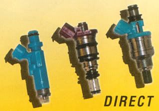

Help me out here Ian, this is a picture of the three types of RB injectors. The one on the left is the R34 GTT injector style, the one in the middle is the R33 GTST injector style and the one on the right is the RB20/26 injector style.
Is there a fitting kit you can buy that let's you fit the RB20/26 style of injector into an RB25 Neo? If so what brand, how much and where do you get it?
