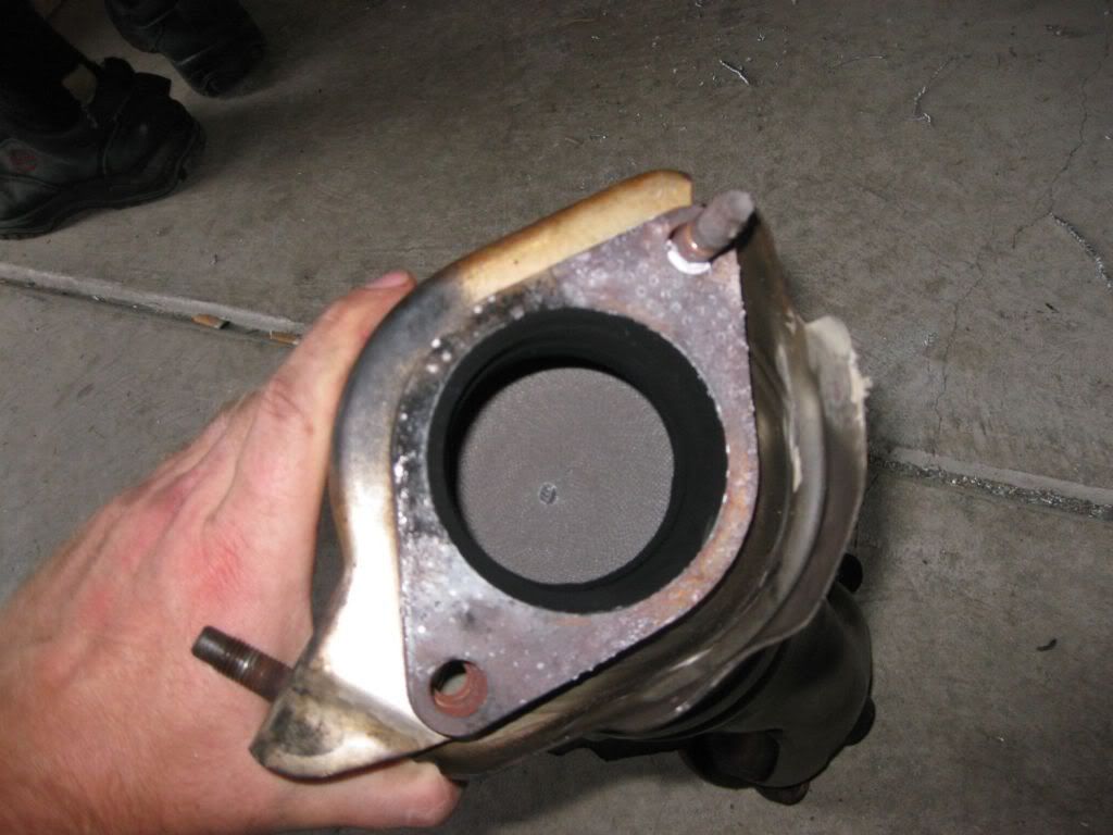

Even if you don't touch the rest of your exhaust, change the dump pipe.
Certainly the biggest power boost when you do this. There is a massive cat in the middle of the stock dump that is soo restrictive.
On my car with the stock turbo I have seen 20psi when I did the bypass. Not for long as I don't thing the ceramic turbine will be happy for long even with a ball bearing core.
Cat in the stock dump is too restrictive?
Oh, you must be referring to this then :)
Yes Dunc. Change your sump pipe ASAP!
Either get in on the group buy unit or preferrably, talk to Scotty about one of his dump/front pipe units :happy:
+ 1 million! :happy:
I can vouch for the difference it makes even with a standard exhaust. Spools up faster, accelerates harder, more responsive, nicer engine note, slightly better fuel economy, need any more reasons? :)
