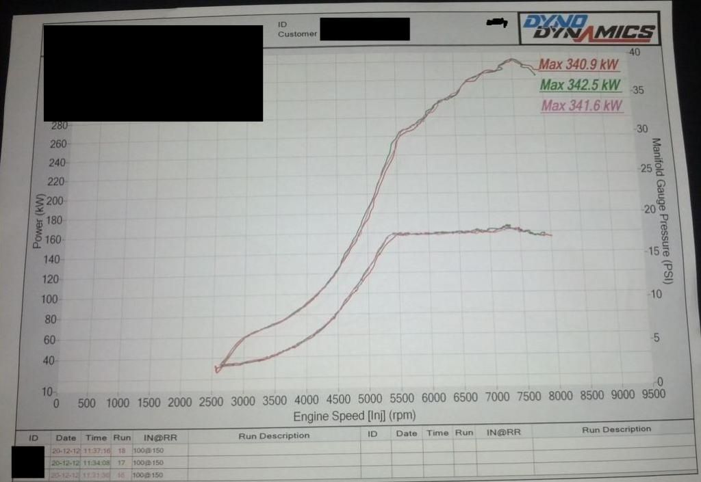

Last run: 0awkw or near enough to it....
Hoping for something closer to 400kw@wheels once its rebuilt and run in: hopefully by around Feb 2013, assuming we don't all cease to exist on Friday... ;)
Prior to this, it was running 298awkw

Looking forward to hearing how you all go with your setup. I'm getting pretty close now. The safe/low boost tune was just completed and the numbers are looking pretty impressive on pulp. This tune hasn't had any timing or other things added as yet, we had to stop though as my gearbox let go in 3rd gear and will resume tuning low and high boost for pulp/e85 in the new year.

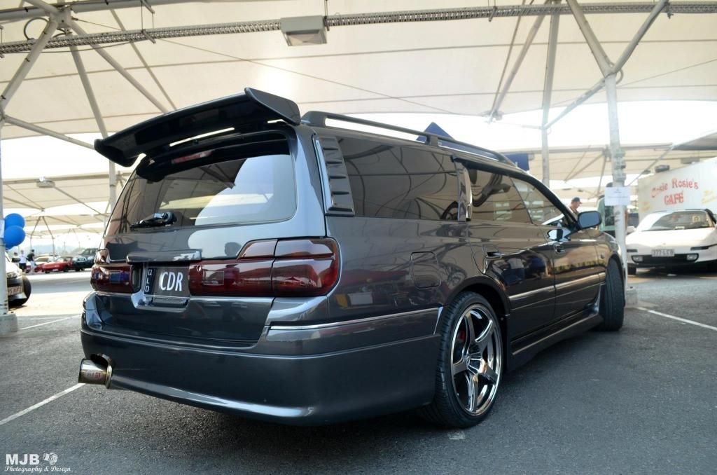

My lousy Stagea atm, changing the rear housing to a smaller unit and going to pump the boost up higher. (only running 14psi)
specs:
Return flow cooler
3 inch exhaust
Kando TD06 12cm rear (going to a 10)
external gate
Haltech E11V2
RWD

Nissan Stagea 1996 AWD
Stock RB30 block apart from new rings, bearings, big end bolts, Tomei sump baffle kit N1 oil pump. Stock R33 head cleaned up, VCT connected, Tomei head gasket and adjustable ex cam gear. Sinco Customs exhaust manifold, GT3540R turbo with .63 ex, Synapse 50mm W/G, Venom 5in 100 cell cat, 3in exhaust with straight through resonator and cannon. Hybrid FMIC, Greddy copy FFP, HKS Sequential BOV, Deatschwerks 550 injectors, stock throttle body, fpr and rail. Walbro in tank fuel pump and Bosch 044 from surge tank. Link G4 ecu. 98 Pump fuel.
Plan to install some better plugs, fine tune W/G and retune for a few more KW but will probably leave it at that as I don't want to push too hard on a stock unbalanced bottom end.
Credits: Joe (Joes Mechanical) Glenn (GDS motorsport) and Soichi (ST Hi-Tec).
You've got to love a motor that makes 220kw by 4000rpm :) Great result.
Do you run standard cams, and if so are they from the original stagea head?
Stock cams and springs... head was from a S2 R33 engine (so should be same as Stagea). Bottom end is stock (would recommend getting it forged and balanced as you did) so probably won't push it much further but obviously would go harder with bigger cams and better valve springs. Currently limited to 7000 rpm
Great result Bob.
Don't bother with cams unless you plan to rev it harder.
I think you could do so much better with a .82 rear, there are usually drawbacks to running small housings on large turbo's, what is the transient response like? I still miss my 1.06ar Tial.
Great result Bob.
Yep won't be doing cams with unbalanced stock bottom end - 7000 will be it for me. I was going to get a .82 but was talked into the .63 on account of the 1800kg dead weight and although I lose some top end the car does take off in any gear when I floor it so happy with that.
