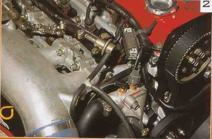

Some info on the RB20 with RB26 inlet as per Zoom Magazine edition 64 and edition 62;
This picture shows the RB26 plenum being test fitted up to the cut and welded RB20 inlet. The throttle bodies go between the RB26 plenum and the modified (shortened) RB20 inlet but are not shown in this photo.
This is a picture of the RB26 plenum, RB26 throttle bodies and RB20 shortened inlet on the RB20.
Using a 120 degree bend at the throttle body reduces the difference in intercooler pipework by more than 50%, to a bit less than 1 litre using 75 mm pipework.
To work out the throttle response difference the calculations are easy;
2500 cc X 5000 rpm / 2 (4 stroke) at 1.3 bar = 135 litres per second
So a saving of 1 litre represents less than 0.005 of a second
That's not a lot of lag to save with reduced pipework.
So using an RB26 plenum and throttle bodies on anything other than an RB26 is not a good idea in my opinion. Especially when you consider the potential to loose throttle response due to poor airflow distribution is far greater than any minute shortening of the inlet pipework.
My 20 cents worth:cheers:
