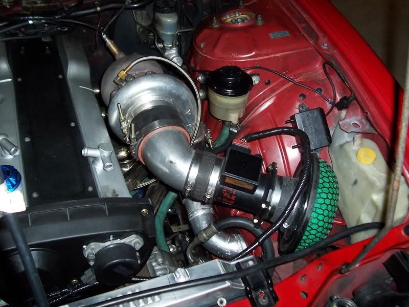

please pardon my ignorance, but i have been dealing with an issue with my car and came here for a possible solution to my problem. ok the car is a 95 S14 with an RB25DET NEO out of an R34. the following mods have been performed. greddy plenum, Q45 90mm T/B, 650cc injectors, T67 turbo,greddy 50mm racegate, turbular manifold..the unit has been tuned and car runs fine until i let my foot off the gas. even while cruising and not in boost, if i let off the gas she will stall. i can catch it with my foot by hitting the gas pedal but if i dont modulate the gas it will still try to stall out on me. is there a correction for this that i am not aware of. i know there is a datalogit software i can get which my car was tuned with here in the states but the tuner had little luck with solving this concern.perhaps its not something he is ccomfortable doing, i dunno. but he had no problem with taking my money to tune my car for a wide open tune which works great....would the datalogit software have the ability to tune the decell which could be my issue.

this is usually caused by modifying the intake piping
how is the afm setup and what piping setup do you have to the compressor snout?
when you replace the standard rubber item its a common problem as the rubber std item has fins to basically disrupt the airflow
when you replace it with say steel piping or some form of ducting when you come off the throttle the afm signal gets busted up
so i would first check your afm piping and if you can try running with the afm open mouthed, see if that affects the problem
that is - undo any ducting pipe work to the AFM
this is what i am currently using on my car
well as it turns out i wanted to try to add a litle length to the intake like you auggested and to my amazement that did the trick. you sir are one baddass mofo and i thank you so very much for that tasty bit of knowledge. i only hope i dont have to get the car retuned because of it. i did notice a signifigant difference in my wideband readings which are now richer...
