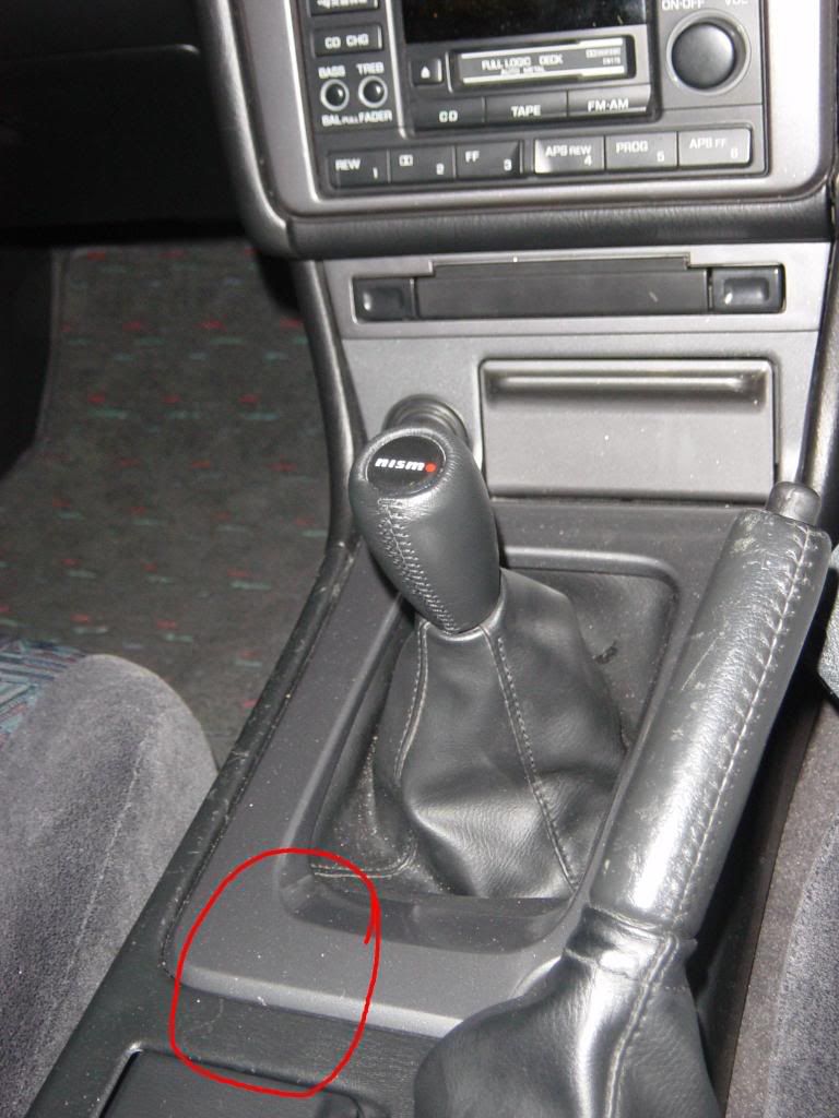

I also needed a 32mm (1 1/4") hole bit to cut out for the master cylinder. the hole is already cut into the acoustic padding, and there is a cast circle for where the hole goes. nissan did everything for this manual except put the bloody thing in the series 1...
terminal would you say that the conversion so far has been easy?
As in not too difficult for someone to do at home up to a point and then get a workshop with a hoist to put the box in. (Unless you are lucky enough to have a hoist) I would like to do this myself but want to make sure I am not in over my head
yeah getting the part in is pretty easy. the handbrake was pretty simple to change, then installing the centre console is a breeze. i'll have to take it out when the gearbox goes in but apart from that it was easy. the clutch pedal needs a bit of mucking around, but i don't think it'll be too hard to finish on stands. the brake pedal needs to be changed, which means removing and replacing the pedal with a thinner manual one. apart from that there's not much else i can do, i;m getting it installed at a mechanics as i don't have the time to do it, and i don't want to wreck the car trying to do it.
