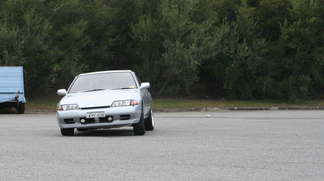

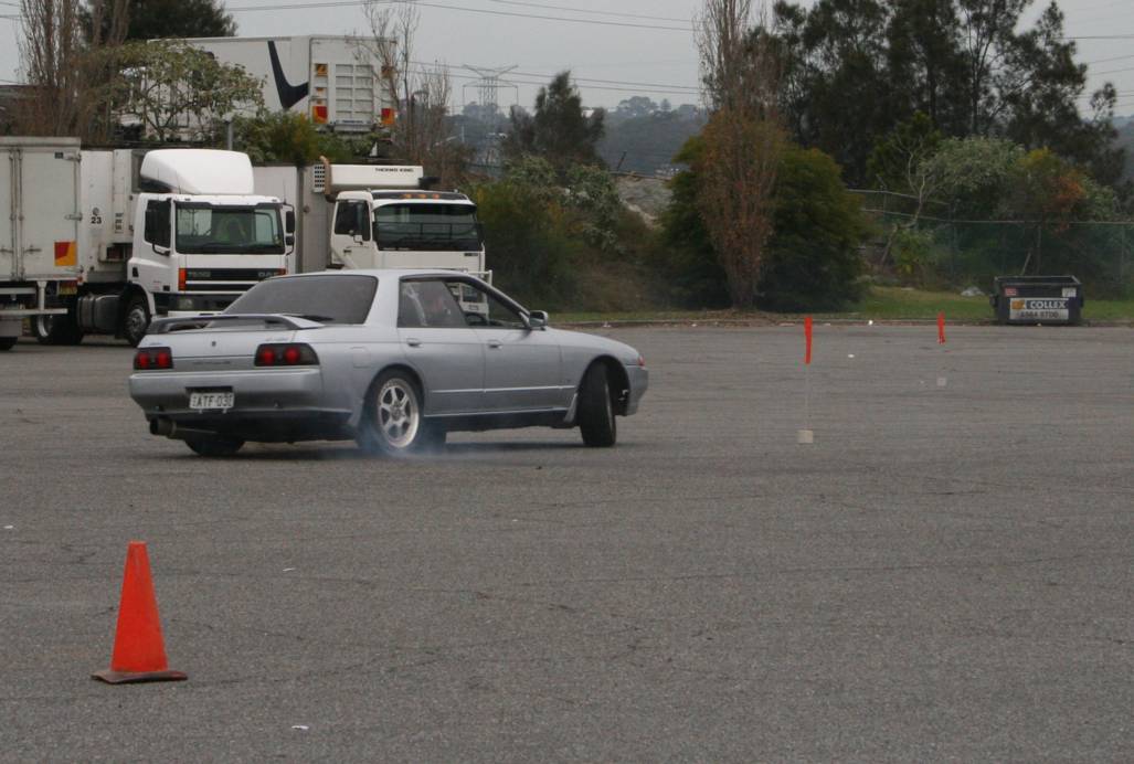

However, after I went in a motorkhana on the weekend (first time I have thrown the car around in a sliding fashion) I think maybe I need to look at a better suspension setup aswell.
Here are some pics
http://ribfeast.no-ip.com/mgmotorkhana05/skyline_1.jpg
http://ribfeast.no-ip.com/mgmotorkhana05/skyline_2.jpg
http://ribfeast.no-ip.com/mgmotorkhana05/skyline_3.jpg
Now, I am pretty strapped for cash, and I am NOT interested in throwing lots and lots of money at my car for stuff that I don't really need. BUT...
With that much roll (keep in mind that I was in no higher than 2nd gear, so it's not like I was going fast) should I be looking at a better setup? If so what? Do I just get some decent springs, or do I need to go for coilovers or something. I am 100% NOT willing to spend over $2000. And I am a bit "meh" about spending more than $1000 really. I had planned the castor/camber fix to be up to $1000, so if I was able to kill 2 birds with 1 stone, then maybe we can find a comprimise.
