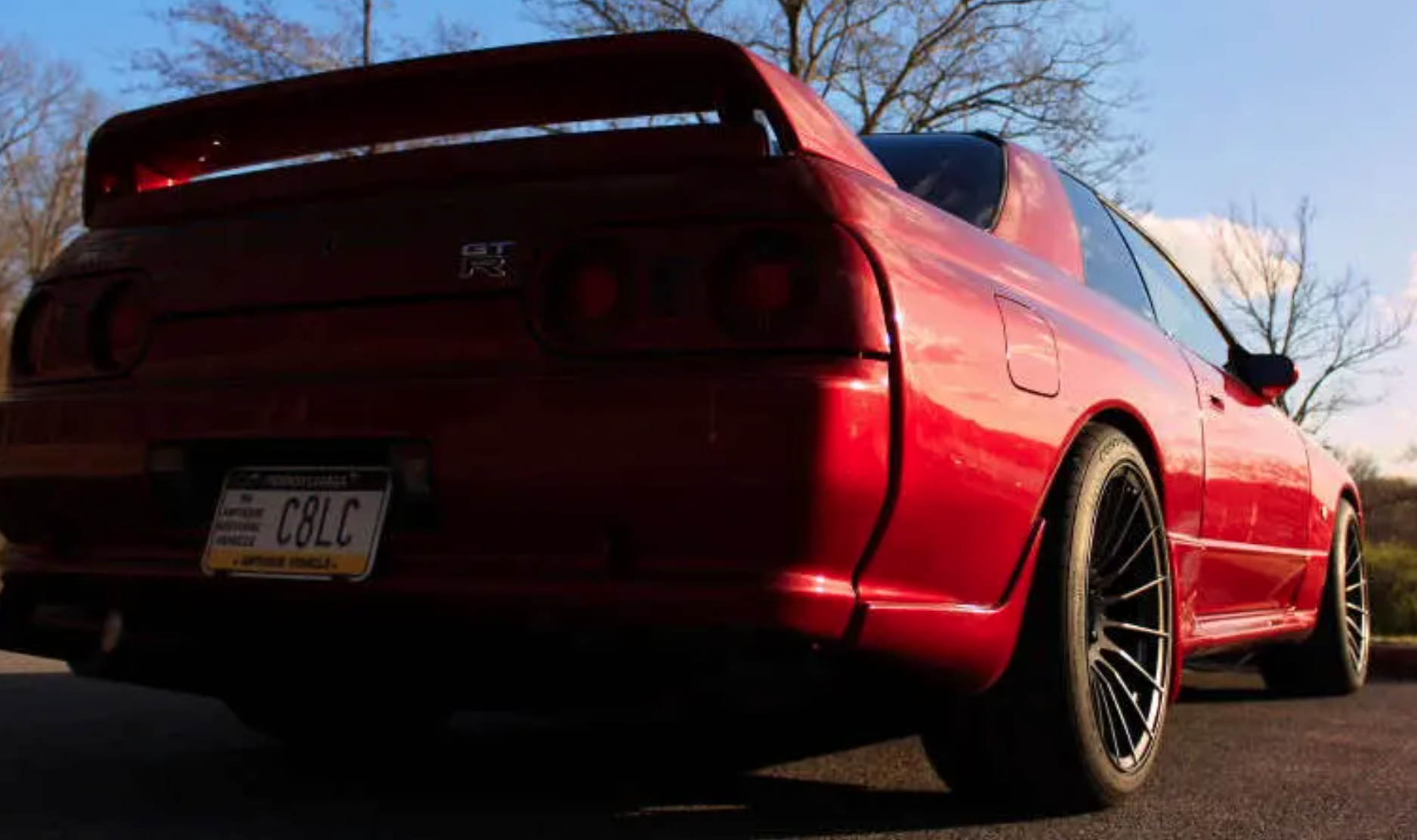

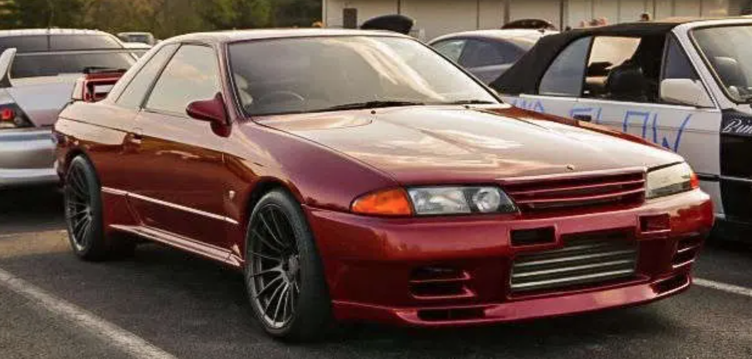

Akira32 Posted August 11, 2024 Share Posted August 11, 2024 Anyone know if this will fit without modifications for a R32 GTR? Work S13P [F] 18x9.5 +24 O-disk [R] 18x9.5 +24 O-disk Link to comment https://www.sau.com.au/forums/topic/84208-wheel-sizes-offsets-for-skylines/page/191/#findComment-7992097 Share on other sites More sharing options...
wardiz Posted August 11, 2024 Share Posted August 11, 2024 +22 fits very well so +24 should fit as well. What's O-disk ? Link to comment https://www.sau.com.au/forums/topic/84208-wheel-sizes-offsets-for-skylines/page/191/#findComment-7992104 Share on other sites More sharing options...
Akira32 Posted August 12, 2024 Share Posted August 12, 2024 4 hours ago, wardiz said: What's O-disk ? It’s just the brake clearance specs for work wheels. Disk Type: ・A disk - Standard brake clearance ・O disk - Small brake clearance with deep rim ・L disk - Big caliper brake clearance ・R disk - Big caliper brake clearance I’ve since found out that for R32 GTR you’ll need R-Disk to clear front brakes without spacers and rear can be O, A, or R disk. Link to comment https://www.sau.com.au/forums/topic/84208-wheel-sizes-offsets-for-skylines/page/191/#findComment-7992112 Share on other sites More sharing options...
PranK Posted August 12, 2024 Share Posted August 12, 2024 1 hour ago, Akira32 said: It’s just the brake clearance specs for work wheels. Disk Type: ・A disk - Standard brake clearance ・O disk - Small brake clearance with deep rim ・L disk - Big caliper brake clearance ・R disk - Big caliper brake clearance I’ve since found out that for R32 GTR you’ll need R-Disk to clear front brakes without spacers and rear can be O, A, or R disk. How much will they foul by? Link to comment https://www.sau.com.au/forums/topic/84208-wheel-sizes-offsets-for-skylines/page/191/#findComment-7992117 Share on other sites More sharing options...
Akira32 Posted August 12, 2024 Share Posted August 12, 2024 19 hours ago, PranK said: How much will they foul by? Sorry PranK what does that mean! This is the first time I’m buying aftermarket wheels so I’m learning all the new terminology on the go haha Link to comment https://www.sau.com.au/forums/topic/84208-wheel-sizes-offsets-for-skylines/page/191/#findComment-7992140 Share on other sites More sharing options...
GTSBoy Posted August 12, 2024 Share Posted August 12, 2024 He means, "How much negative clearance is there between the back side of the wheel disc (or spokes) and the outer face of the brake caliper?" Brake calipers can foul by being too large a diameter for the inside of the barrel, or they can hit the back of the disc area. People often ignore the latter possibility. Link to comment https://www.sau.com.au/forums/topic/84208-wheel-sizes-offsets-for-skylines/page/191/#findComment-7992141 Share on other sites More sharing options...
PranK Posted August 13, 2024 Share Posted August 13, 2024 2 hours ago, GTSBoy said: He means, "How much negative clearance is there between the back side of the wheel disc (or spokes) and the outer face of the brake caliper?" Brake calipers can foul by being too large a diameter for the inside of the barrel, or they can hit the back of the disc area. People often ignore the latter possibility. What he said ^ Link to comment https://www.sau.com.au/forums/topic/84208-wheel-sizes-offsets-for-skylines/page/191/#findComment-7992143 Share on other sites More sharing options...
