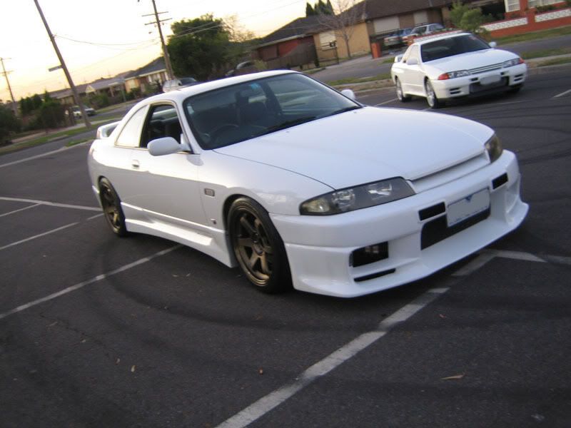

Hey Dezz, i finished mine a few weeks ago and i have it set at 340/330mm. I will post a pic tonight for you.
Thanks, Mike.
Thanks, Mike.
thanks heaps mate that'd be great!
What size rims do you have?
looks awesome mate. You're making me want to sell my rims and get some TE37's right now!
Do you have any rubbing issues with those offsets, at that ride height?
Anyone able to explain how to move the circlips into another groove?
yeh i had to get my guards lipped/rolled but thats about it.
To move the circlip grooves, you will need a pair of circlip pliers to make it easy. you might be able to flick the circlip down by using a screwdriver or two but it will be a pain in the ass. much easier just using the proper tool.

He tells me he had to have the height re adjusted after getting it wrong the first time, so you'd assume he got it right the second time...and the photo of his car above do seem to sit lower than most, and very even...
