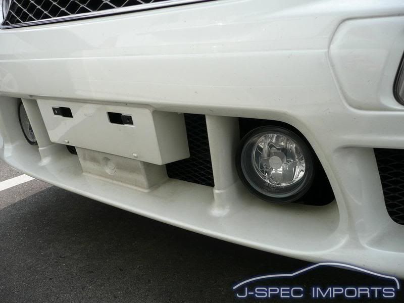

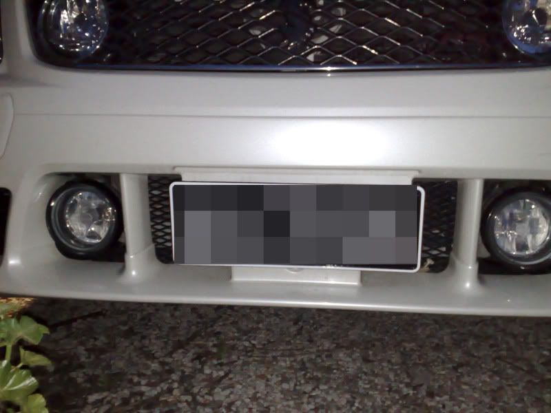

The strange thing is this is a URAS front bumper (or clone of it). The bumper actually does not sit flush with the GTT hood - You need the addon to make the hood 'long' enough to reach the bumper. I have no idea why they didn't incorporate this piece into the bumper itself.. instead of sticking it to the hood instead.
Another thought on this OLD topic: When you paint your bonnet lip, leave a small unpainted back lip/line along the back of the lip, where it rests on the bumper. That way, the line in the back is much more prominent than the gaps in the front/under the lip - and it breaks the hood-to-bumper connection at the "correct" place, when comparing to a GTR. I'm gonna do this with mine this week, so stay tuned for pics!
