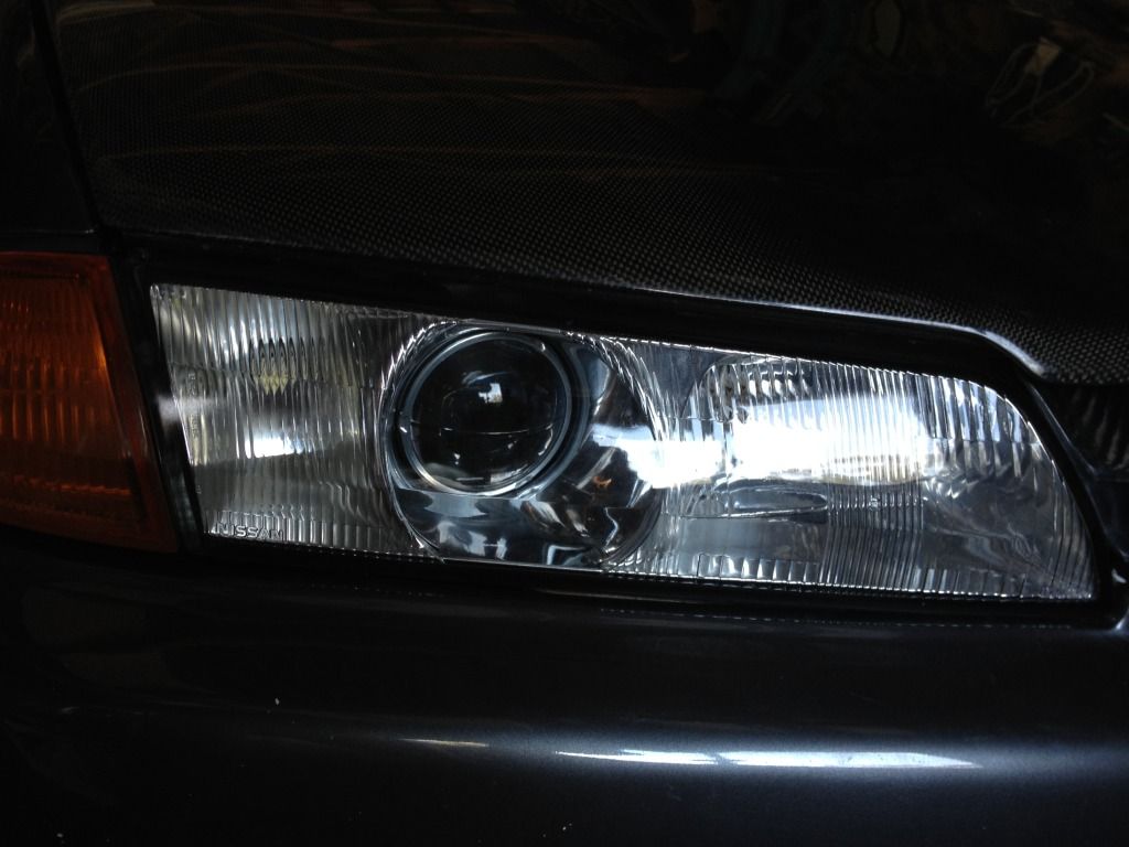

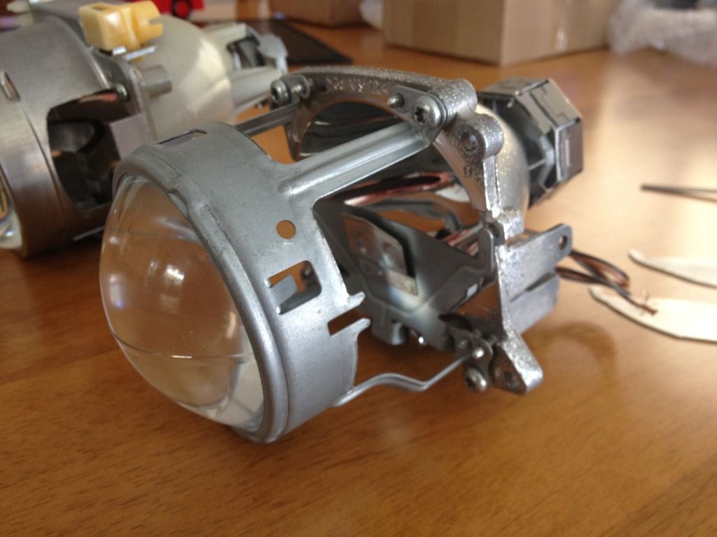

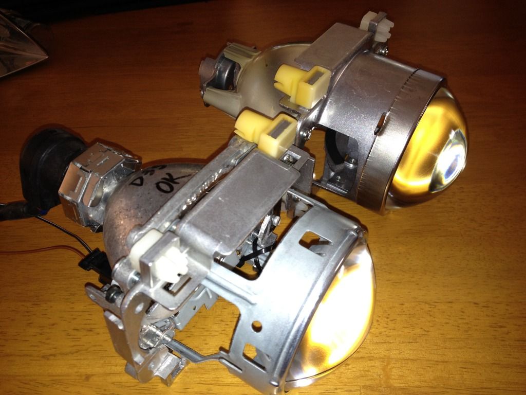

Ok, so finally got around to doing the my Bi-xenon install... Here are some pics of how I went about it. As mentioned above this is one of the lastest versions of the E46 projector, and is common to late model Audis. This is the projector:
Edited by Ryno

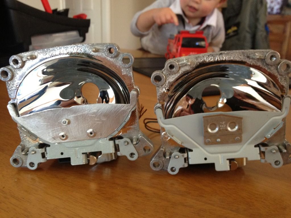

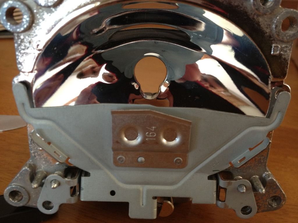

As I purchased it from the US, the sheilds suit LHD - see below:

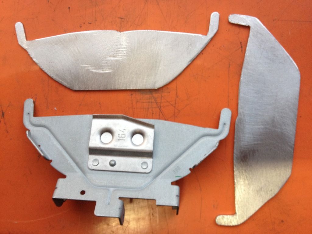

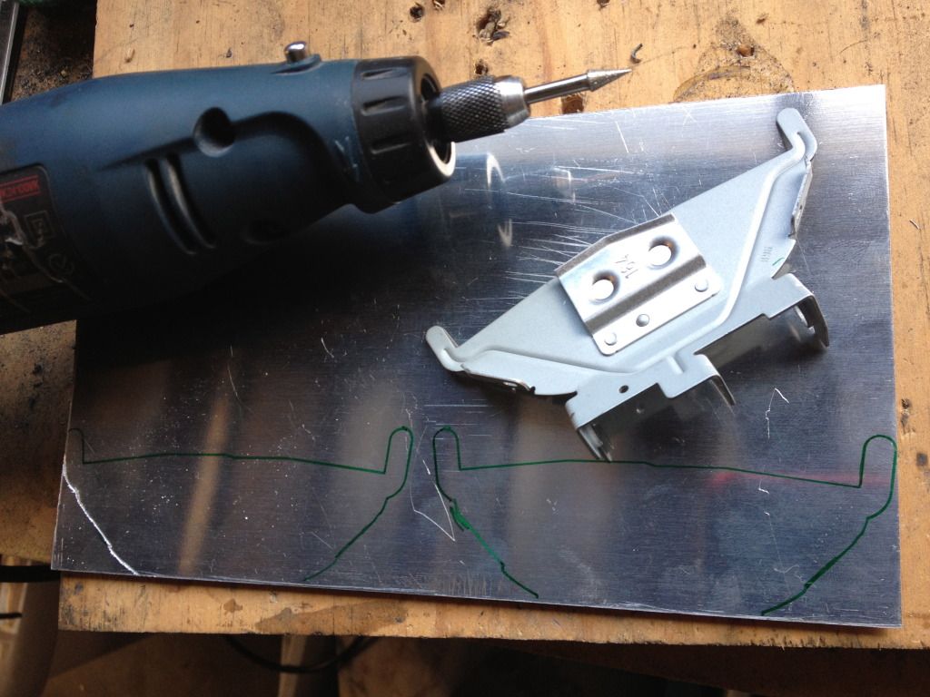

Fortunately this model of projector is relatively easy to modify to suit RHD, but you have to be handy with a die grinder and have a fair amount of patience.
To do the mod, firstly I removed a shield, traced it onto a thin sheet of alloy and cut out two copies of it with a die grinder.
Edited by Ryno

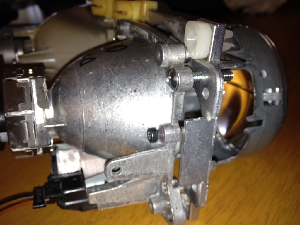

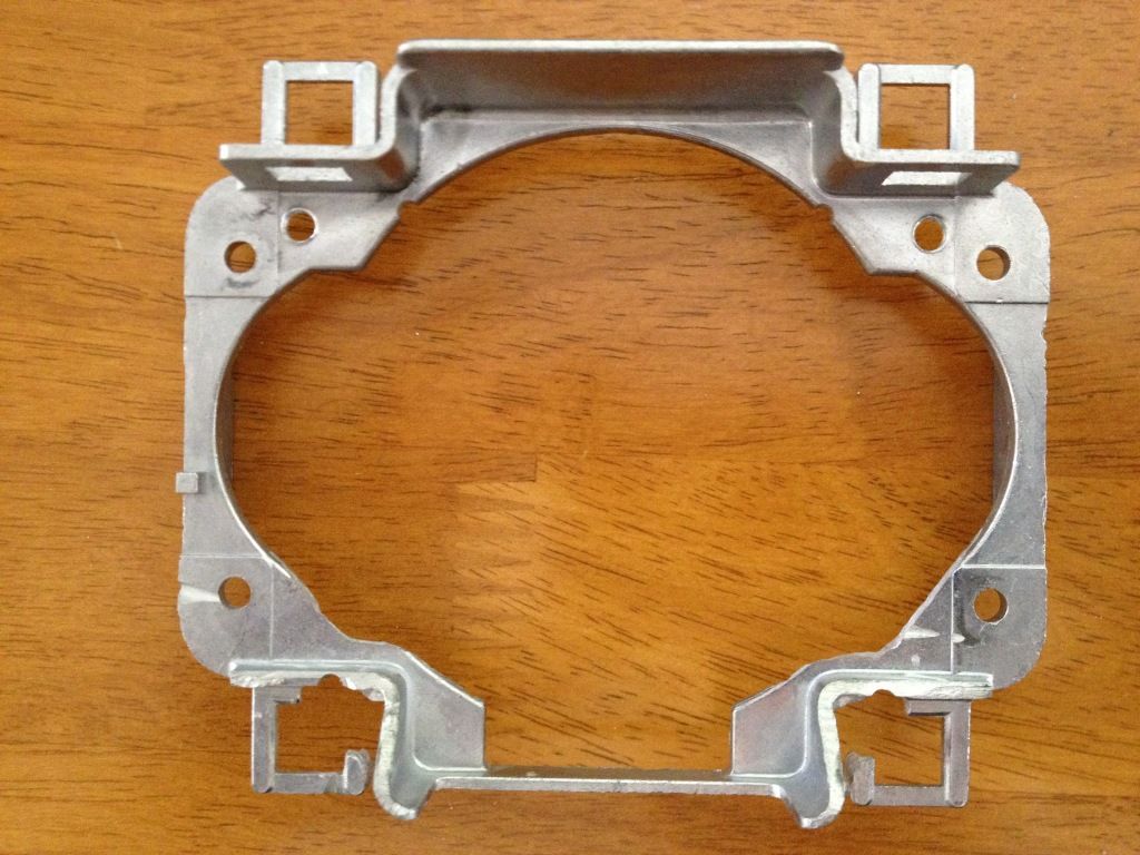

If you look closely at the image above I have tapped two holes near the top - which enabled me to screw the new projector to this bracket (in the reverse orientation).
If you compare the modified projector with the stock one below, you will see that the projector is positioned forward of the bracket almost the exact same amount as stock, and as such it fits into the headlight, without any modification to the stock headlight surround.
The below image shows how I've screwed the projector to the new bracket:
