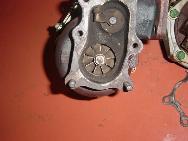

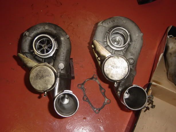

Well, we're just over half way through it and will finish it tomorrow, but the old turbo was well and truly fu*%ed.
Here's some shots for proof...
The old turbo and the replacement (from the Compressor/Inlet side):
My old turbo's compressor housing - notice anything missing?:
The replacement turbo's compressor housing (and wheel):
The old turbo and the replacement (from the Turbine/Exhaust side):

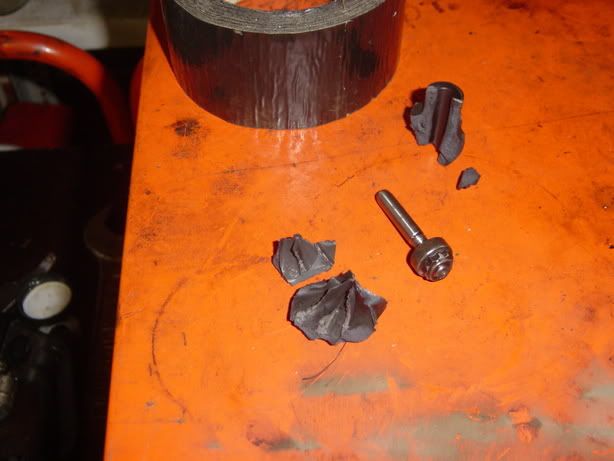

The stuffed turbine wheel:
compared to a good turbine wheel:
And, finally, the remains of the compressor wheel and the sheared shaft:
Alex, some of the compressor wheel was still sitting in the compressor housing, and the rest must be in the intercooler. I'll most likely take it off tomorrow while it's all apart and take the bits out, and maybe the first part of the exhaust from the dump pipe too. Oh, and I'm gonna keep the old turbo and get it GCG high-flowed some time in the not-too-distant future. At the same time I'll probably get an FMIC installed and sort out the computer, etc. Sorry dude!
Like I mentioned, the turbo I've used as a replacement has a fair few kilometres on it too, so hopefully it won't end up the same way.
